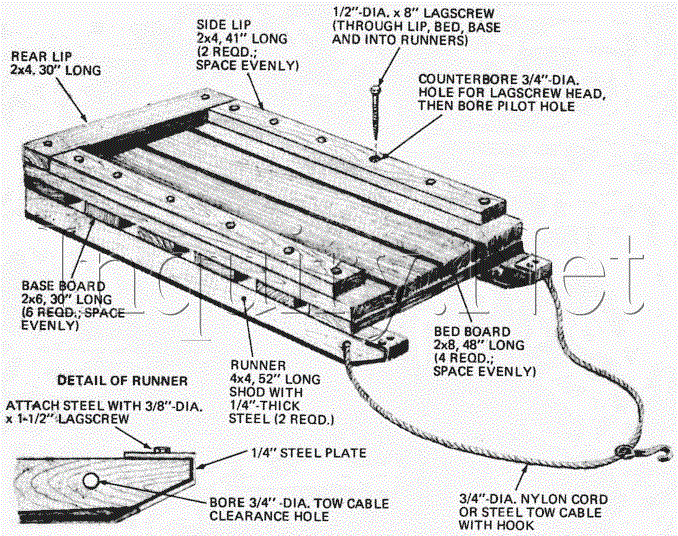

google "stone boat" There are a couple of different plans online. Been around for centuries. You don't think they carried all the rocks in the stone field walls over there by hand do you?

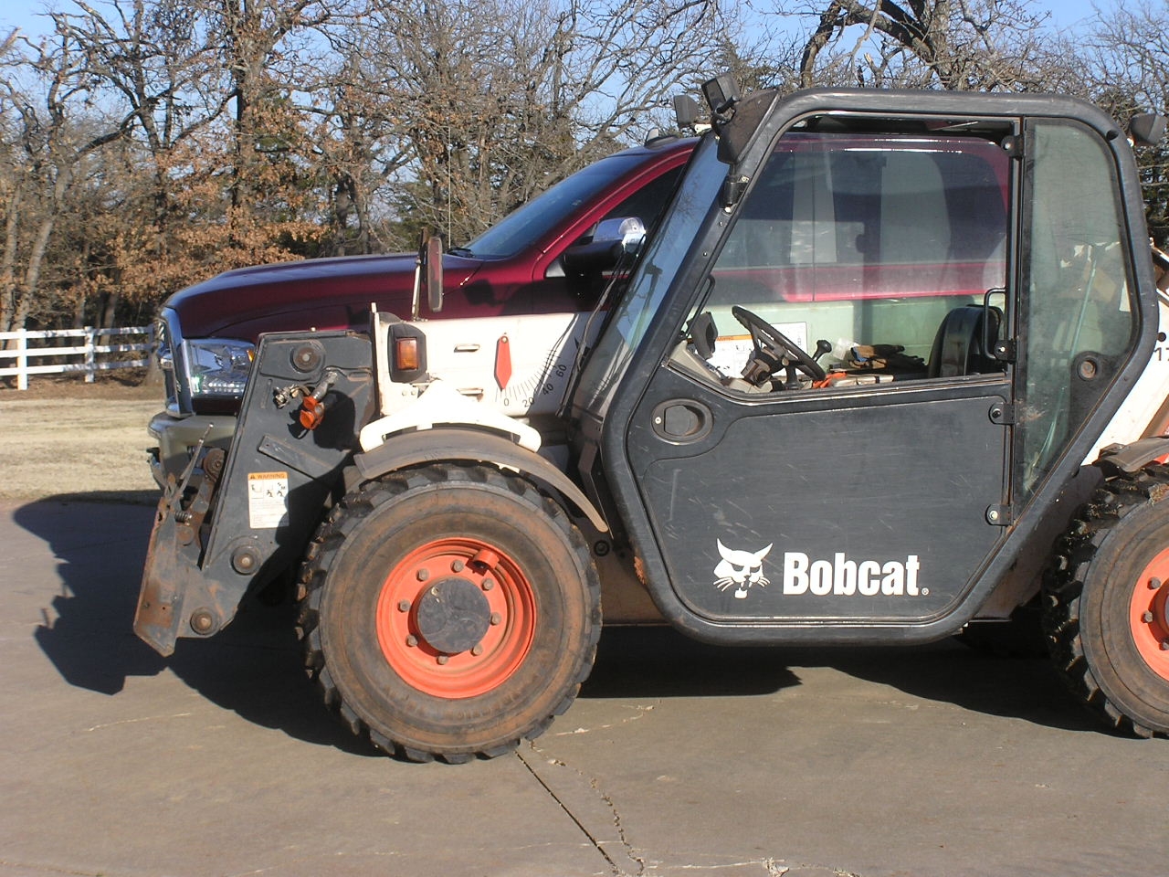

Cross-referencing pics on the web looks like this is a Genie GTH5519 which has a max lift capacity of 5500#, 4400# to max height.
Checking vs yours, looks like this is about the same thing as far as the forks & maneuverability so I suppose it's a compact TH as well.
Yes it is a compact TH, close to the same size as mine, but no SSQA.
I have lifted over 6,000 pounds with mine and pulled some big trees with it:
And the size, it fits in the 83 inch high garage door:

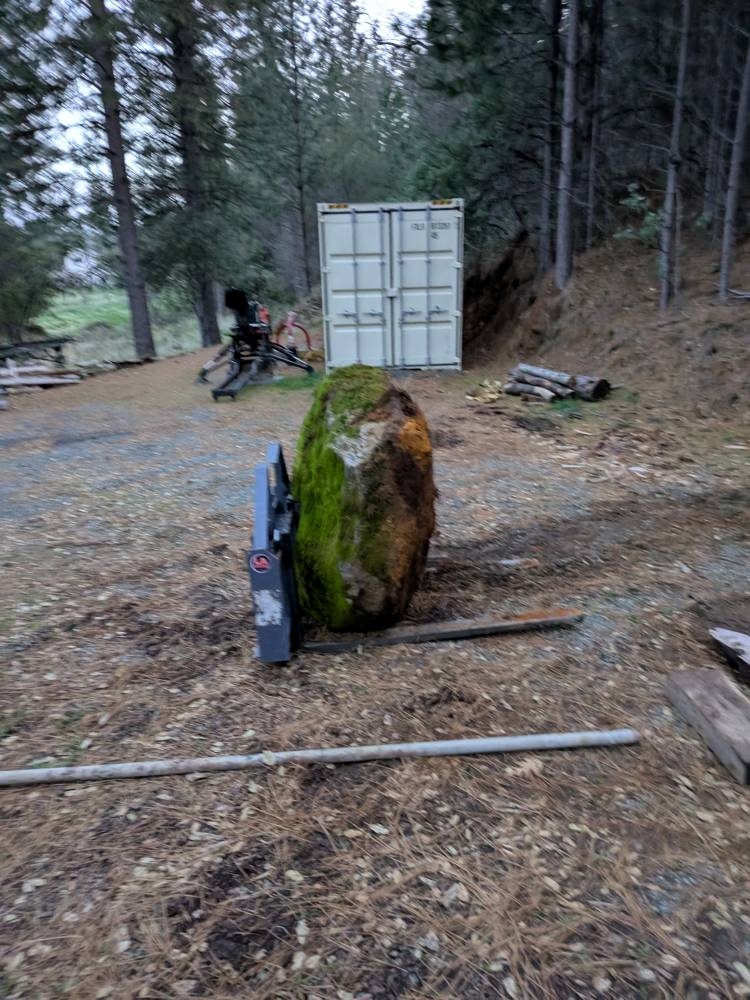

minor update...
I stuck the forks under the rock, wrapped a chain around it and to the forks, and got the rock to stand on the forks.
It was near the end of the forks so despite the fact that it's just too heavy, being way out there was ungainly, so I shoved the rock into a couple poles braced against the hillside to get it closer
The loader clearly didn't want to pick up the rock (+ forks), but I was able to drag it backwards a bit.
Got it to a decent location in my turnaround so that there's room for my truck to pass by it
Very convenient of it to have a flat base to stand on. The eventually position will likely be with the rounded end you see on the side set into the ground in some fashion; the opposite side goes to somewhat of a point which I'd like to have going up towards the sky.
Of course it was still on the forks. I used a heavy wall 1½" x 8' metal pipe as a lever and got a wood block under it to unload one fork blade, and found that the other is actually not on the fork with the rock being on the ground.
I ran out of daylight as I had bird chores to do - twilight is curfew for my chickens, ducks and geese, so the forks are still there.
I'll get them free tomorrow, and then leave the boulder as a monolith/monument until I rent the CTH.
