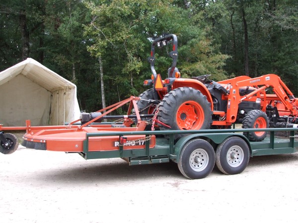

Does anyone think that adding only 12" -18" dovetail would be enough to worry about for the tongue weight? I have a 20ft trailer that I need a little more length to accommodate my brush hog .The trailer has 2/ 7000k and 16 tires so it sits a little higher than most trailers. With 5 ft ramps it is ok on the angle but sometimes I pull cars which I need a better angle for.

Streamin,
I would think that the material used on the deck (on the dovetail) would make some weight difference too. I can't tell if your deck is wooden or steel? What kind of trailer is yours?

the deck is wood, I don't know the brand.It is a small outfit who sells them.

streamin
It looks like a big tex given your location too
Tandem axle 10PI
they have a couple different weight ratings in the pipe top rail ones.
It doesn't look like a 20' deck, looks to be closer to 16'. Are you measuring overall length? Oddly enough, RV trailers measure overall, utility trailers are usually measured by deck.
   / i want to add a dove tail to my 14 ft trailer #26
Tom, you could be right,looks like Big Tex but they may just be a middle man for them cause I ordered it that color and they have their business name on it(the Trailer Man).
Dave, you had me 2nd guessing so I went out and measured.20' ,deck only.
The additional weight should be minimal for the 18" but I also thought about ground clearance in driveways at angles.
I was avoiding a goose neck cause I like to have the bed space.A trade in for anything bigger in a hitch pull would be custom made and another $1000 with my trade loss. I think the dove tail idea would help me enough.
