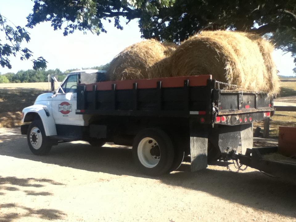

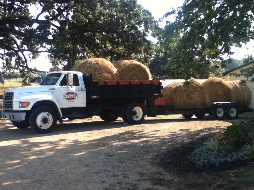

amazincaucasian - If you don't mind, could you share what year your F800 is, mileage, engine, trans, etc?
   / I want to start a small excavation business...need advice!! #33
Yes sir it's a 1995 with a 5.9 Cummins 12valve turbo with about 230,000 miles. Has an Allison AT545 (4 speed automatic). If you bang the breaks, it downshifts nice. You can downshift it like a manual too. Not sure exactly what it gets on fuel mileage, but it's really good. Course not quite as good as a pickup with the same motor, but pretty dang good. It's a little gear-bound, but it has to be cause the motor's a little small for the truck. Well, small by today's standards anyway. To me it's fine but nowadays folks think you need a 400 hp diesel in a pickup truck. This truck is only 170 hp if I remember right. Truck weighs 10,400 lbs. Has a 12 foot bed. Pretty much like driving a pickup. I end up using it like a pickup and get groceries, lumber, hay, pull a stock trailer, whatever we need. It's under CDL
If I had to change anything on this truck, I'd put a cab guard on the bed. Once in a while getting loaded at the quarry, rock will bounce up and peck the back glass. And it has an electric motor on the dump instead of PTO. It's a little slower than a PTO setup but still better than a shovel. Harder to tailgate rock with the slower dump speed. It wants to come out in shifts. It will dump about 8 tons, depending on if they load me heavy on the front or put it right in the middle. Everything else that didn't suit me, I already changed. Installed a big toolbox under the bed (not seen in pics because for some reason all my pics are from driver's side), mounted a place for a shovel and rake on bed, put in a block heater because these trucks don't come with grid heaters, put a sweet CD player in it, and a CB radio so I can aggravate the real truck drivers:)
I love the automatic, love the size, manueverability, reliability, everything. If I got another truck, it would be the same thing just newer. This truck has had almost no problems in 4 years. Not fast at all but dependable. Very interesting about the California trucks. I've noticed these trucks for sale pretty cheap with low miles. Ex-municipal trucks
