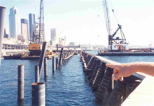

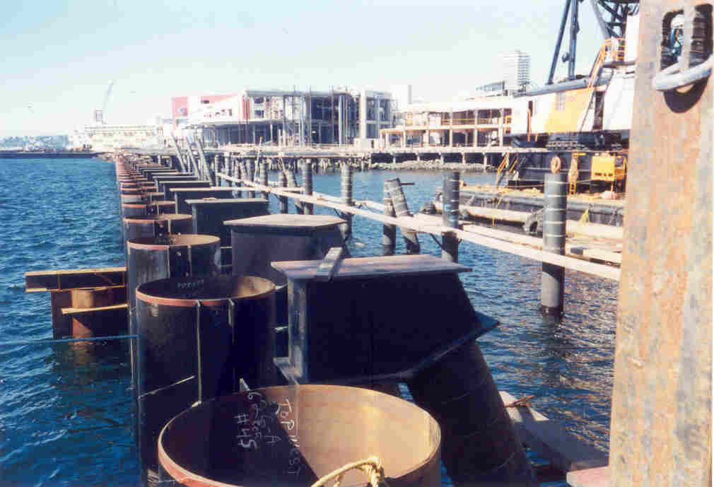

sdef on this wave break at Pier 66 down town Seattle. I fired 12 welders for a he!! of a lot less than what that welder did to you. First order of wire for this project was 3,500- pounds.

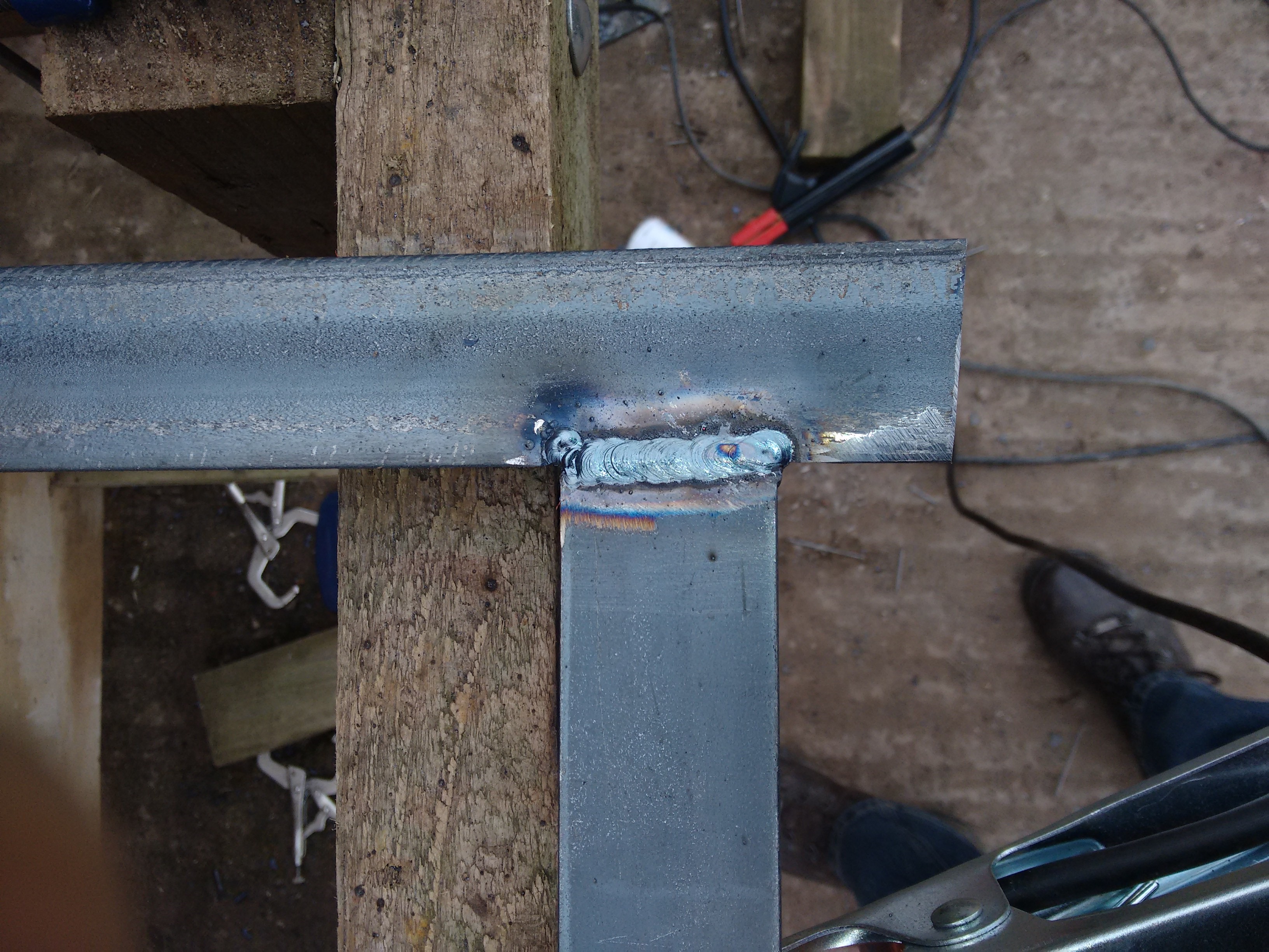

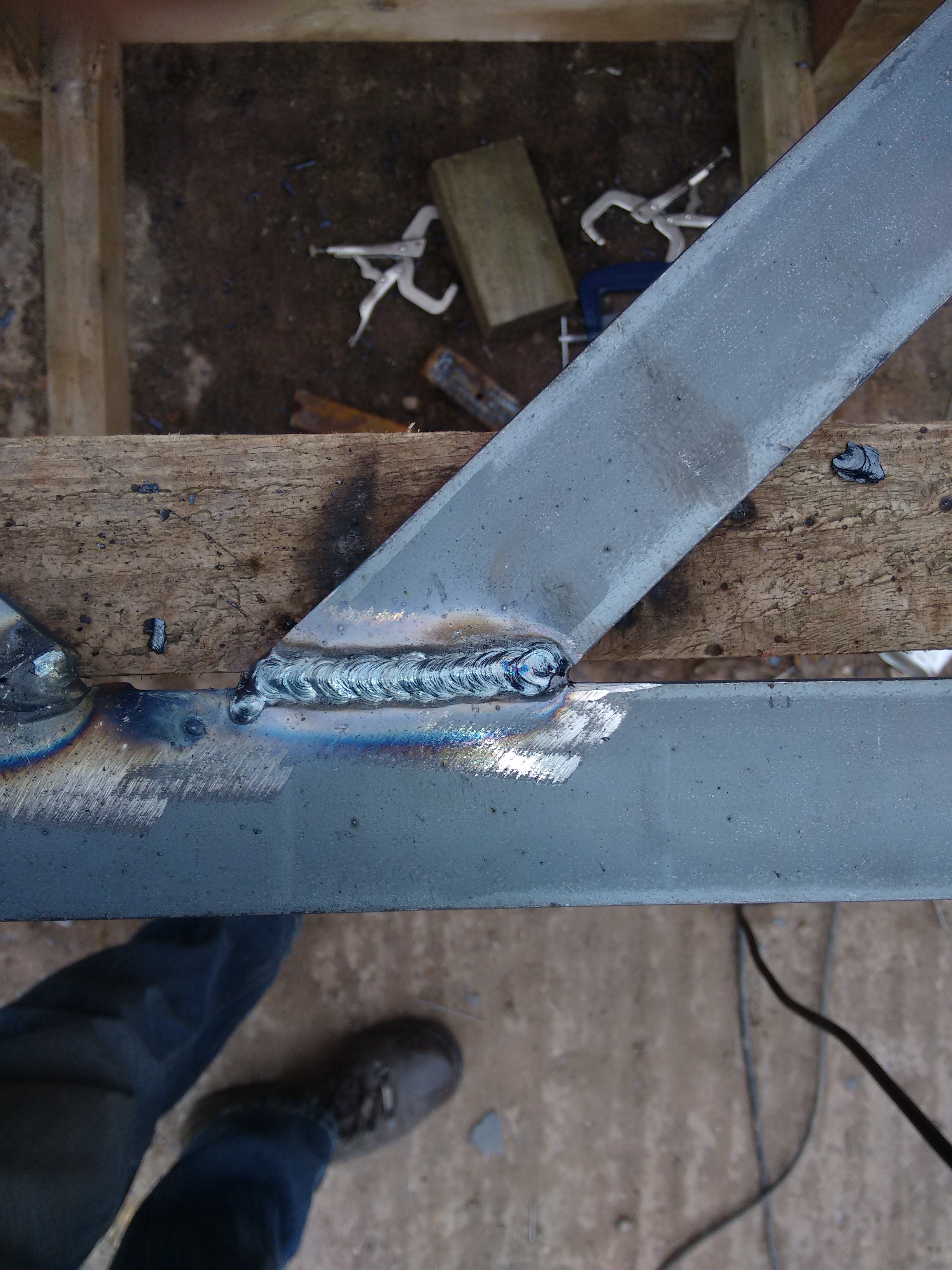

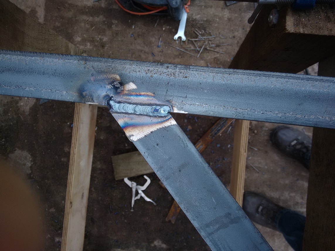

I thought I better have another try at the stick welding game. My first mini project is to reinforce a wooden carry box with steel, which gives me plenty of chance to practice butt joints.
Actually, if truth be told, I spent a lot more time with the angle grinder, removing slag holes and starting again, than I did melting metal. I seem to be able to make two types of slag :-
Bad slag - This stuff just doesn't want to come away. When part of it finally does, it will almost certainly be covering something very ugly underneath.
Good slag - This is almost self peeling, needing only a gentle push to reveal something underneath that almost looks like a proper weld.
Now I need to figure out how to make more good slag than bad - or buy another pack of grinding discs :)

Buy a cheap needle scaler. Good for slag removal and peenig the bead to remove stress. ... Also, get some 3/32" 6011 rods to spot fill imperfections using about the same amp you use for an 1/8" bead.
,,,,A die grinder with 1/4" carbide ball cutter is good to clean out pocket imperfections prior to touch up.
/ I wish I could weld
#78
Thanks, I will have a look out for the needle scaler and ball cutter.
In this country 6011 doesn't seem to be widely available, at least not to people like me who would only buy small quantities, it's all 6013 or 7018. I have just been given a pack of Lincoln 6013 rods by a friend. Tried them last night and found the flux coating on these to be much more tolerant than the non-branded ones I had, making it easier to re-strike and tack things up.
Also had a quick go with these new rods at welding vertically, nothing fancy, just trying to run a bead up or down. That's hard ! I quickly realised fully vertical is way too ambitious for me at the moment and tried it instead at 45 degrees, as the training book recommended. Played a little with the current and still struggled at going up. Going down at 45 degrees was much easier, possibly because in that direction, it is easier to see where the weld pool is going. I can see I will need a lot more vertical practice, or if not resign myself to welding in just 3 positions - on the flat, perfectly level and horizontal :).
