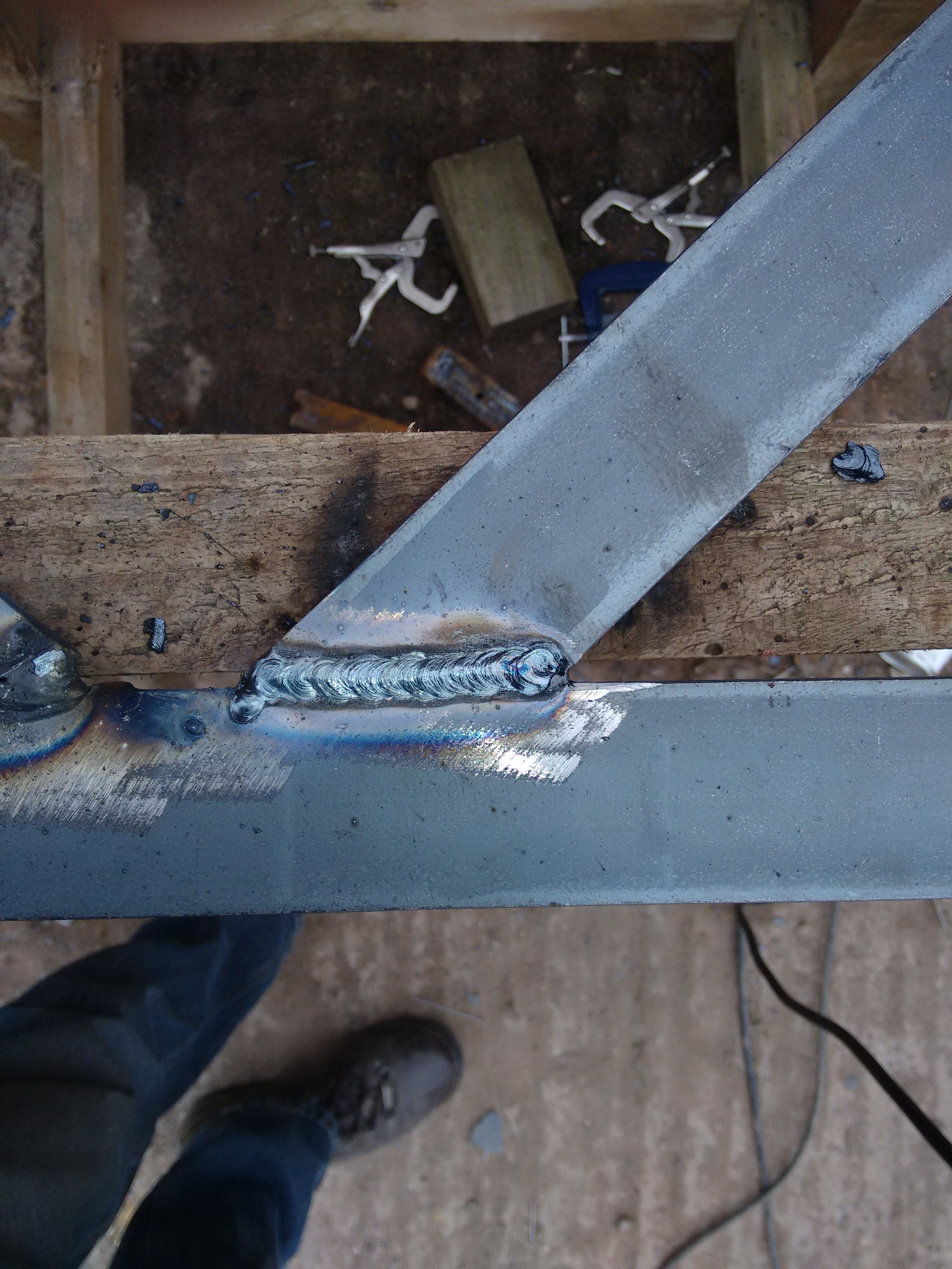

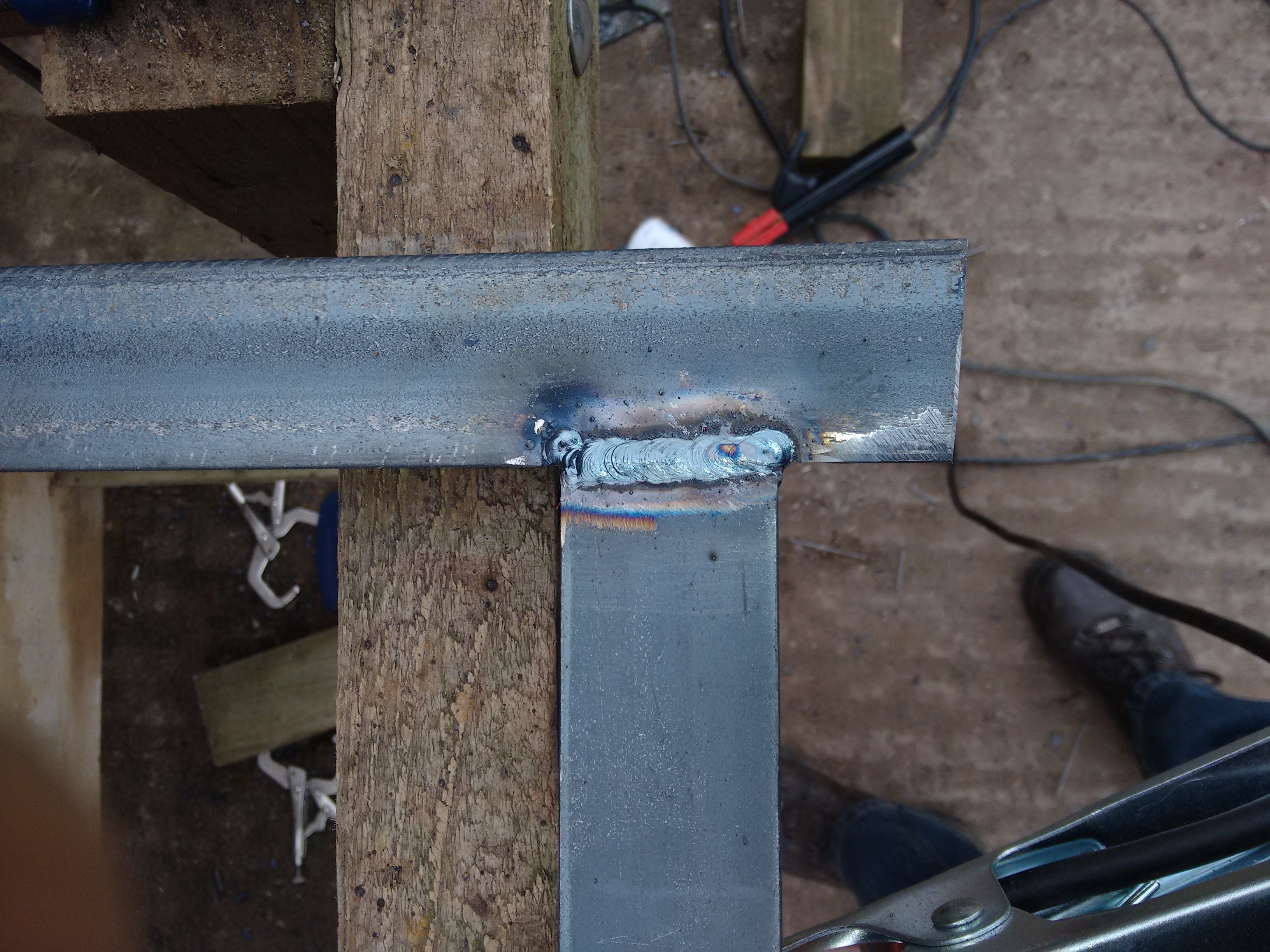

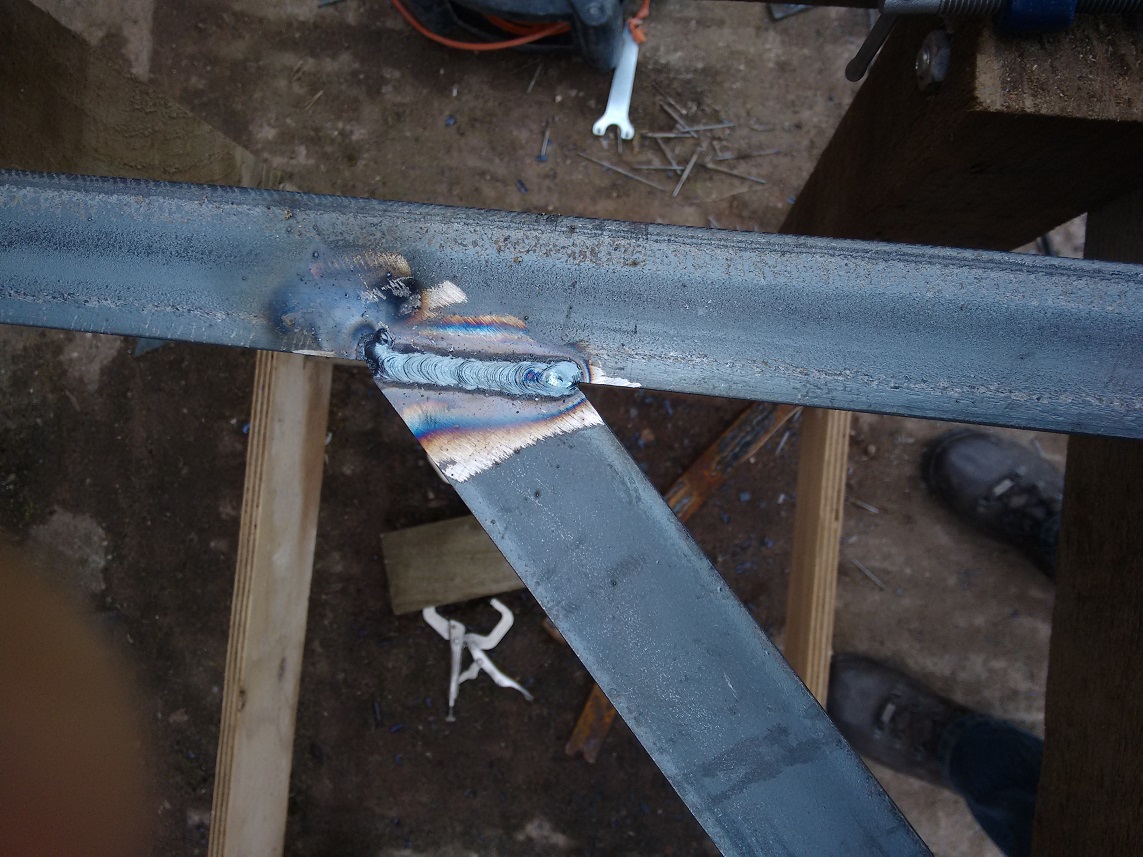

I thought I better have another try at the stick welding game. My first mini project is to reinforce a wooden carry box with steel, which gives me plenty of chance to practice butt joints.
Actually, if truth be told, I spent a lot more time with the angle grinder, removing slag holes and starting again, than I did melting metal. I seem to be able to make two types of slag :-
Bad slag - This stuff just doesn't want to come away. When part of it finally does, it will almost certainly be covering something very ugly underneath.
Good slag - This is almost self peeling, needing only a gentle push to reveal something underneath that almost looks like a proper weld.
Now I need to figure out how to make more good slag than bad - or buy another pack of grinding discs :)
