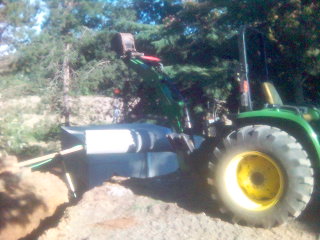

I wish JD had the same BH for the 4x20 that the 110 TLB has. The 4x20 is larger than the 110 but the 448 hoe is smaller. 90% of the time it is just fine. I knew it wasn't a full size hoe when I bought it, but since they (JD) makes a stronger hoe for the same general size I wish they had offered it. Installing 12" ID concrete culverts takes all that the 448 can put out. These weigh about 700lb each. I can only pick with the dipper stick, not the main boom. So the range of movement is really restricted.
Oh well it still beats digging with a shovel and trying to roll the pipes in with a pry bar.

The 110 is the same size as the 4000 series. The 110 is a seroius machine not and home owners unit. A 110 hoe on the 4000 series would tear it in two. If you ever look at the 110 and 4000 side by side you'll see for your self. Now I have a 448 on my 3320 and find it a great match for the 3000's. Deere should design a hoe for the 4000's that is a little more powerful. I believe the woods hoe for the 4000's is no joke.

Tom -- what are you doin' with concrete culverts?? Wouldn't steel ones be cheaper and a whole lot easier to work with....?

AK: Culverts are utility passages from new utility building to house and barn. I don't want to trench the road more than once. They will have the main power feed, a UPS feed to selected circuits, potable water, irrigation water, fire main to barn, compressed air, irrigation controls, and coolant lines from the genset to the house and back. Plus fishing lines for future expansion.. Vaults at hose and barn to access. I got the culverts for $3.00 a ft delivered. They are "seconds" from the local mfg plant. For my use they might as well be prime. Mostly a few chips on the bell or where the remesh got too close to the surface.
