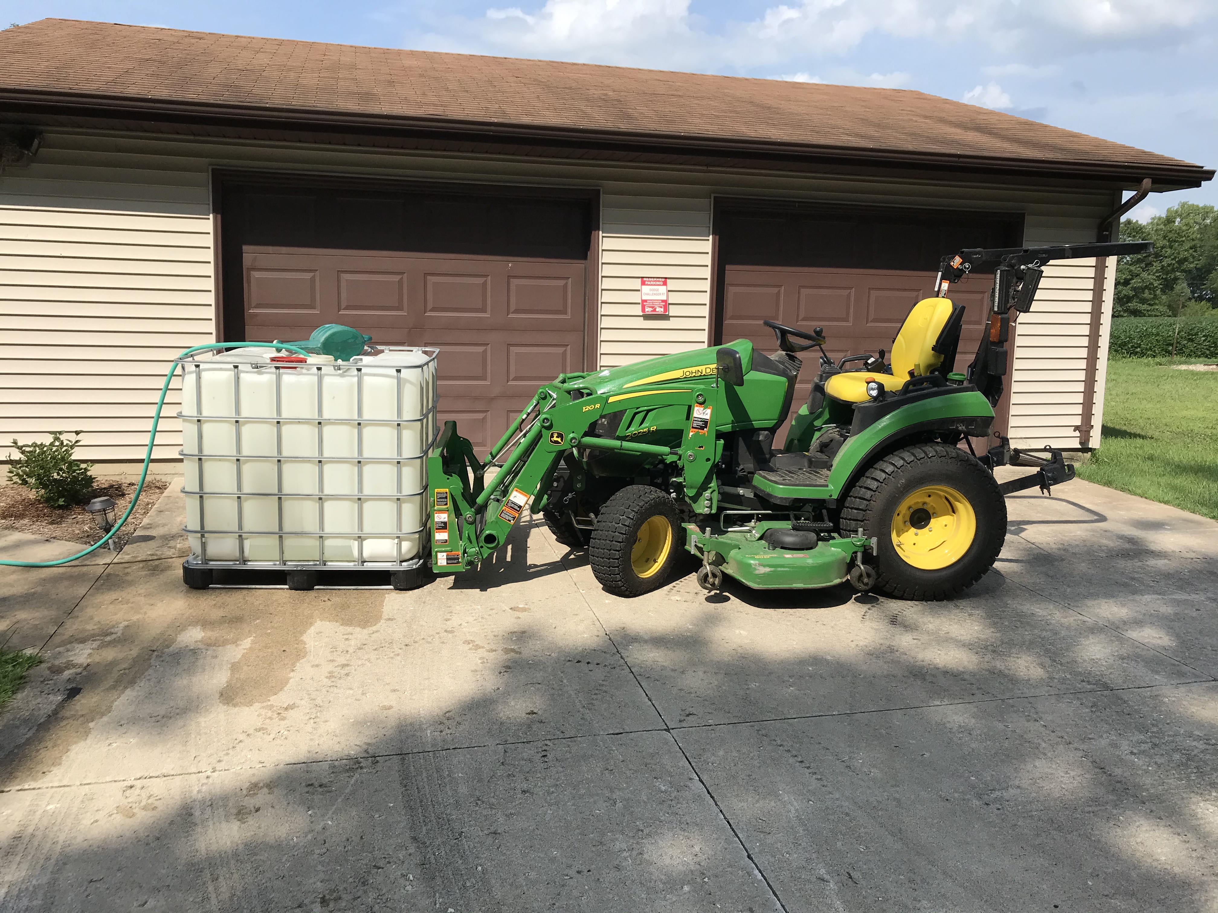

0CE4C0E8-5244-4603-B9DC-55A0E4BC89CB.jpegI bought two IBC totes that had soy bean oil in them. They are tough to lean out. I put a half bottle of dawn in each one and filled them up with water and then power washed them out. If you are cutting them in half, that will make them easier to clean.
