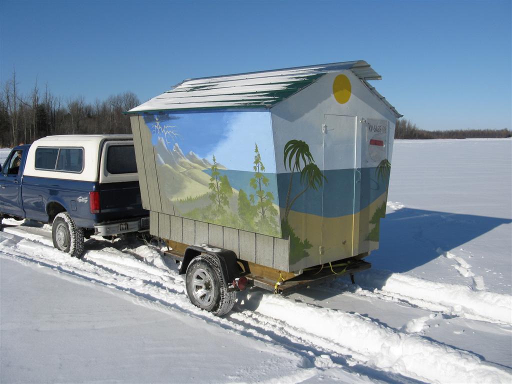

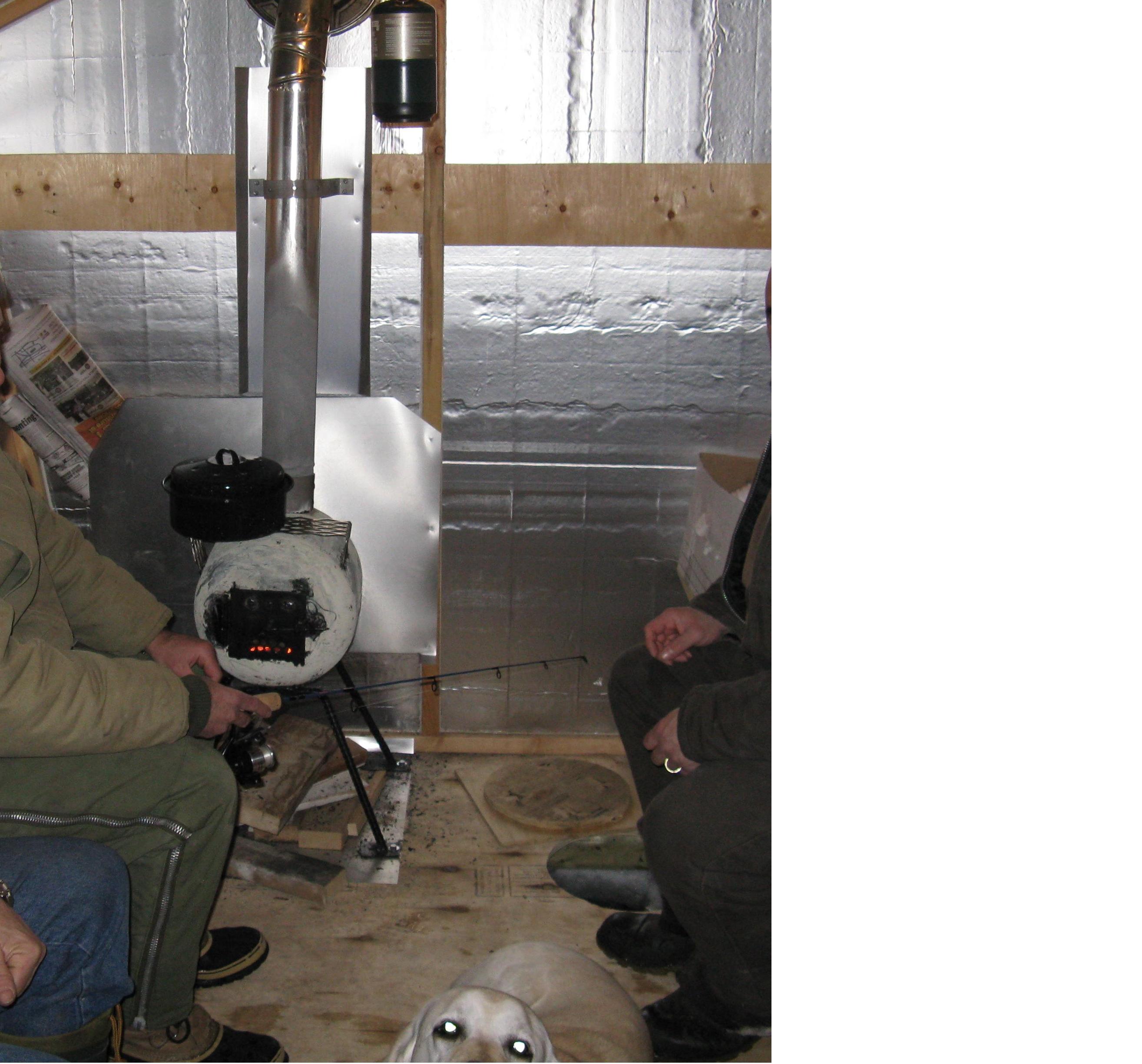

Here's a shack that I designed and built for our local fish and game club. A member is an artist and did the mural. The shack is heated with a wood stove made from an old 20lb propane tank. The stove has been modified for this year - now has a bigger grill and is painted black.
The shack is designed to fit into the back of a full size pickup; the angled sides provide a backrest so you don't have to haul any chairs. Floor size is 5 x 8; you can comfortably seat six (to warm up, not to fish!).
I might make a new stove out of sheet steel, the propane tank is a little heavier than necessary but it works very well.
