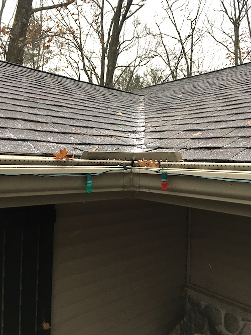

Some type of drainage sump could also help immensely. My 3x16' wooden walkway has 6-8" of space under the planks and it is plenty enough to absorb and drain away all our snow, ice and rain.
/ Ice on the Walkway #12
Do you have a gutter corner guard installed?
/ Ice on the Walkway #13
Gutter and downspout heat tapes should help alleviate that valley problem. Move that water to a less dangerous area.

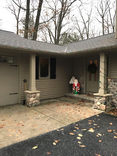

A possible solution, depending on the specific layout...move the walkway a little further from the building. It could be just a bow out away from the icy area or just installing a new walkway a few feet away.
Another option would be to extend an overhang from the roof beyond the walkway... again, it really depends on the layout.
These would be more permanent solutions if you cannot redirect. Melting and removing, whether on the ground or the roof are time consuming and/or costly over the long haul.
/ Ice on the Walkway #16
I am also wondering where the water come from ? is it due to rain\freezing rain or is the snow melting on the roof ? ... if its below freezing and the snow still melt on the roof you need to add insulation in your attic. it could be worth checking it out you would save in heating and reduce the water problem.

A couple of images might clarify my post, and yes checking the insulation is on the list of things to do as a long term solution. You can see there is a diverter at the 90 degree corner where the gutters meet, but it is not as larger as the one in the imager above. The ground is pretty flat at the entrance. And, the snow melts from the top and sides of the valley and comes over the edge at the diverter as well as along the edge of the gutters. I'm thinking for this winter that heat mats in the area where the water drips is my best solution. Longer term, I still need to investigate the options, including getting a larger diverter. Up until the past two days thee was about 8" of snow on the roof, but temperatures in the 40s and 50s melted most of the snow and high winds too care of the rest. It is snowing again today.
