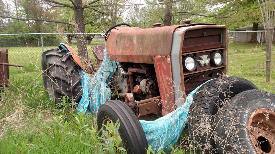

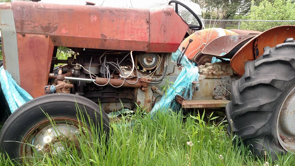

Hey Everyone-
I am hopefully picking up this MF tractor this weekend. I am getting it for a song, and I've been wanting a gasser to fix up. I don't even have data plate information on it right now. Can anyone tell me if its a 100 or 200 series? I'm guessing its a 35, or 40, but I can't tell. The large hydraulic cylinder on the left side makes me think 200 series. After buying and fixing up my MF 65 Diesel-matic last year, I kind of have a soft spot for Masseys, and as I said, the price was right. Engine is (or was) free. I know the starter is bad. She needs at least one rear tire. I'm sure there are plenty of other issues as well, but it has been sitting for 6 years. Other than the fact that the condition is poor, I'm looking for advice on what exactly it is, and if whatever it is happens to be, is a tractor I should stay away based on model. Any Help or insight would be appreciated!

Find the serial # and then check both series on tractor data. The serial #'s should be different for both series. Tractor data can help locate serial # if you have difficulty.
/ ID this Tractor #3
Maybe a 165 or 175
/ ID this Tractor #5

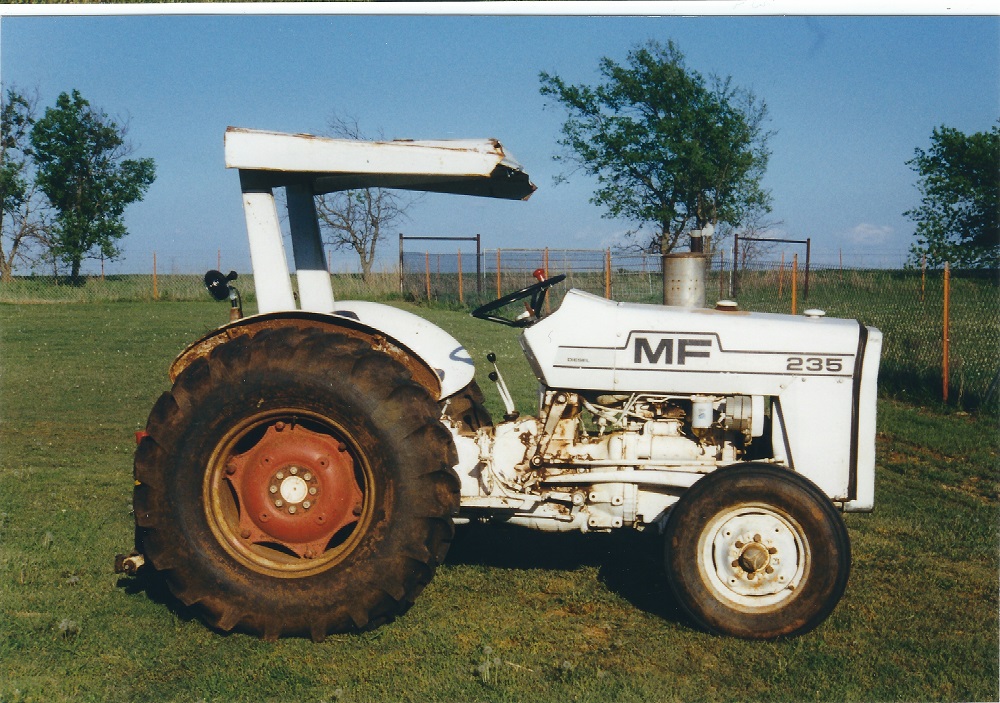

Based on the 235 that I had, i am guessing it is a 200 series:

Something from the 240 to 580 range. The distinct location of the air filter might be the giveaway for photo analysis. Scale of the pics suggests the lower end of the range.
Get the Seriel number and ring a local parts specialists for advise.

So my father swears this is the only Data plate he can find. My older MF65 does not have TRACTOR written into the serial number, this is the first time I have experienced it- although my experience is limited. Anyway, I still can’t seem to get much info from just this serial number. It appears to match up with MF 165, 135, 250, and other I’m sure. Any ideas?IMG_4728.JPG
/ ID this Tractor #14
its gonna be a 1976 MF 245
9A242489 1976
9A257837 1977
/ ID this Tractor
#15
9A2424891976
9A2578371977
Thanks M5, I should know more info tonight when the machine gets picked up. I’m curious where you got your information from? Just trying to learn as much as I can...
/ ID this Tractor #16
I just searched for the Prefix 9A that gave me the several models that had it then looked at each for the starting number after 9A , 1976 started 9A242489 yours is 9A249324 . 1977 started with 9A257837 so it was made in between the two starting numbers
