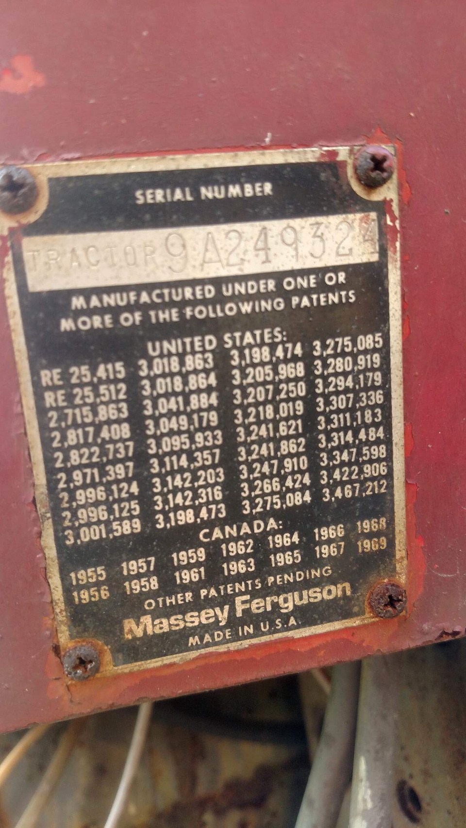

So my father swears this is the only Data plate he can find. My older MF65 does not have TRACTOR written into the serial number, this is the first time I have experienced it- although my experience is limited. Anyway, I still can’t seem to get much info from just this serial number. It appears to match up with MF 165, 135, 250, and other I’m sure. Any ideas?IMG_4728.JPG
/ ID this Tractor #14
its gonna be a 1976 MF 245
9A242489 1976
9A257837 1977
/ ID this Tractor
#15
9A2424891976
9A2578371977
Thanks M5, I should know more info tonight when the machine gets picked up. I’m curious where you got your information from? Just trying to learn as much as I can...
/ ID this Tractor #16
I just searched for the Prefix 9A that gave me the several models that had it then looked at each for the starting number after 9A , 1976 started 9A242489 yours is 9A249324 . 1977 started with 9A257837 so it was made in between the two starting numbers
