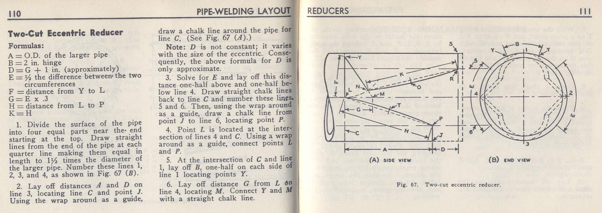

Cut the top half off of a trailer ball, then cut the shank off the other half? Should be easy with a chop saw. Wouldn't be a perfect dome, but should be adequate for what you need, and plenty strong.
Mike I wrote exactly that then deleted it :D thinking - by the time you figure out how to clamp a trailer ball in a flimsy chopsaw vise, then make 2 cuts - you'd be done with the orange peel method. Everybody changing out to 2" should have some extra 1 7/8" around, right?
Shield that's awesome you were able to post up a diagram of the method (and in paper). That would be really easy to cut with an angle grinder. And IMHO, easy to fill in with a MIG.
   / Idea for something round to cap a piece of 1 1/2" pipe with #12
Thanks Dave & Shield, the Orange peel is a really cool method to know!!!
   / Idea for something round to cap a piece of 1 1/2" pipe with #15

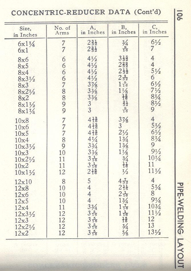

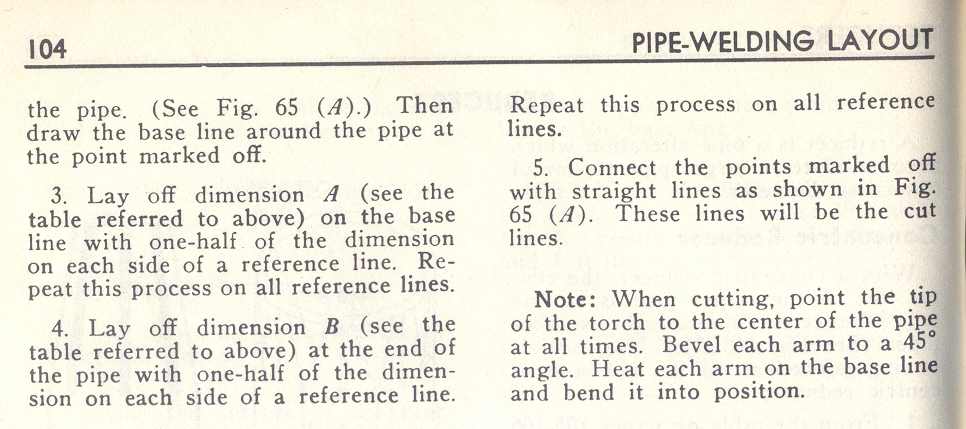

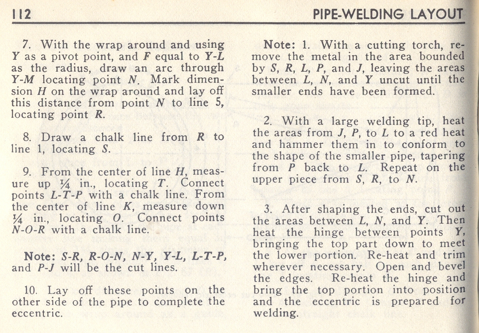

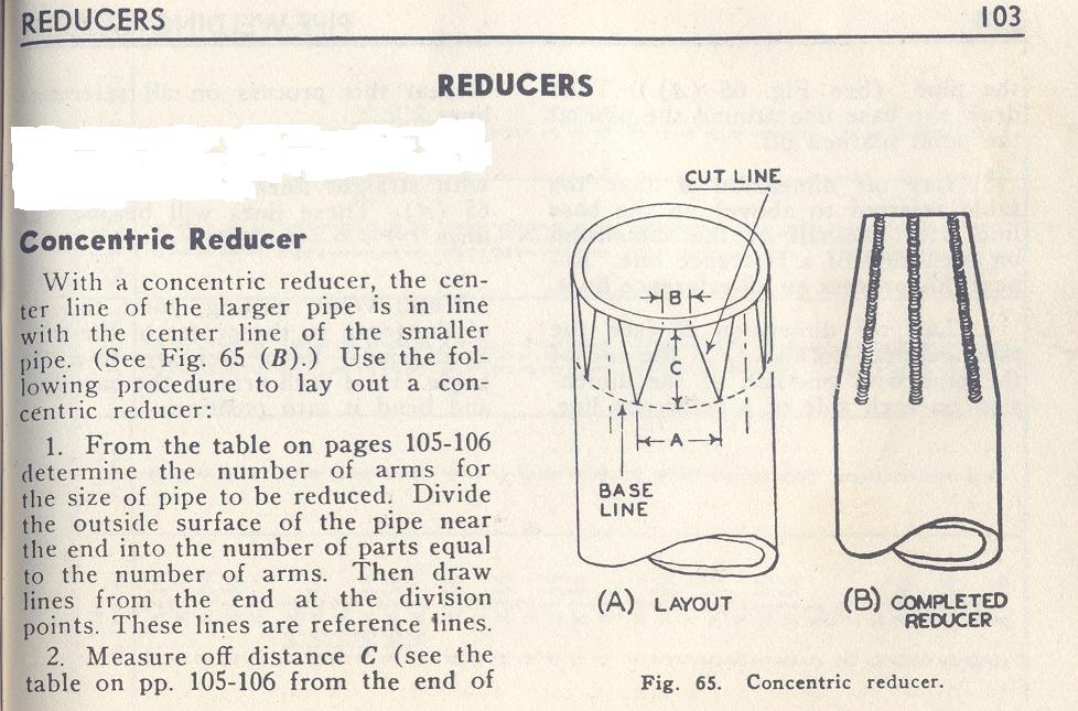

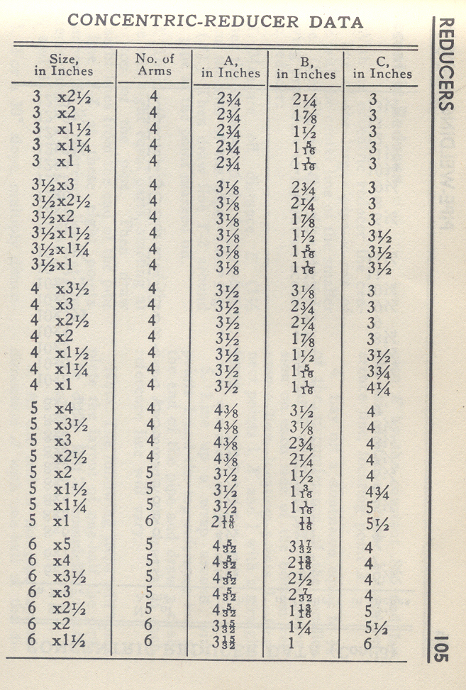

If any of you are interested in knowing how to make your own reducers, here's how.;)
Concentric reducer.
Eccentric reducer.
Two-Cut eccentric reducer.

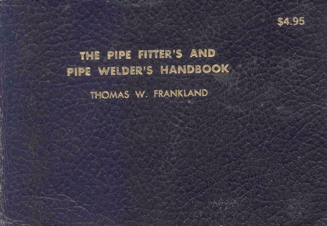

SA; what book is that info in, and how much do they cost? And thanks for posting all that good stuff! :)
:thumbsup:
   / Idea for something round to cap a piece of 1 1/2" pipe with #17
Mine cost $4.95, but I've had it for over 35-years. :D

I cut a circle piece the size of the pipe of any flat stock i have. Weld it on and round off with grinder. Finish with a flap wheel. It looks great.
