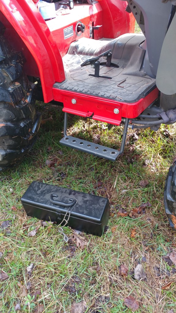

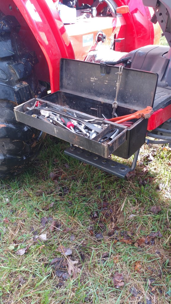

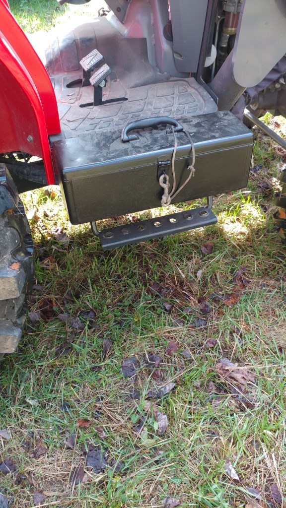

I have the same problem as the OP as the design of my Massey is very similar to his. No room on the back when the backhoe is on and the loader means an up-front tool box doesn't work well. I have an old John Deere tool box that I have had for over 20 years. It mounts on a bracket that bolts to the tractor and, with multiple brackets, can be moved from tractor-to-tractor or other location easily. I already had a bracket on my old JD 1010 and I looked around and dug up another bracket. I mounted the bracket on the right side above the step as I usually get on and off of the left side. Though maybe not the most ideal location it doesn't stick out any further than the fender and when the tool box is not on, it doesn't interfere with the step at all. I like having the tool box follow me to which ever tractor I am operating.

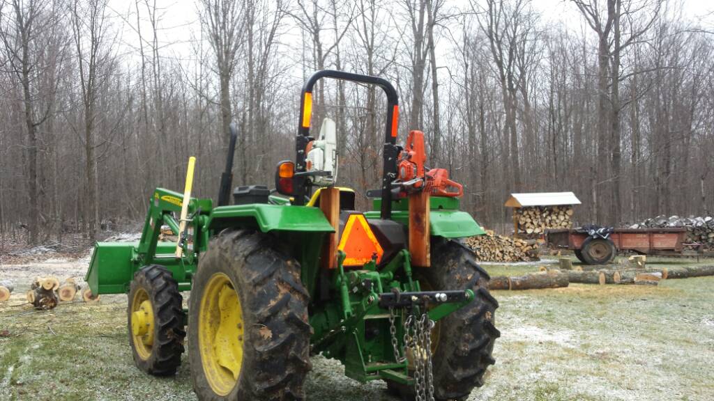

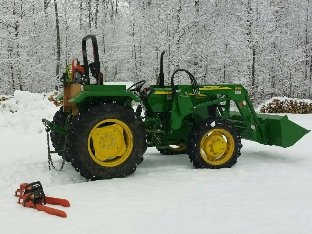

Bigtyme.....all you need now is a Vise and a small air compressor, to sharpen and clean sawdust out ......
Varmint....thats a nice counterbalance you got also...
   / Idea for tools box and chainsaw holder #13
Gordon....Nice, Nice, Nice.....but What is that contraption on the 3pt? for logging?

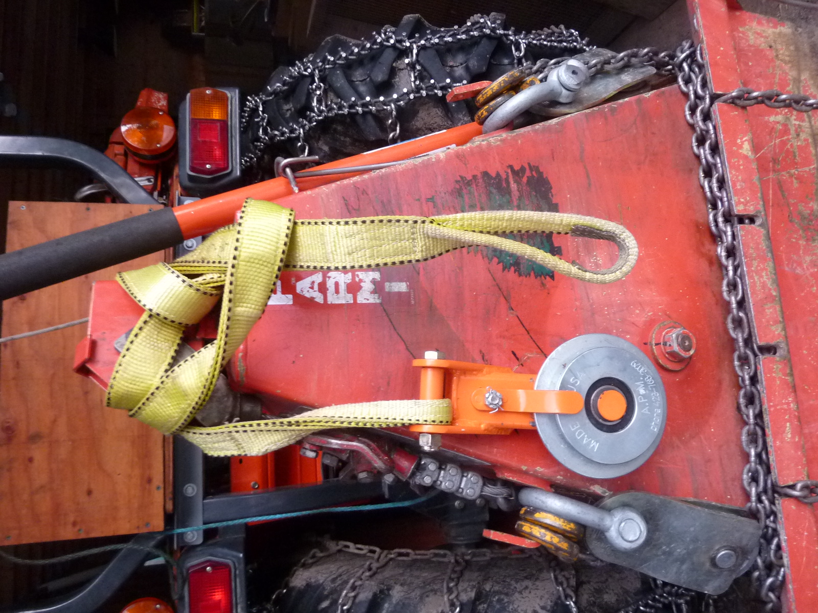

Well that's sure a funny way to plow snow...but it worked. What caused it to unhook from the side pulley?
That's an Interesting devise.
The side pulley as you call it is a self releasing snatch block - Used for getting logs around corners easily. The tree was behind a big rock. I set it up to pull sideways to get it out from behind the rock. This is what it looks like and another short video.

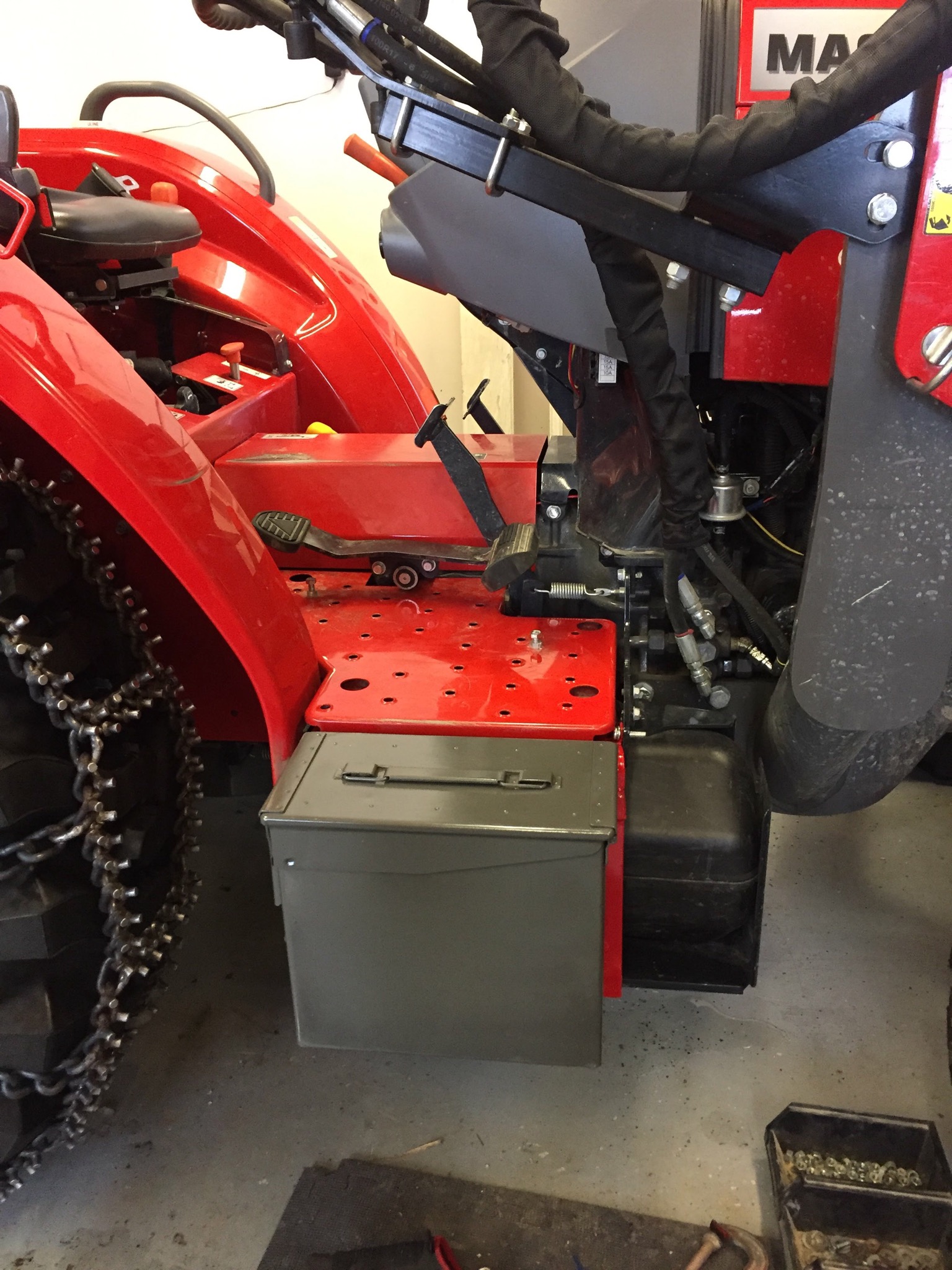

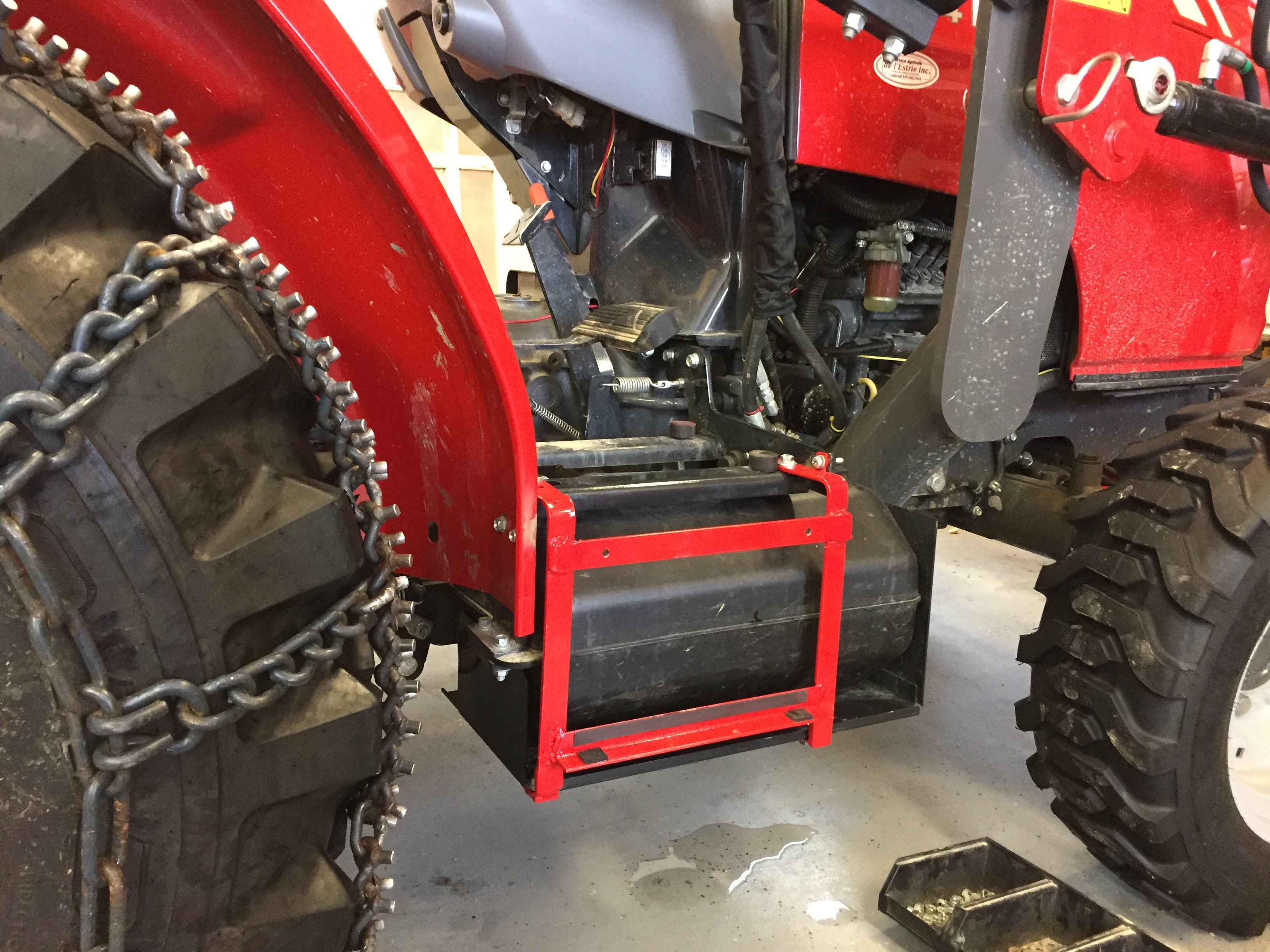

Finally I find some time to install my tools box! I have take few idea from all (using a munition box and putting low on the side of the tractor). I’m happy about the result. Thank!
