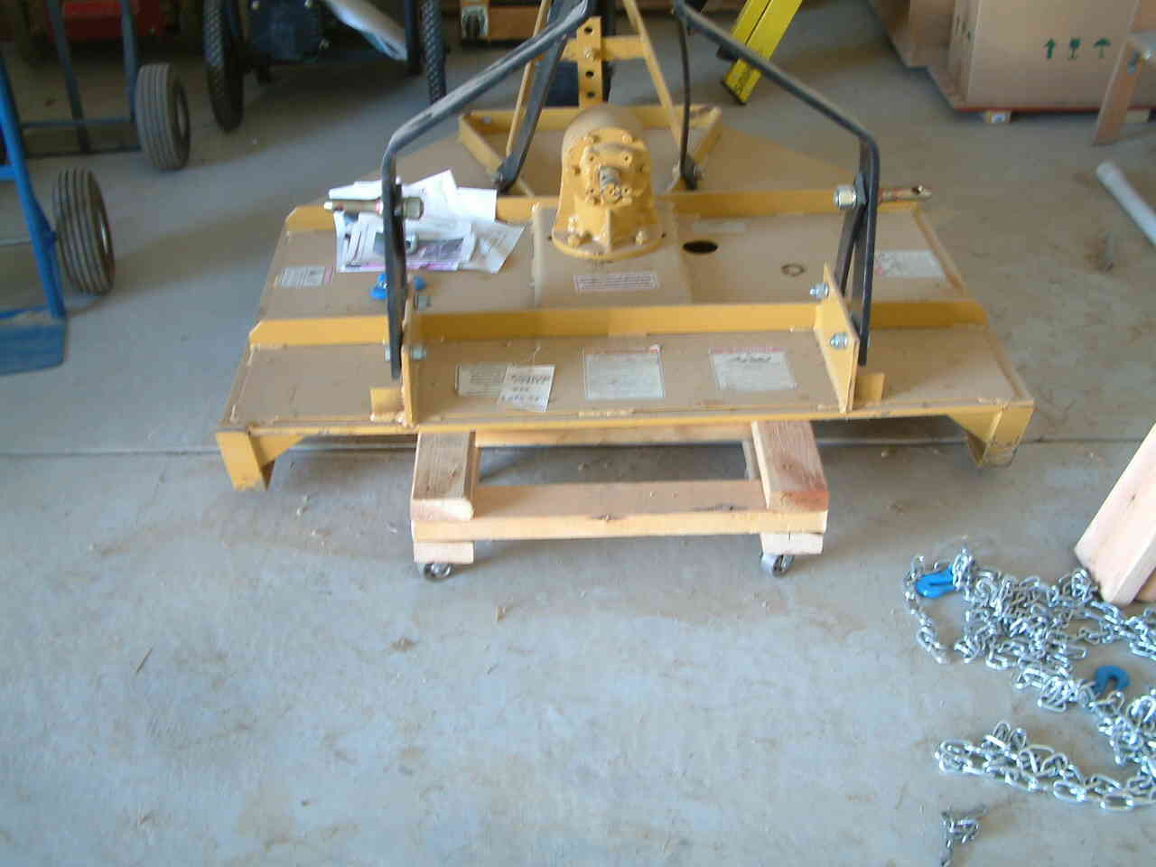

Well, I had a barn come down in a storm and used wood from that. Box blade and rear blade are on 2x6s and rotary cutter is on 2x8s. I used caster wheels and just a basic rectangle shape that fit the implements. Harbor Freight has furniture dollies that may work for you, too, fairly cheap if you don't want to make any. I'd go take a pic for you but it is -3 with a wind chill of -20 right now in Ohio! Almost all schools are closed because they can't start their buses. When the weather gets milder I will post a pic.

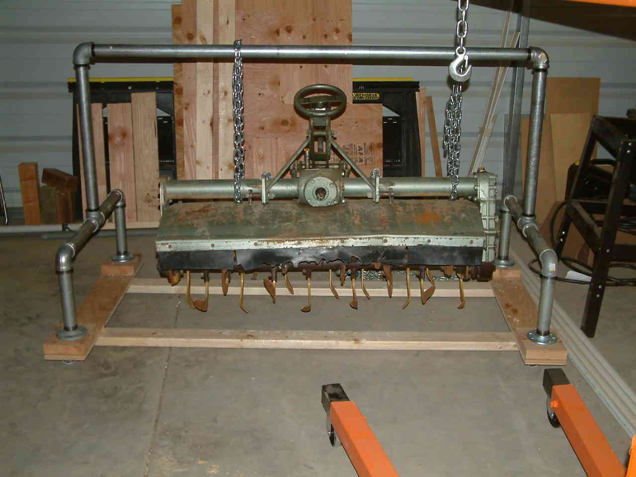

Here's a few photos of the dollies I have for my box blade, brush hog and rototiller.
Used metal swivel casters from Home Depot ($4 each). Needed a gantry type dolly for my rototiller because of it's awkward shape.

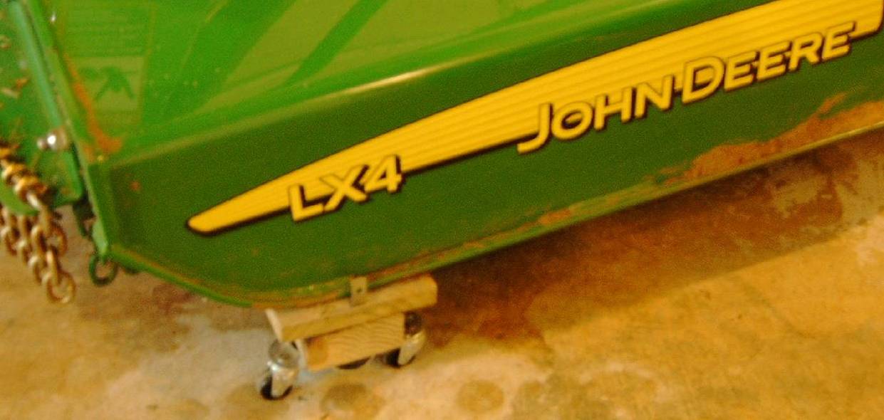

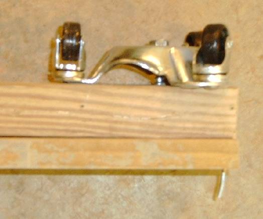

Ok I'm going to try to attach a very crude drawing of what I did. I used swivel caster wheels with 3/8" bolts and washers. By putting the side 2x6s on top of the front/back ones I could attach the wheels where I've shown on the pic and not worry about the bolts sticking up. I then hooked up all my implements the hard way with grunting, groaning, shifting things around with a 2x4 and put them on the dollies, unhooked and slid the dollies where I wanted them. And from that point on I became a much happier tractor operator!
Had a little trouble getting that file small enough for TBN, hope it can be seen!

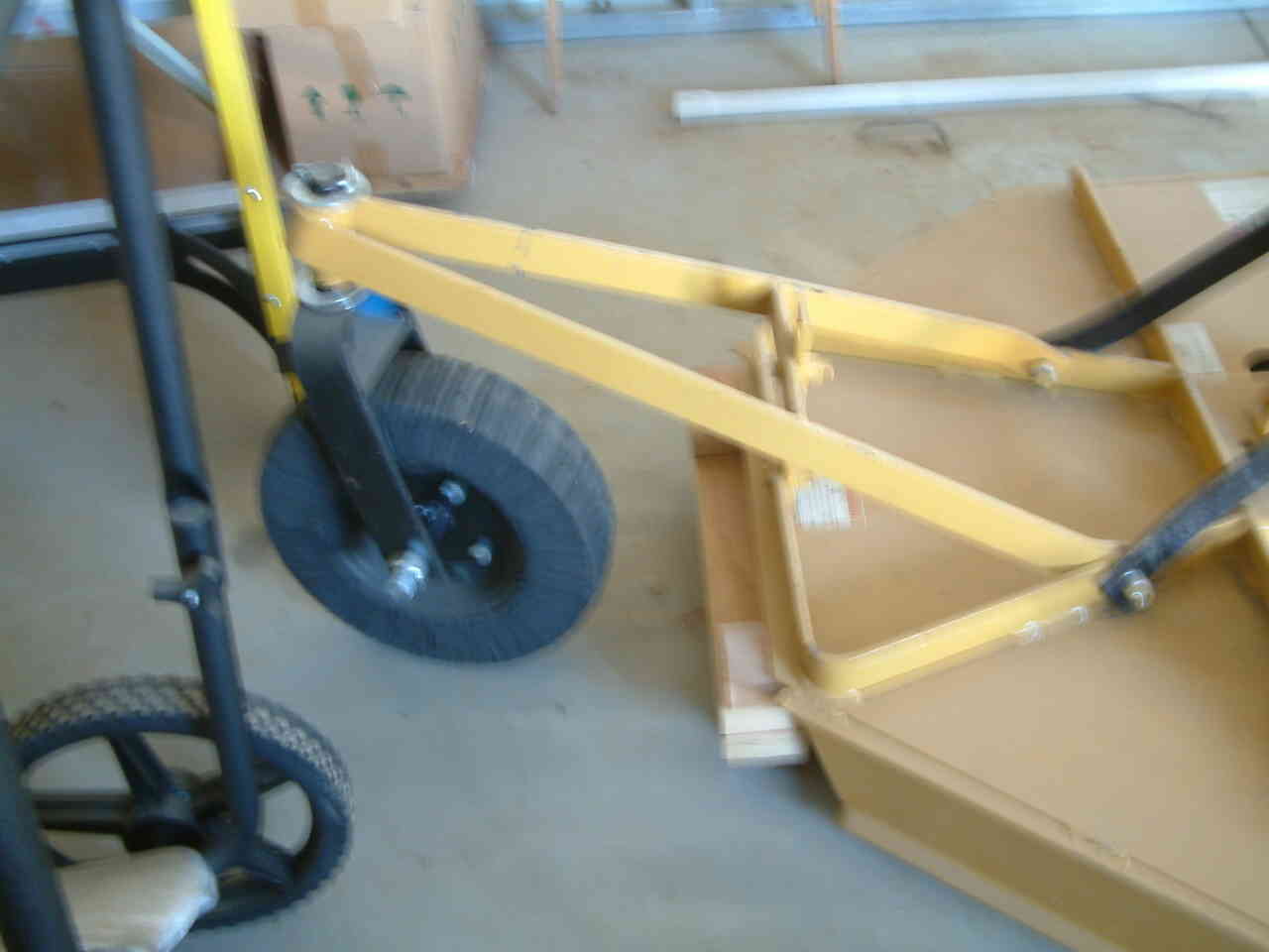

For a brush hog, since it has a wheel already, all you need is a simple dolly to set the front of the skid onto. Here're a couple pics of the one I use on mine.
Ralph
