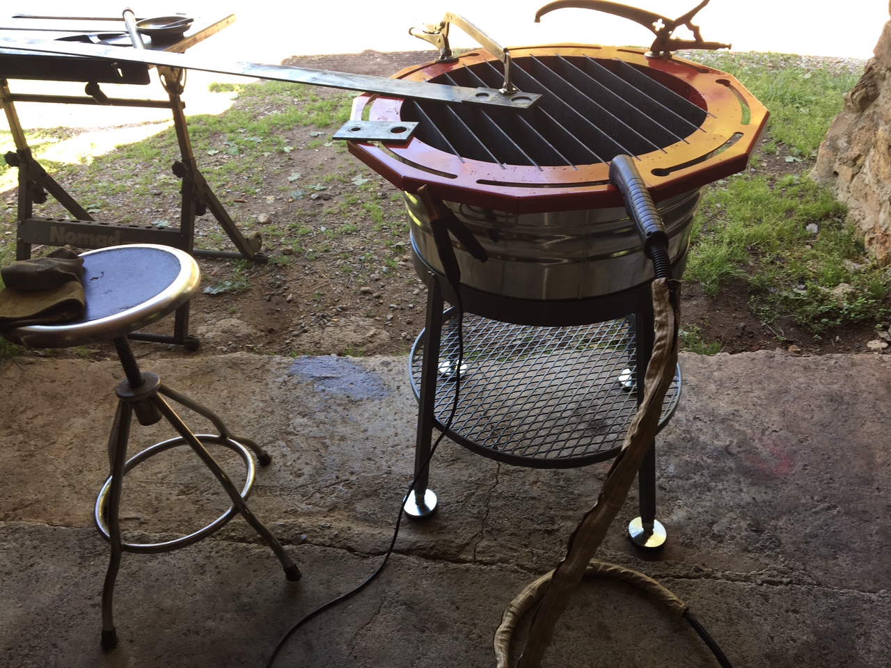

Weld bench
Plasma cutting bench. 10” adjustable feet allow matching other benches.
Like benches higher and have foam mats.
