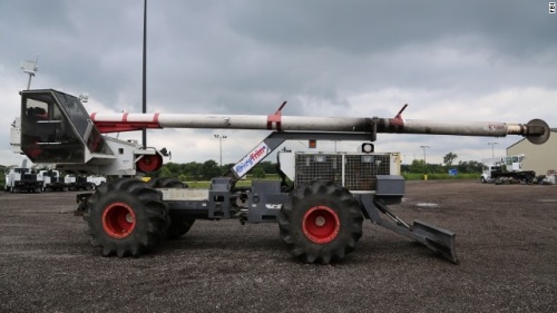

They do have chainsaws with automatic oilers but I think a chainsaw is the wrong tool for what you are looking to do for those heights. Chainsaws are finicky about positioning when cutting. The people who trim high lines and right of ways use a boom with a circular saw blade type cutting tool at the end.
Its also reatractable. I can't imagine driving around with a 40' pole sticking out from your loader.

You might look at hydraulic shears. I saw some on a pole while ago but can't find the link now.
   / ideas for a long boom pole saw #13
That looks really scary.
What's scary is the thought of a tree limb falling down 40 feet and hitting you while you sit in your tractor seat trying to manipulate a bouncing pole saw. Its better to be above the falling branches than below them.
These man-lifts are pretty cool to operate and won't let you go beyond their designed operating range unless you plan on hitting some electric wires. Here's another 35' shot:

That was my point. Cutting with a chainsaw requires good positioning. Its much harder for me to cut a limb with my 9' handheld pole saw than with a chainsaw in my hands and my eyes on the cut. With a boom pole (especially that high) being maneuvered by your FEL I think it would be a mostly useless tool. If it worked well you would see commercial versions. The fact is they use circular blades or shears.
