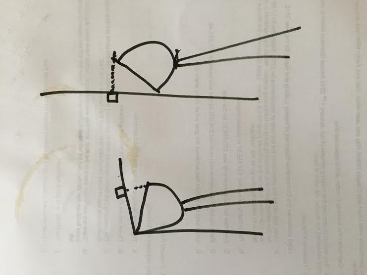

I'd try something like this. Lay the panel on flat ground with a 4x4 under it that you can chain to the top of your bucket. Press the cutting edge of your bucket at the bend point and curl while maintaining down pressure. It may require re-hooking the 4x4 depending on how much rotation the bucket has. Pardon the crude drawing.
EDIT TO ADD: If that doesn't pull a tight enough 90 degree bend, you could substitute something like a piece of plywood for the 4x4 that extends from the chains to the bend point to avoid the "belly" that could happen on the piece you pull upward. The piece on the ground is probably OK.
