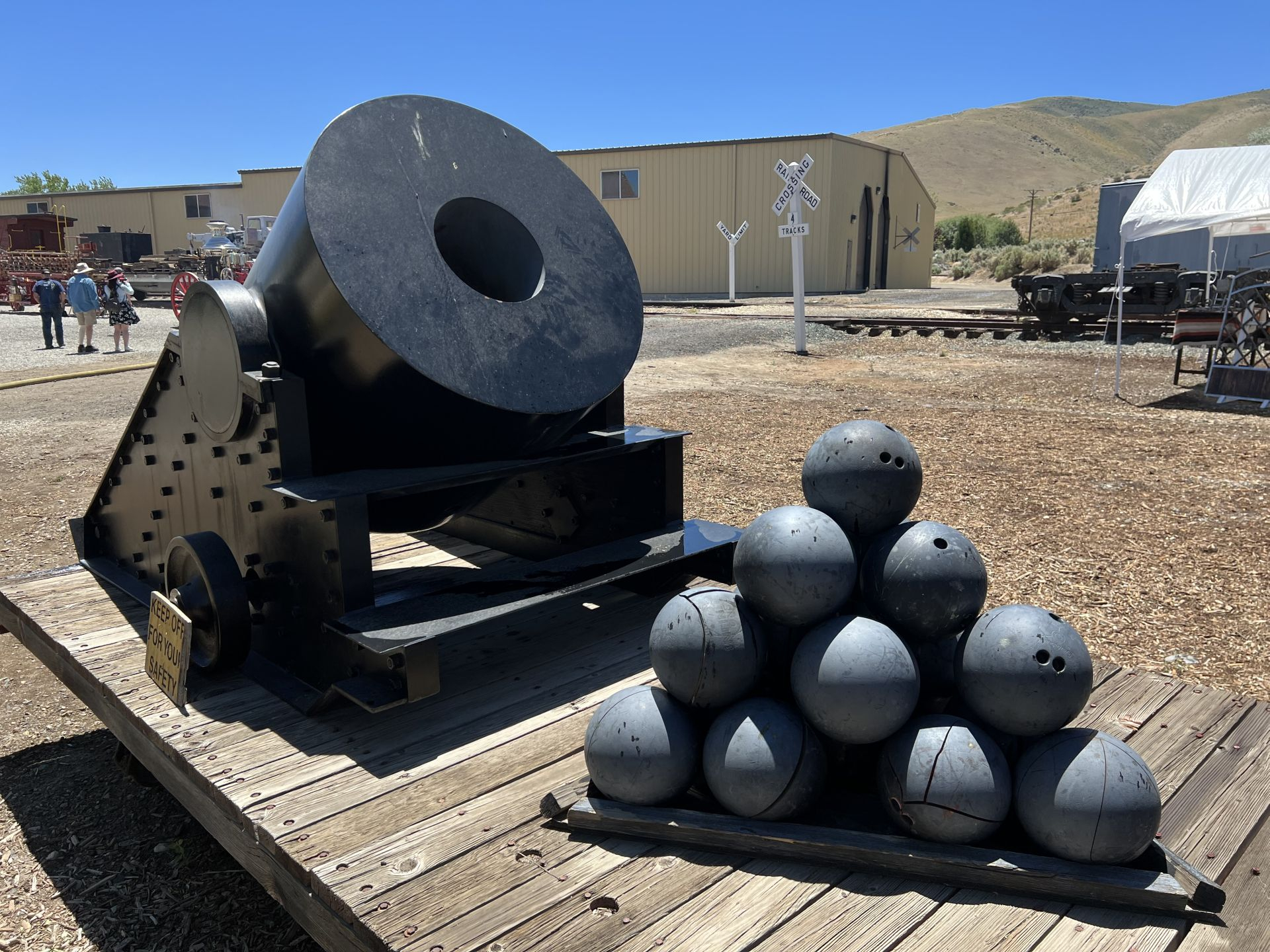

I saw this cannon today in Carson City, NV. It had a display of "cannon balls" in front.
After examining these .... "cannon balls" .... I wonder-- why didn't you just use the finger holes in the cannon ball and pull it out? :D

This has been interesting to follow, and I'm glad that you got it out. I wonder if those balls were used for ornaments at one time, and the holes were used to hold them into place on the brass monkey. :confused:

I'm glad you got the ball out safely. Congrats on that. As far as the hole in the ball, that may be a vent hole to vent out air pockets while casting the ball in a mold. May help get the molten lead to "fill" the casting mold completely. A ball with various abnormal air pockets in it will not "fly true" on it's way to the target.
