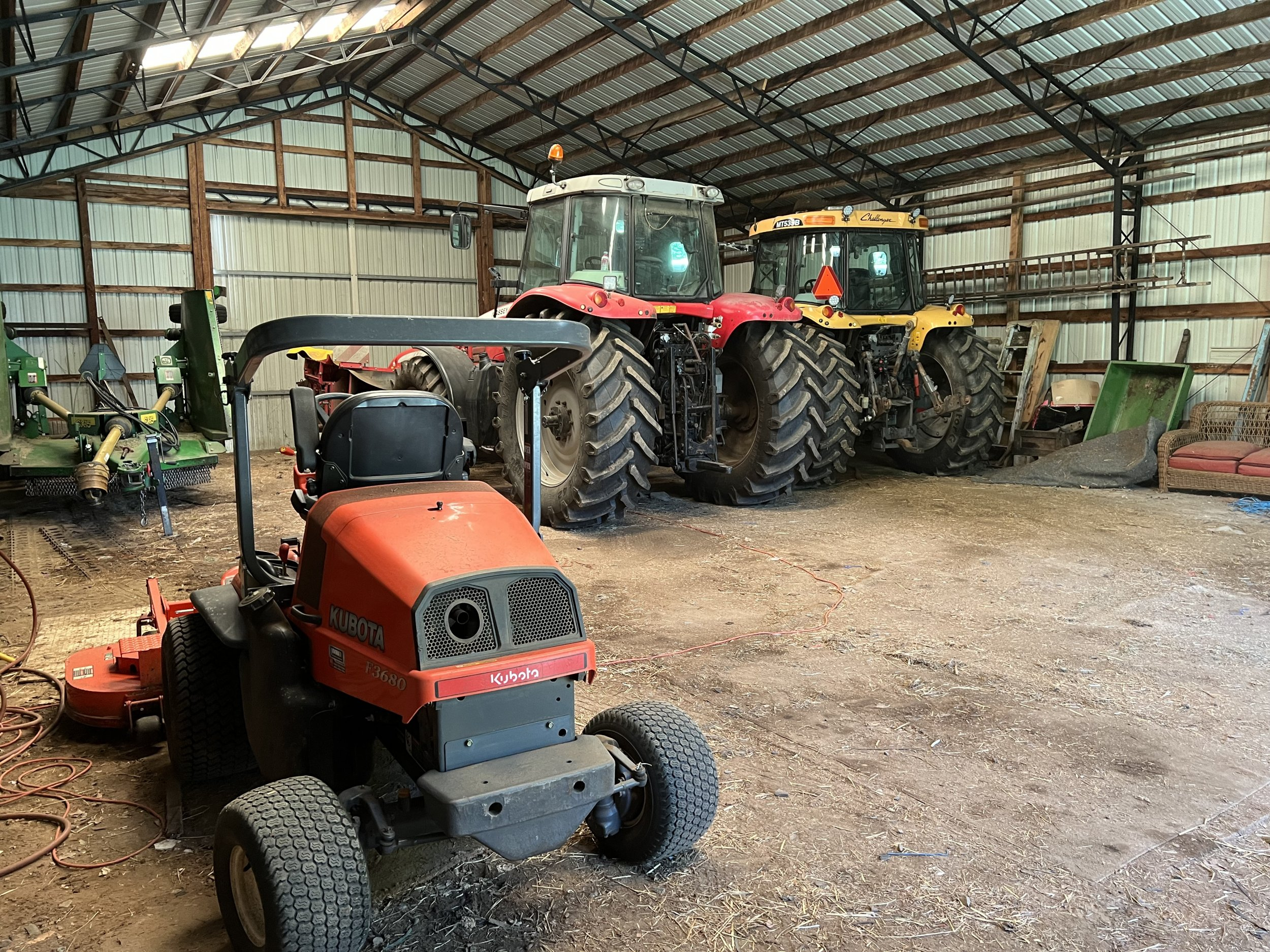

That Challenger is so tall you could mount a strobe to the undercarriage like all the cool kids.
   / Ideas for fastening strobe light to tractor roof
#72
It’s not really, compared to most farm tractors. My 2 larger tractors need a 12’ door.
   / Ideas for fastening strobe light to tractor roof #73
HeyDud do you have lights on the top front of your
cab? If you want a flashing light just put one on
each side of the cab should be able to see long
ways away
willy
   / Ideas for fastening strobe light to tractor roof #74
OP: that whole shell of a roof pops off by removing the fasteners from under the shell. from there you can run power from under the shell to where you want to mount your strobe light with a weather-connector (I suggest either a big-a ss Delphi-style weatherpack or a compact Deutsch weatherpack connector so you can remove the light to get the machine inside the 10' garage opening.
Alternatively, as my buddy asked when about to order a new garage, "Eric, how high is your Payloader?" Order a 14' tall door.
