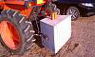

I would think that if you built a Ballast Box, like the one pictured, it would solve your lowering the CG. I built one similar for my L235. Formed out the box, used 9½ 80 lb bags of concrete for an estimated weight of 900 lbs. Just raise it a few inches and nothing is going to, of course, within reason, lay it over. Also, will help with the stress on the front axle, especially with a FEL.
The resolution might not be to good as I had to enlarge.

Renders the tractor completely useless for attaching to a drawn or mounted sprayer.

Are these towed implements or need the 3pt? If, by chance, they are towed, the hook up or hitch could be on the back side, attached to the draw bar that is connected to the 3pt when formed. Just throwing some ideas around.

Thanks for the picture Rick. Those rears look tuff.

I wouldn't want to move the hitch point back on towed implements when working on steep hills, especially a sprayer as the liquid can really push a light tractor around when it gets sloshing in the tank.

That would be the ticket except for the types of attachments I'll be using.
