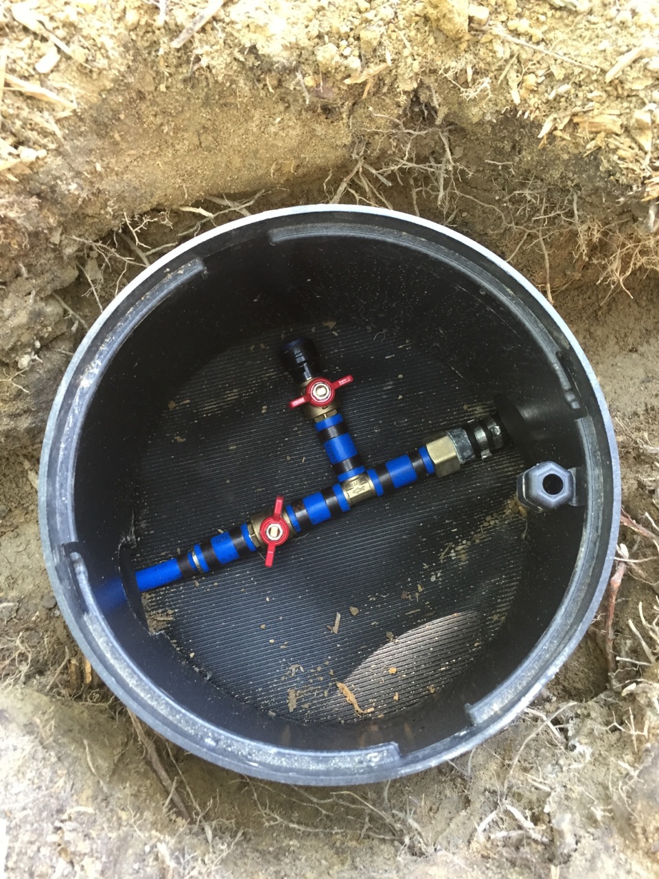

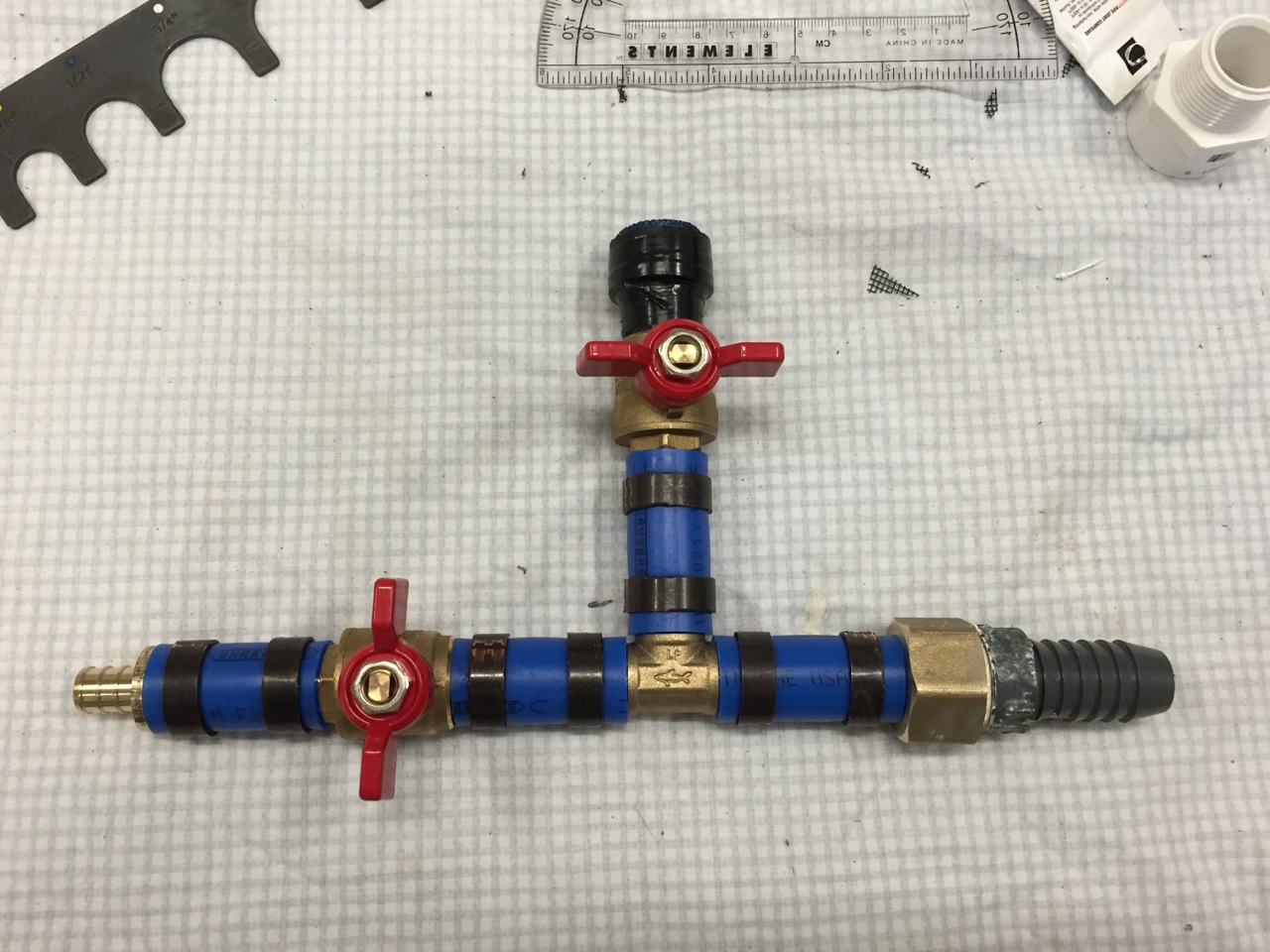

Here's what I ended up doing -- got two ball valves with PEX fittings and T handles and made up a little valve station. One valve will shutoff water coming in (from left) and the other can be cracked open to serve as a vent when I want to drain the pipe running down to the pier (going out to the right). I liked this a little better than spending $60-80 on a curb stop valve, since I figured I could drain the line a lot quicker with a full 3/4" vent opening compared to a pinhole vent. I used a short piece of PEX and some window screen to cover the vent to keep insects out (I hope).
I put this inside a round irrigation valve box ($11 from Home Depot). I will drill a couple holes in the lid and weld up some rods that hook onto the valve T handles and poke up through the lid a couple feet with external T handles, so I can easily turn the valves from the outside. Hopefully that will do the trick.
