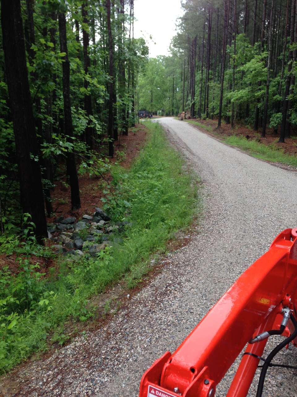

What I am sort of thinking is to use my 3-pt hitch trailer receiver. Could get some 2" square bar to fit in the receiver, and then weld a 2" bar to that which runs off to the side of the tractor like the picture JJ showed. And then weld up something to mount my old push mower on that. It's a Honda that runs well, but the deck is rusted out, so I might need to weld up a basic deck or shield for around the mower blade.
Would be awesome to have top & tilt on my 3-pt hitch for this, but at least manual adjustment of the sidelink could give some adjustment.
Once I finish my barn, I plan to spec this out and see if it's feasible to build. For the price of the DR unit, I can likely buy a new welder and all materials and still come out ahead!

I did a little experimenting today, hanging my Honda mower off to the side of my tractor. I put a pallet on my forks (clamp-on) then nailed on some 2x4s to suspend the mower off to the side about 4 feet out, with a slight angle to match the ditch/shoulder. Amazingly, the mower fired up on the first pull after sitting under my porch for over a year -- those Hondas always seem to start on the first pull even when neglected.
The mowing went very well but one of the worthless clamp-on forks loosened up and caused a busted a 2x4, so I decided to end the experiment there before I wrecked something. But I think this is going to work very well once I build a permanent frame. I am not yet sure if I want to hang the frame off the front loader or the 3-pt hitch. I think I can get a better mount built for the 3-pt, but it was sure easy to see and maneuver with the mower out in front. If I do use the front loader, I would need to figure out how to mount a frame to the front bucket -- not using the clamp on forks.

run it out front ( not off the rear ) due to "flying objects" ( unless you have a cab ) ...
you can chain it to the front of the bucket ... weld 2 sets of U shaped iron to the back of the steel bar ( one in each inside of bucket to slip on the cutting lip ) leave about 6" extending past the side opposite the mower , chain the extra length to the back of the bucket ......
