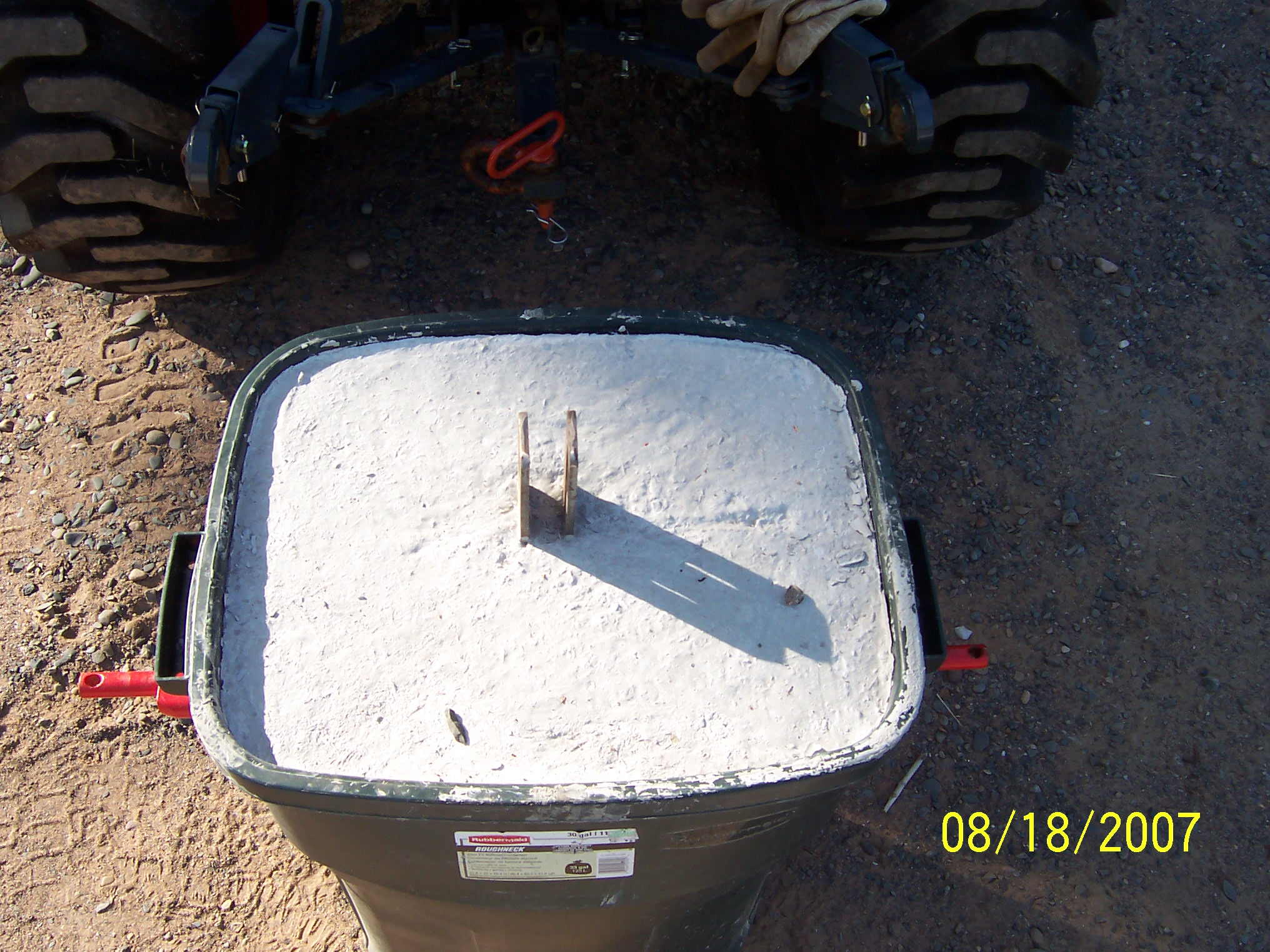

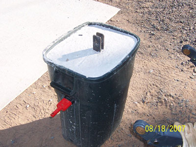

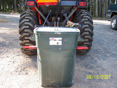

I finally got time to get my ballast box done. Here are some pics. I used a 30 gallon rubbermaid garbage can, a spreader bar, some scrap pieces of rebar, a couple scrap pieces of steel, and filled it up with concrete. It came out to be a 540 lb ballast. 100_5307.jpg

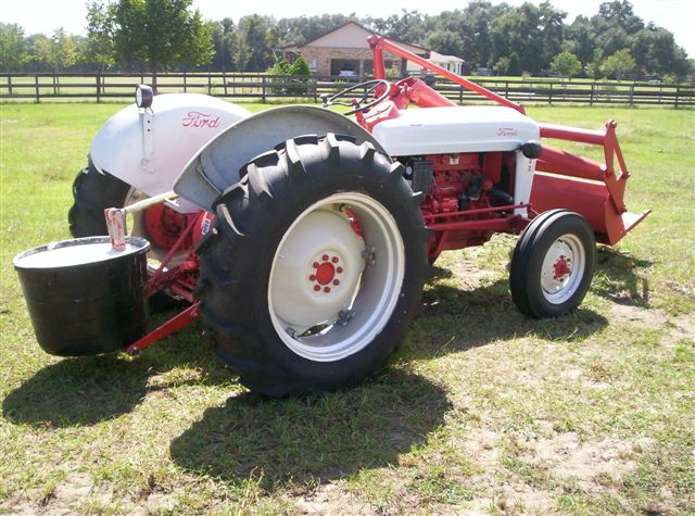

here's my rear weight, on the cheap..
Started out with a used cattle feed tub, cost=free
about 450# bagged concrete, cost = about 15$
An old 3pt drawbar that came with one of my junkers cost= free
bolt and metal stock hardware, cost = free or a few bucks at a hardware store..
I bolted the 3pt drawbar tot he bottom o fthe feed tub using a couple 8" carriage bolts, and wasshers and nuts.. I left the 6" of bolt thread and head sied sticking up into the concrete with the bottom portion of the thread and the nuts actually on the outside.. thus it took 2 nuts per bolt.. one on the inside, and one on the underside.
Set on 3pt and block up to level
add concrete and mix in tub.
Add your scrap iron pieces that have been drilled for a toplink hole. I pinned my pieces to the toplink so they would be spaced correctly, and then set them in the concrete about 6".. thus I proppe dthe toplink up to make correct geometery. I added a welded on bolt on eich piece of iron welded perpendicular to the iron, to give the concrete something to hold on to.
let cure.. and walla.. a 20$ or less weight tub.
As others said.. you can add pvc pipes to it to hold rakes / shovels.. or even conctrete in a reciever hitch toungue.. etc.
If you ever want to ditch it, just run 2 nuts off the bottom and recover your old drawbar and then ditch the concrete plug..

My rubbermaid garabage can cost $12, the spreader bar cost $27, everything else was free. So my ballast cost me under $40, which I thought was great.

The other thing you can do...is spec up a block size that will fit your three point and then stop by your local concrete op and see if he will pour an excess from any of the returning trucks for a modest price...and you could give them a junk spreader bar to put into the block and they normally put a piece of rebar in the top, so they can move them around the yard, which you should be able to hook your top link to...

Thats how I got my concrete free, I dropped off my garbage can one saturday at the local concrete ready mix, and they waited until they had a truck come back with enough left in it to fill it (30 gallons = .15 cy). Then I picked it up the next saturday. Made for a nice 540 lb ballast.
