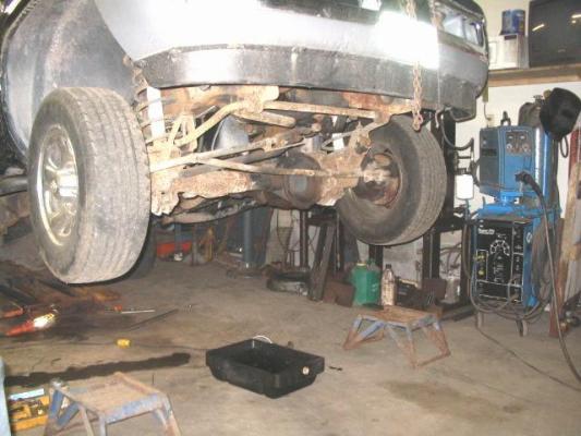

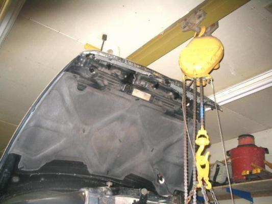

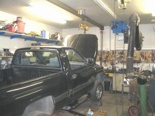

This is what I have, I have lifted more than three ton with this setup

I just hang a chain over a couple of ceiling joists. But I never lift anywhere near capacity, maybe 500-750 pounds maximum.
And then my frontdiff slips of the table and destroyd my roof
