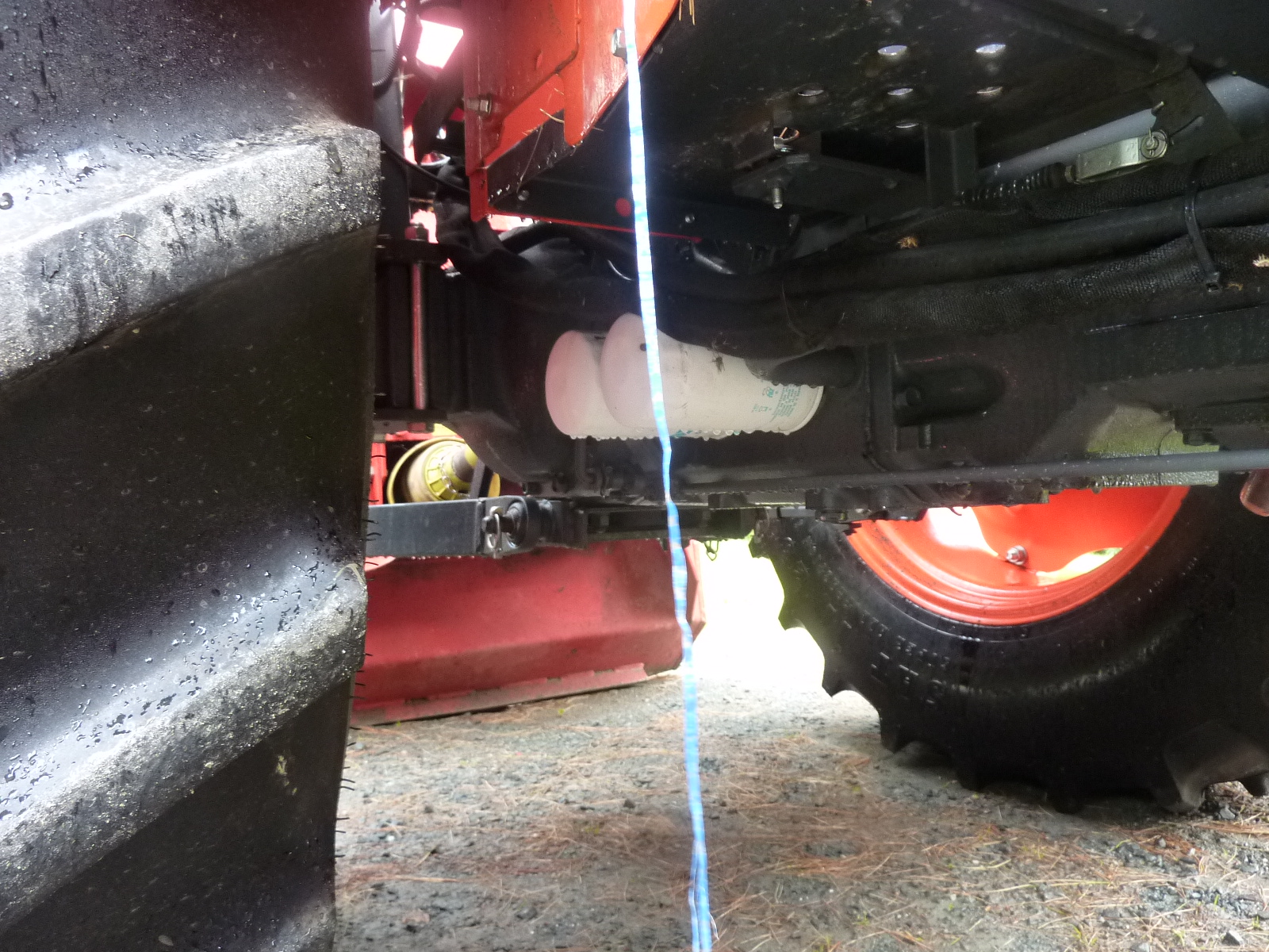

Thanks for the photo. I also went on Specialty Repairs site and viewed a couple of videos. Paul Short (4shorts) was a prolific contributor to this forum up until a couple of years ago. Hopefully the Specialty website means he is doing well.
The battering on the filter indicates to me that you are likely running over brush, stumps, roots, and branches some of which spring upwards when run over and lodge between the filter and frame, fender, or whatever. Paul's device looks like it would deflect such debris and protect against snagging the hydraulic lines that also appear exposed. You could easily spend over $280 in time and aggravation thinking through a design and fabricating it. To sharpshoot a little, I'm not sure if 0.078" (14 ga) is robust enough to be considered a bash plate; the "no step" area is exposed, but you may only mount the tractor frorm the left side. Please re-open the thread after a few months of using the guard to report how well it serves you

Pipe over the filter won't help at all really unless its mounted to the frame or something really well. A PVC or even steel sleeve would just transmit the forces to the filter & bend it just the same. It would help wit puncture damage, but that's not going to be the problem. You need to protect it from impact that will crack the mounting threads or otherwise knock it loose. A skid plate or something solidly mounted to frame or transmission somewhere.

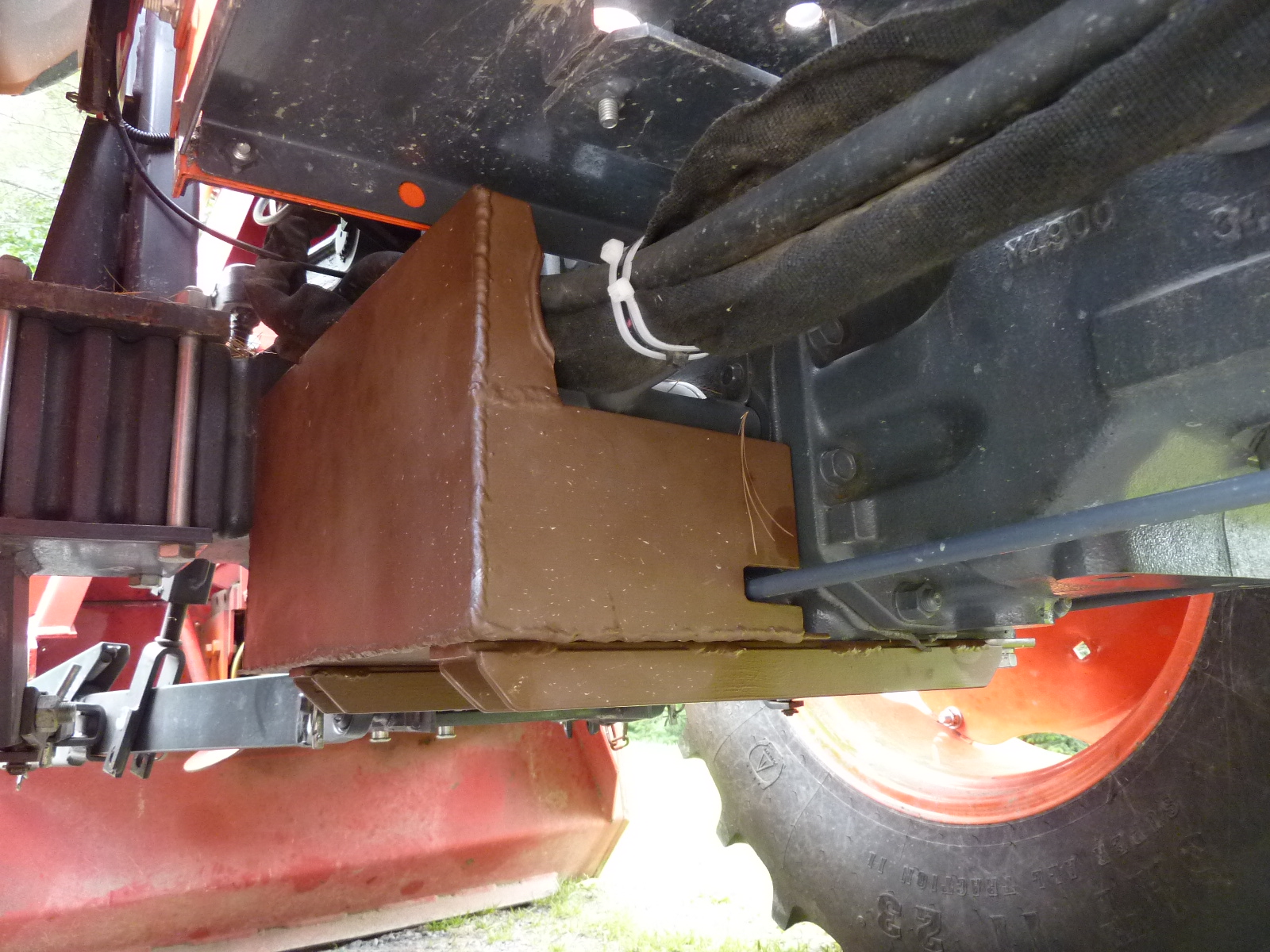

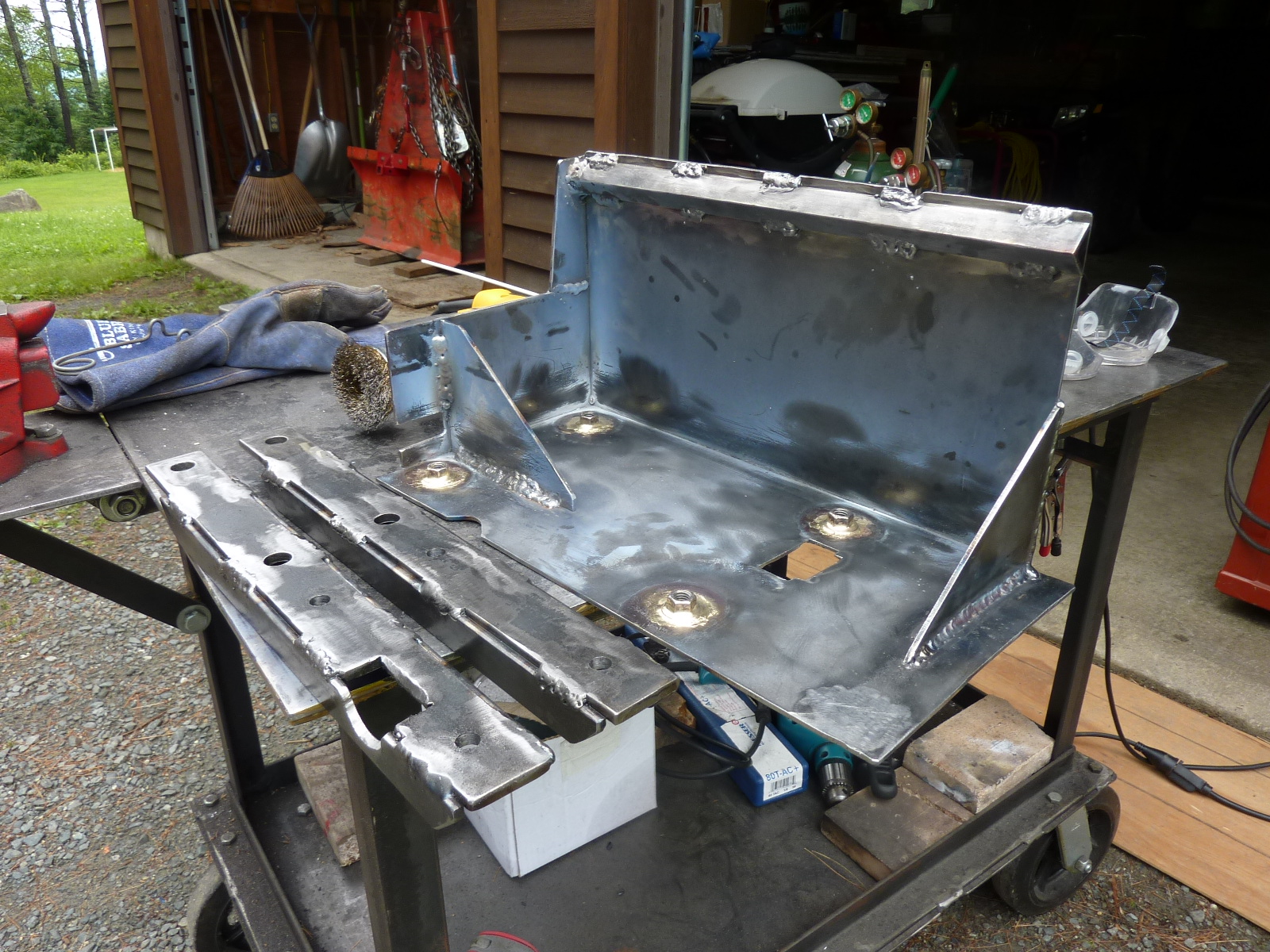

What I did. May be over kill but I use this M5640 in the woods. Comes off by removing the four bolts into unused threaded holes in bottom of transmission
You are spot on. The filters on my 5460 are tucked away fairly nice but the the third function lines are a horrible design. I had a skid fabricated that protects the lines and even provides a little protection for the filters. Photos are included on a thread I started several months ago.

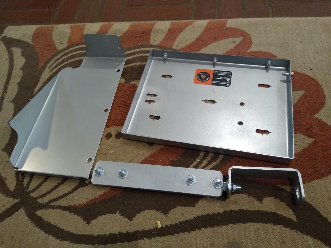

I received the Hydraulic filter and FEL line shield within 7 business days of ordering. It came from Canada and price is $280 including shipping and tax.
Took about 2 hrs to fit pieces on tractor, mark the two drill holes, drill holes and mount shield.
The drawing shows the pieces as they should be installed. The bolts on part 4 will be the holes you will mark and drill.

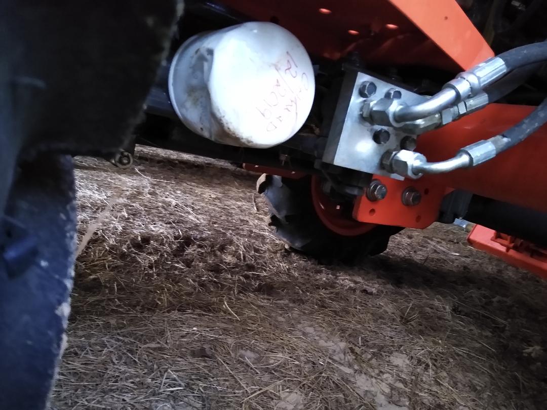

I got mine 2 weeks or so ago from Specialty Repairs. Took me maybe an hour or so to almost mount it. Got it to the point where I drilled the 1 hole that you need drilled. I then removed it to pain the raw steel on the hole. I promptly realized the skid plate was covered in oil. Apparently I was a fair bit more tardy in getting it ordered & installed than i should have been. It should be about 20 odd minutes to reinstall after i debug & replace the leaky hose or fitting. I have faith that skidplate will prevent a future reoccurrence even if I hit a rock or stump with it.
The shield for the loader QDs is quicker to put on. It's also a lot lighter. I did have to spend 5 minutes with my belt sander making a divot in a bracket & 2 minutes with a quick respray of that spot. It looks like my QDs were a hair different in their mounting alignment than the ones they designed for. The skid plate is a plate I could beat on with a hammer & not dent. The QD shield is probably about as thick as the hood. Enough to prevent things from generally messing with the QDs & hoses, but not serious forestry class armor.
I'd get the skid plate again in a heartbeat. Probably get the QD shield too, but not as sure as I am on the skid plate.
