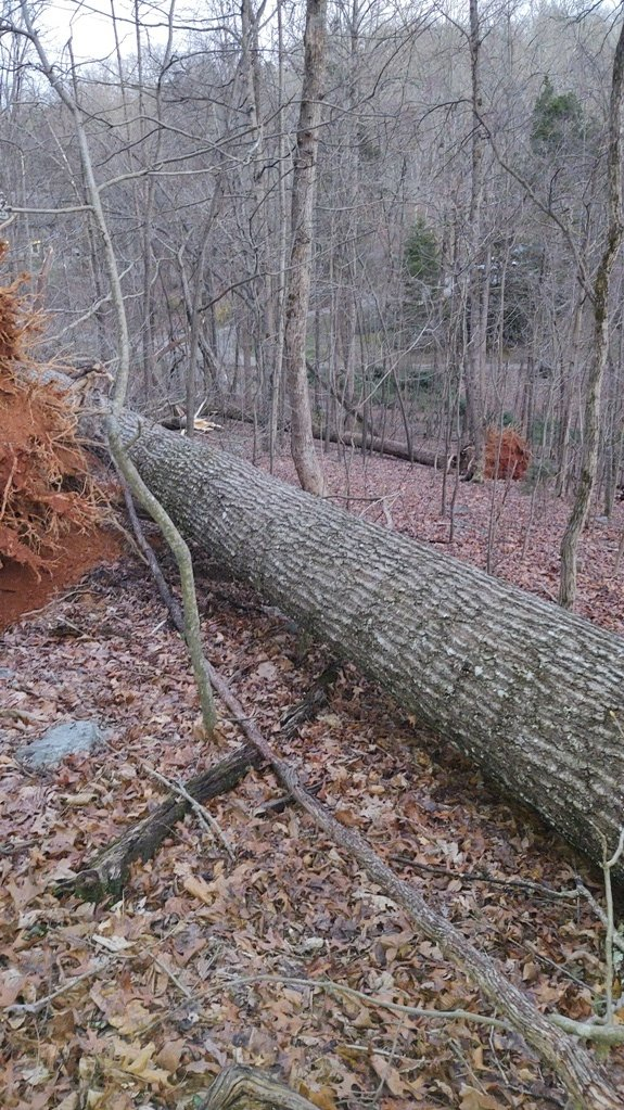

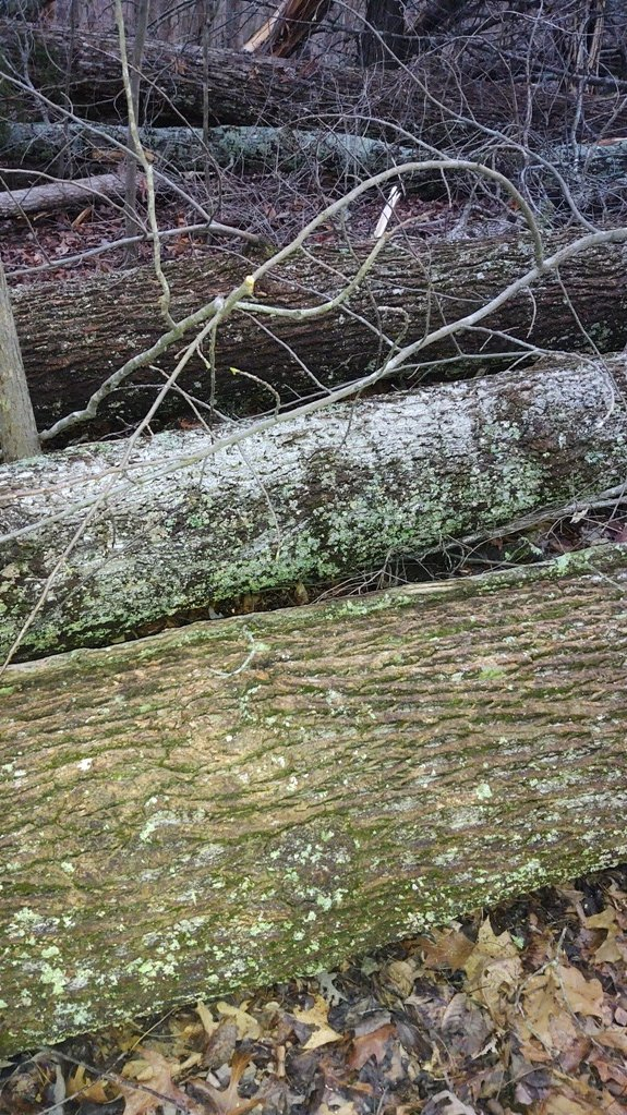

Though this is another 'tree' question, it's totally different than the one about the (presumed Oak) standing tree I had other day (which by the way, I was NOT anticipating taking down, unless it might be dying)
Yesterday's storm dropped maybe 10 trees in the woods. These are BIG, tall trees. I'm guessing (via leaves in general on the ground) that these are red-oak. I am pretty sure one of them (not sure if it made this picture) is a Poplar tree as one of the branches ripped open and I can see the greenish tinge in the wood.
These fell much like dominos. High up on hill.... one/two fell... landed on neighbor and was enough to push it over....landed on neighbor...
My question is via bark (no tree had any leaves left in the canopy)
Presuming these to be primarily red oak.... AND....that the wife wants to build a detached garage AND a 'greenhouse', this has me wondering. Rather than have these cut up for firewood.... would this type lumber be a good lumber to use for a garage. Or, maybe a cross beam in a greenhouse. I saw them after they fell and the storm passed.... I immediatly thought 'gee... I see a lot of 1x? boards in there so I can make some oak boxes or something... then I realize where on earth are we going to store 10 trees worth of lumber! Which got me thinking, instead of buying lumber for garage.... maybe have this cut into two inch by four inch (verses 1 3/4 x 3 3/4 boards) and now for the cost of milling, the garage can be framed in (again, what I presume to be) red oak.
Question is.... is that a worthwhile way to look at it or are there pitfalls using oak that I'm not thinking about? I might add they are very straight as you can see.

The top picture has five trees, next to each other. Those are what I'm wondering what type of tree are they?

I would say I see red and white oak there and one either Ash or Elm but I'm wrong all the time and picture alone are not easy to identify for me.

I'm certainly no tree expert, but the one closest in your first picture looks almost like a ash as the bark is woven like a hamock. the others sure do look like red oak. If you cut a 3-4" branch off I think you'll be able to tell for sure about if they are red oak.
No matter if its oak, popular or ash it will make good lumber, the oak will be the hardest and most rot resistant and you certaintly do have a buch in thoes down trees.

The second pic sure looks like a red oak.

1st picture poplar-basswood-ash
keep in mind I am not familiar with the kind of trees growing in your area
2nd picture is definitely northern red oak, no doubt about this one

As a forester who has worked my entire career in western conifer forests, I could certainly be wrong, but I’m going to say that the first photo is an oak or hickory species, and the last photo is a poplar species.
