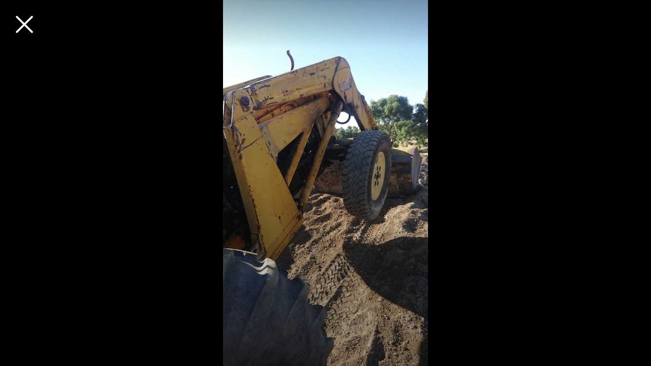

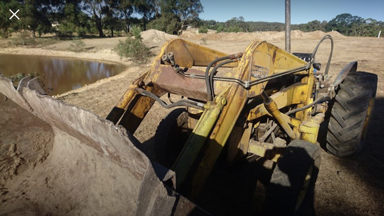

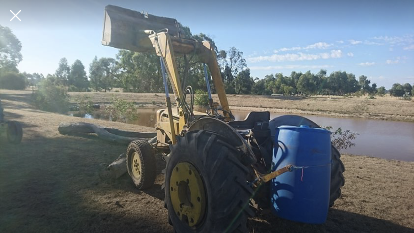

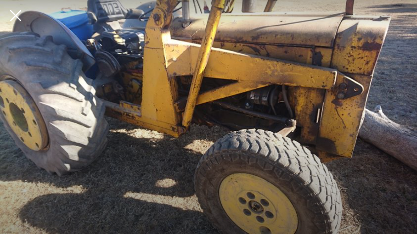

Image uploaded from iOS (13).pngImage uploaded from iOS (5).pngImage uploaded from iOS (6).pngImage uploaded from iOS (7).pngImage uploaded from iOS (9).pngImage uploaded from iOS (10).pngImage uploaded from iOS (11).pngImage uploaded from iOS (12).pngImage uploaded from iOS (4).png
/ Identifying an MF40 industrial loader
OK - So it's a 205mkII!

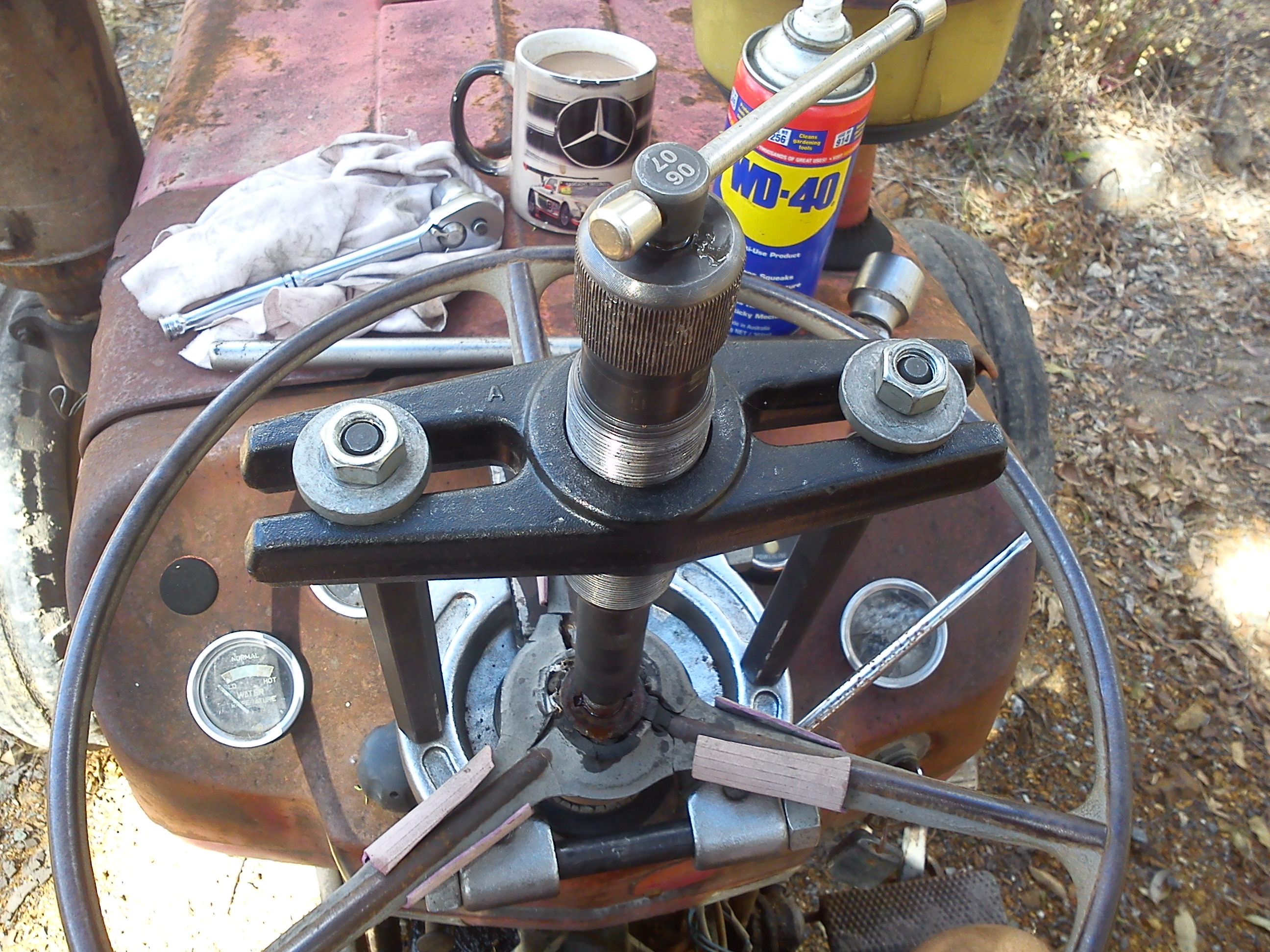

Sort out the power steering issue - I have to reseal everything there yet too. It isn't rocket science - the most difficult part I'm told is removing the steering wheel. Loosen the acorn nut and soak the tapered spline with diesel, CRC or similar for SEVERAL days. Then use a substantial puller - here's how I removed a couple:

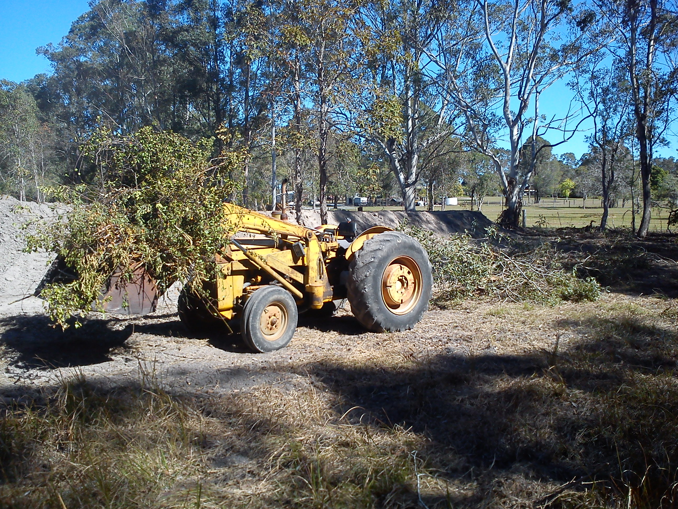

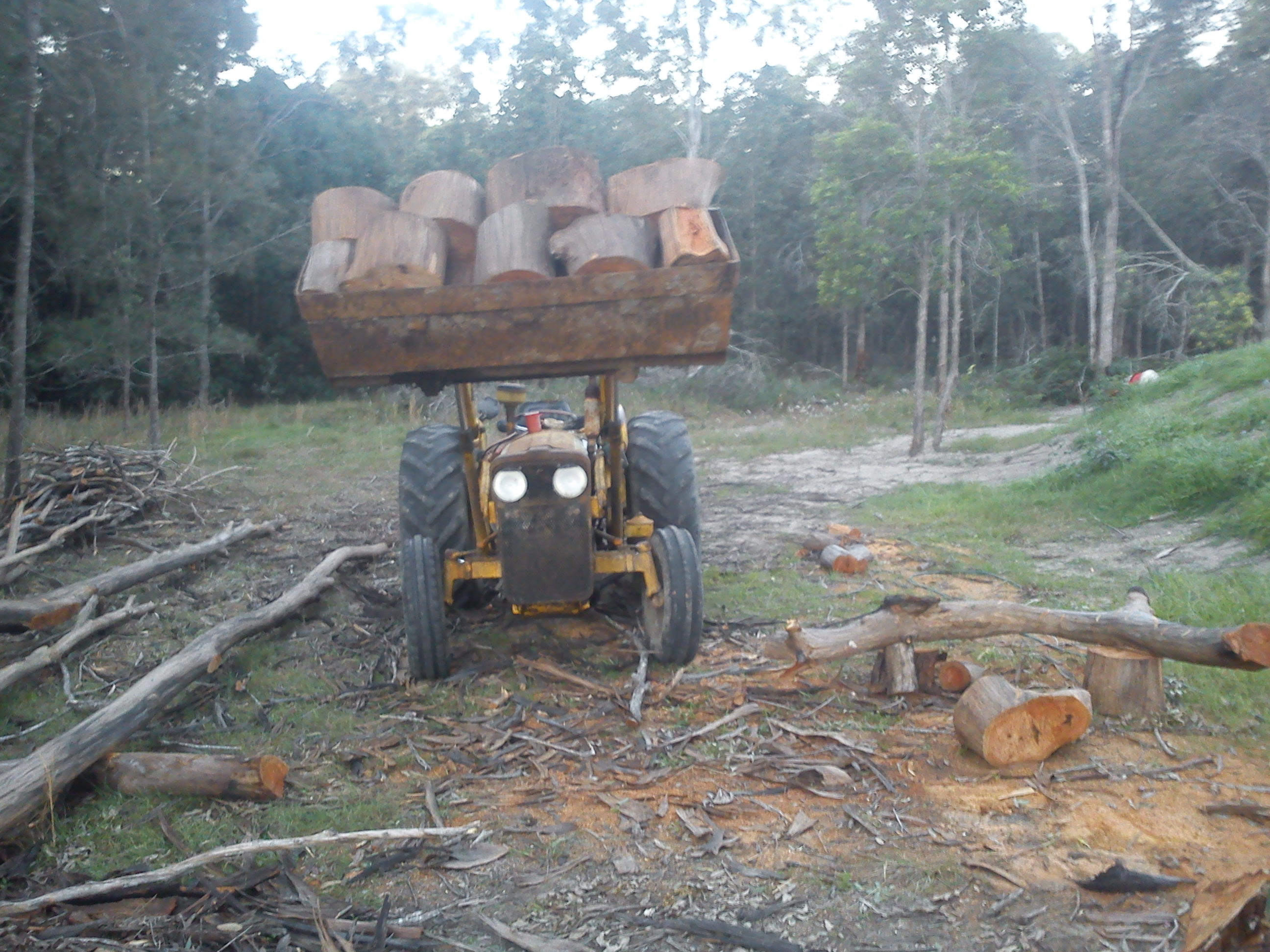

First thing I did was make a grille to protect the radiator - yours needs one too.
When purchased: :eek:
Working; :)
Here's a better view of grille pieces ... and headlamps: :thumbsup:

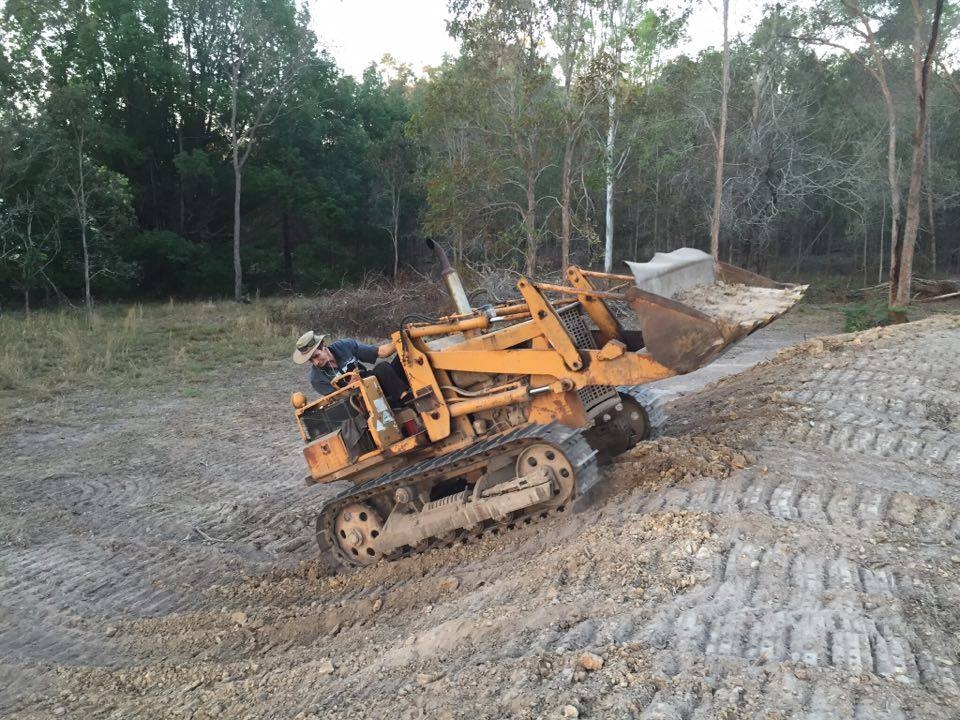

Very jealous of the little Drott in the background of one of those shots too..
/ Identifying an MF40 industrial loader #8
Yes, that's the best option - to keep the TEA as well. It's a lighter and more nimble tractor, and more appropriate for those jobs. There's no sense in using a mallet to swat a fly! :laughing: The industrials - especially if there's a backhoe with that loader - are worth good money if they've been maintained and kept reliable. That's because they're tough, capable and reliable. :thumbsup: I used my loader and 135 quite a bit building another dam here, but the drott you referred to was borrowed to help with the job. It's only about 60HP and around 5 tons, but so very good for the heavier digging, as well as for tramping down the soil and clay to form a reliable wall.
