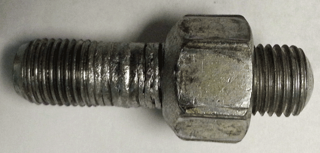

There is no "end of the thread" on these studs. They are right-hand threaded 14 mm X 1.5 mm the full 57 mm length (photo attached). There is no apparent thread difference from hub-end to lug-nut-end. The lug-nut end is a nicely formed hemisphere and the hub-end is squared off. Maybe the studs have (had?) a taper, like pipe-threads, on the hub end.
I ran a 14 X 1.5 tap through the hub to minimize the chance for galling on re-install. The Threads are definitely right-hand 14 X 1.5, and not tapered to hold the stud that way.

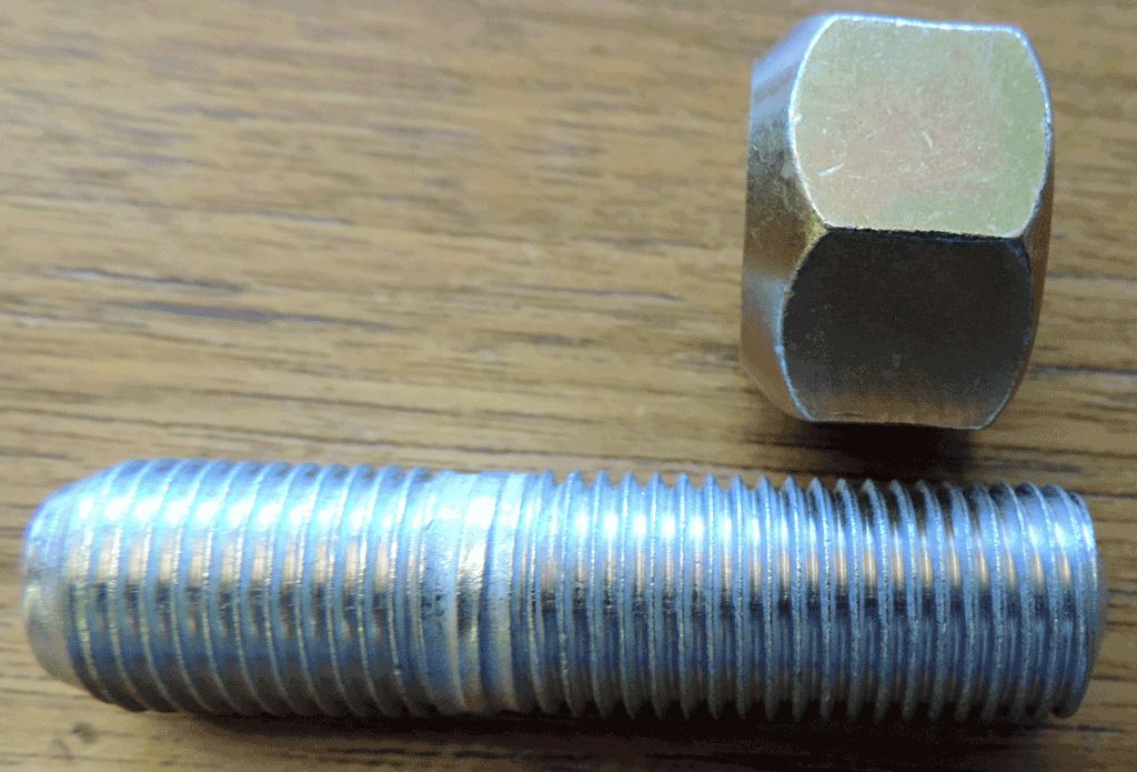

Re: Idiot needs help recovering from ruined front wheel - FIXED!
The wheel exchange went very smoothly and was much less expensive at the Les Schwab dealership than it would have at a Kubota dealership. The new wheel cost $109. Just that part would have been over $250 at the dealership.
Les Schwab assumed incorrectly that they would have the six studs in stock, and discovered that they did not when it would have been Friday before they would receive them. I therefore drove to a Kubota dealer to buy both studs and lug nuts. The six studs and six nuts cost over $60.
The attached photo of the new stud and nut demonstrate what probably happened. The un-threaded part was not apparent on the ruined studs I removed from the hub, so I thought there was nothing to stop or retain the stud in the hub. As you can see from the new part, there is a full-diameter and un-threaded place between what threads into the hub and the part the lug nut threads onto. I'm guessing that the Kubota factory or the Kubota dealer, whoever first installed the studs, did not properly torque or did not apply locking compound to the stud.

Well, you've probably done this job by now, but anyway... I think M14 is too large for blue Loctite (# 242) to be effective.
I would use red (#271). If you need to dissassemble in the future, brute force would get 'er done. Or you could heat the stud with a heat gun or torch for a few minutes and it would easily come apart.
Thanks for the tip. I will remember to consider the fastener size in the future.
Unfortunately, you are correct, I have done it with blue. I really drove the un-threaded part of the stud into the hub. I also put a little anti-seize on the lug nut end of the stud so removing the nuts will have less tendency to unseat the stud from the hub. I have a feeling that the stud will hold in the hub, and you can bet I will keep a more critical eye on all the fasteners.
