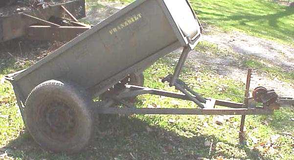

How about a worm gear boat winch. Under $100, 3000lb rating, and they dont free-wheel when you let go. Crank it up, crank it down. Use a scissor lift under the body to multiply the 3000 lbs to whatever you need for your load, and mount the winch at the front. No need for diffs, brakes, all that stuff. Sure you gotta crank by hand, but it's not going to be hard.
Someone posted a picture a while ago of a trailer he made with a boat winch on the front. Looked like an oil tank on wheels. I don't recall whose it was, but I'll attach it here for reference. I'm planning on flattering him by copying it, hence my having saved the picture.
