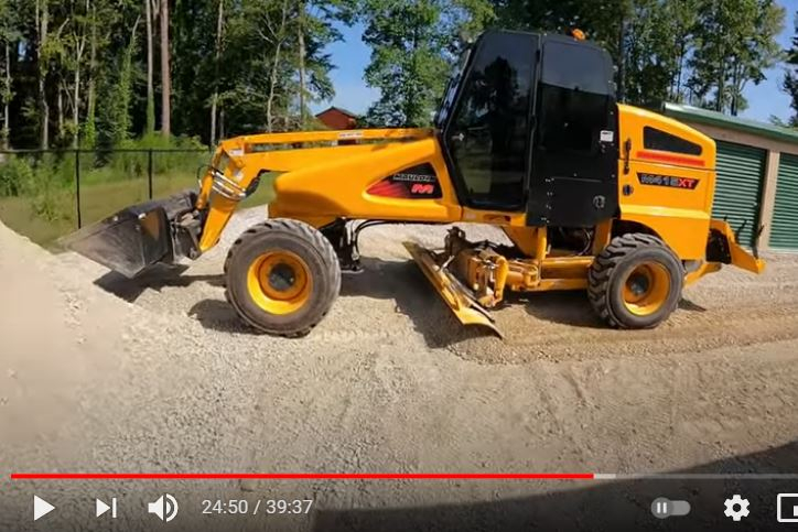

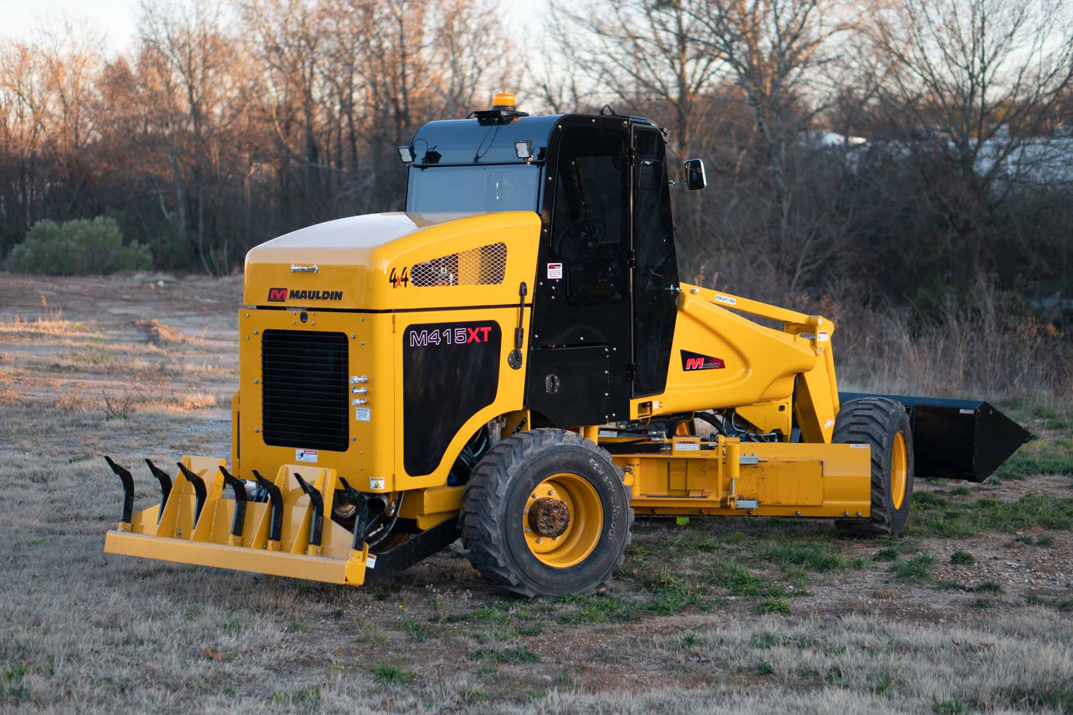

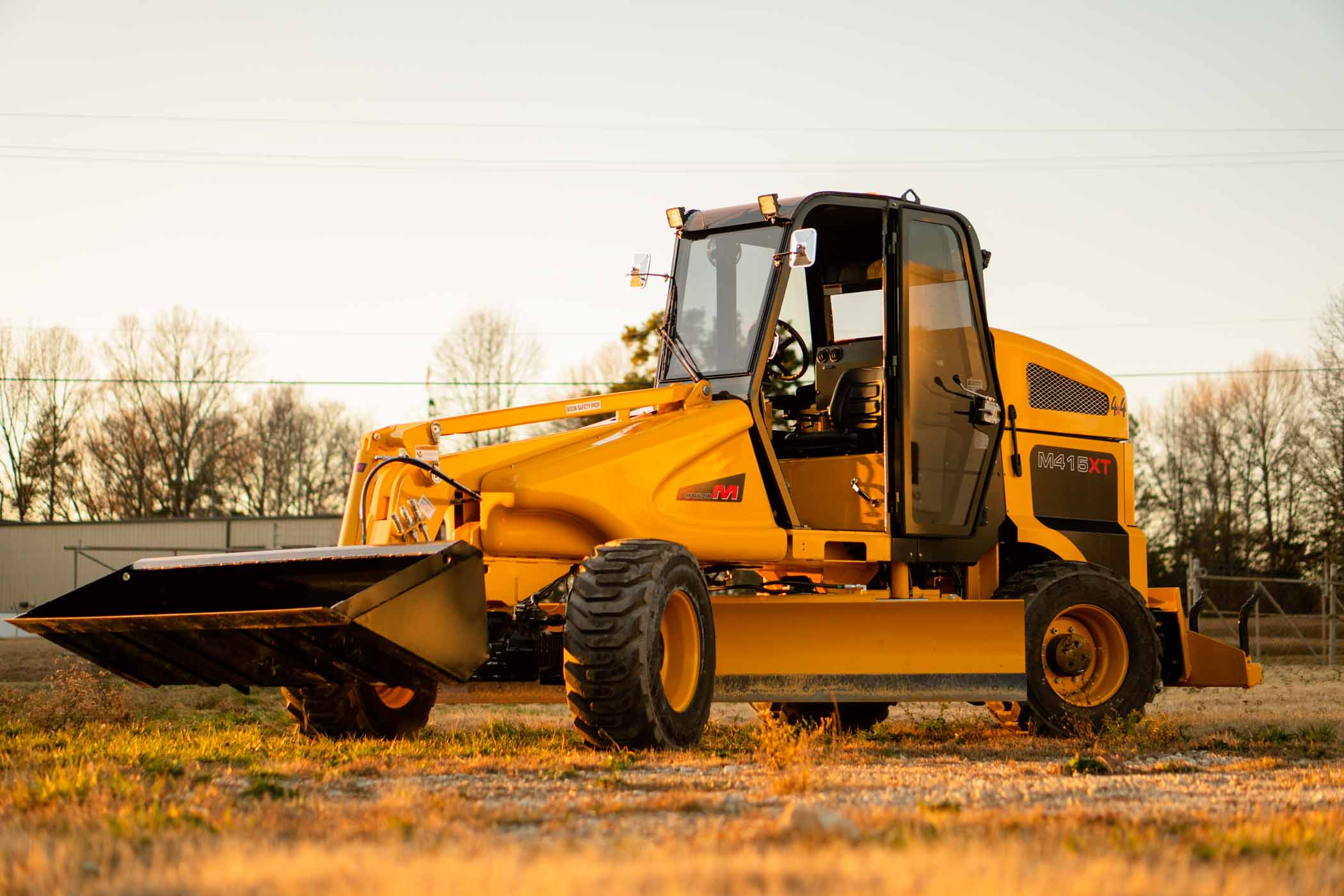

I know nothing about grading but can drive a tractor. If I Only Buy One Piece of Equiptment to fix/maintain this lot, what would you recommend?
Check this out:
