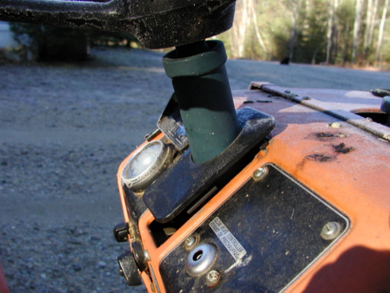

This is a picture of the sttering column. You can see, that for the rubber boot to fit properly, the steering column needs to come down. I haven't done any looking into this yet. Any ideas ?

Mark usually it is the dash that needs to be bent up. That is typical on those models as the dash is not very ridgid.

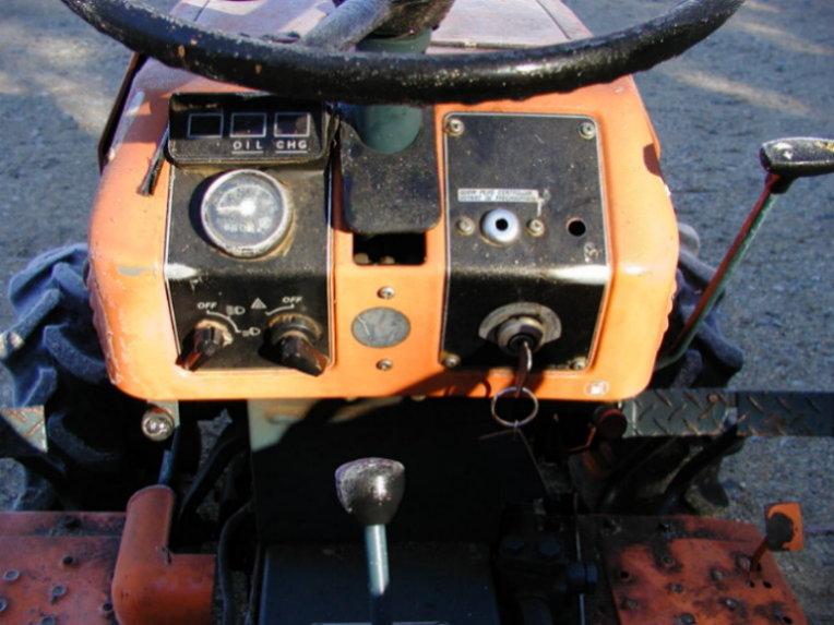

This picture is of the dash. Some of the items are of course very obvious as to what they do. At the bottom corner(s) of the dash there are a black knob (left) and a red knob (right)
the knob on the right has a lable above it that show a fuel pump with line through it. I assume this is the fuel shut off control and is used to shut the engine down.
So what is the black one for ? If I pull it, it also will shut the engine down. the head of the knob itself has a symbol on it, but I can't make it out.
To the right of the steering column there is 2 holes. 1 is labeled for the "glo plug" and if you hold the key to the left long enough, a glow starts to appear inside the hole. Is there supposed to some kind of a lense etc. over this hole. And does this slow glow thing sound like normal operating?
AND, what is the 2nd hole (to the right) for ?

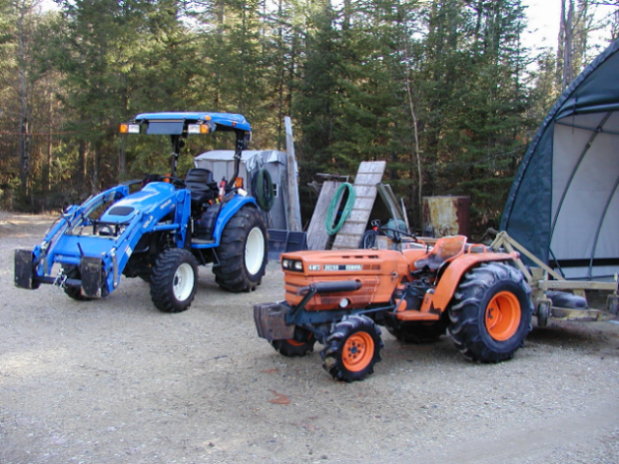

This picture is of the engine and exhaust with hood open with tractor running

Mutt & Jeff /forums/images/graemlins/laugh.gif Love at first sight !!

A few notes from skimming my manual...
DT = Dual Traction[4wd]
ID plate, as you found, is on the left side tranny.
Serial number is on right side tranny, near top
Engine serial number is on right side engine near top front
Engine is 19hp, 0.927l 3-cyl
PTO is 16hp
Ag tire size is 12.4-16 rear, 6-12 front
She is 106" long, 53" wide, and 75" tall with exhaust upright(I turned mine down flat).
She weighs 1565lbs
In top gear high range, you can go 11.62mph!
2600rpm on the engine gives full 540rpm on PTO
The engine only holds 3.3qts of 10-30w oil. Tranny/hydraulic is a whopping 19qts.
Thew red knob at the bottom right of dash kills it. The black knob at the bottom left is a compression release

The knob on the right is the fuel shut off.
The one on the left is a decompresion knob. It opens exhaust the valves.
The glow indicator sounds like it is working right. There is no cover for it.
I think the other hole was for an optional horn button.

Thanks, that info helps and is a comfort to know. Other then a good cleaning there will be less parts to buy.
