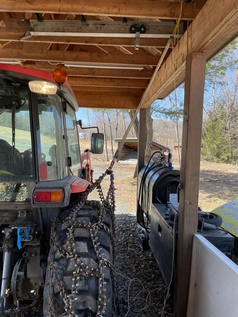

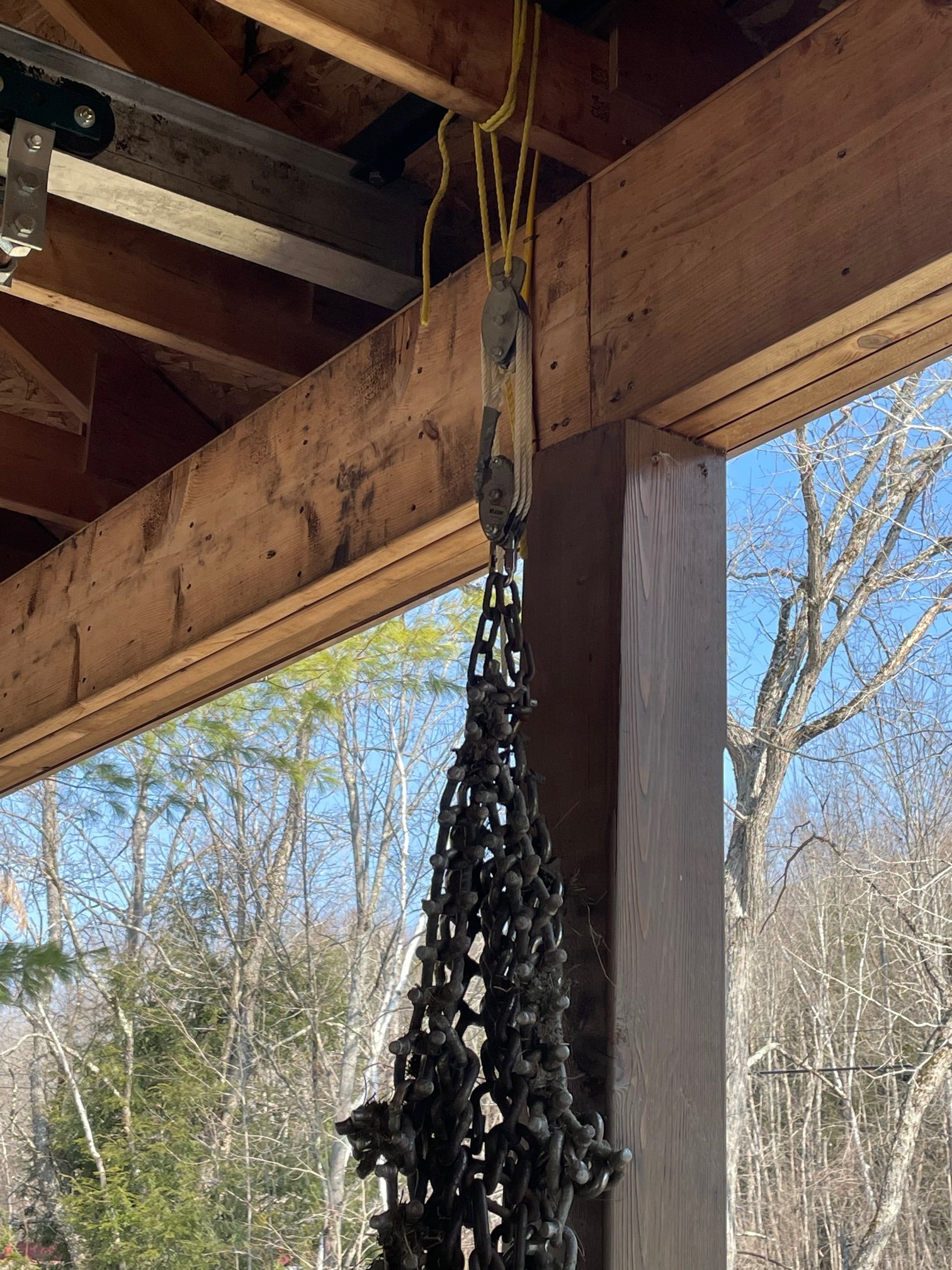

For a few years I struggled with putting the rear chains on my Kubota 5240. Not having help, or a crane, or another tractor with a loader didn't help the situation. Finally I came up with this simple method. It does demand a barn, garage or other structure for your tractor. It works fabulously for both removing them in the spring and putting them on in the fall.
I rigged a multipart block and tackle just adjacent to the rear wheels, and hook it on the midpoint of the chains. You can also use a chain fall or other hoisting device. You first roll forward to undo the shackles then rearwards to not have the chains under the wheel. Hoist away. I can put each chain on or take it off in 10 minutes or so. Used to take me three times that (and with a heck of a lot more effort).
Finally, it's a great way to store the chains for the summer.

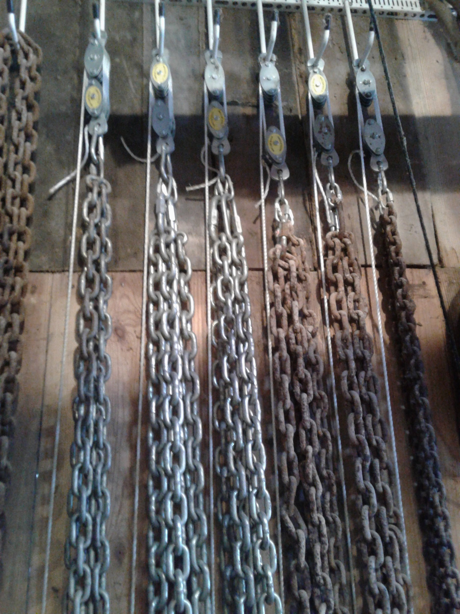

Also good for log chain storage. Place hooks together, strech out chain to find center. Then walk hooks back to center. Opposite ends are the 1/4 and 3/4 points. Install quick links here for the hoist lift points.
