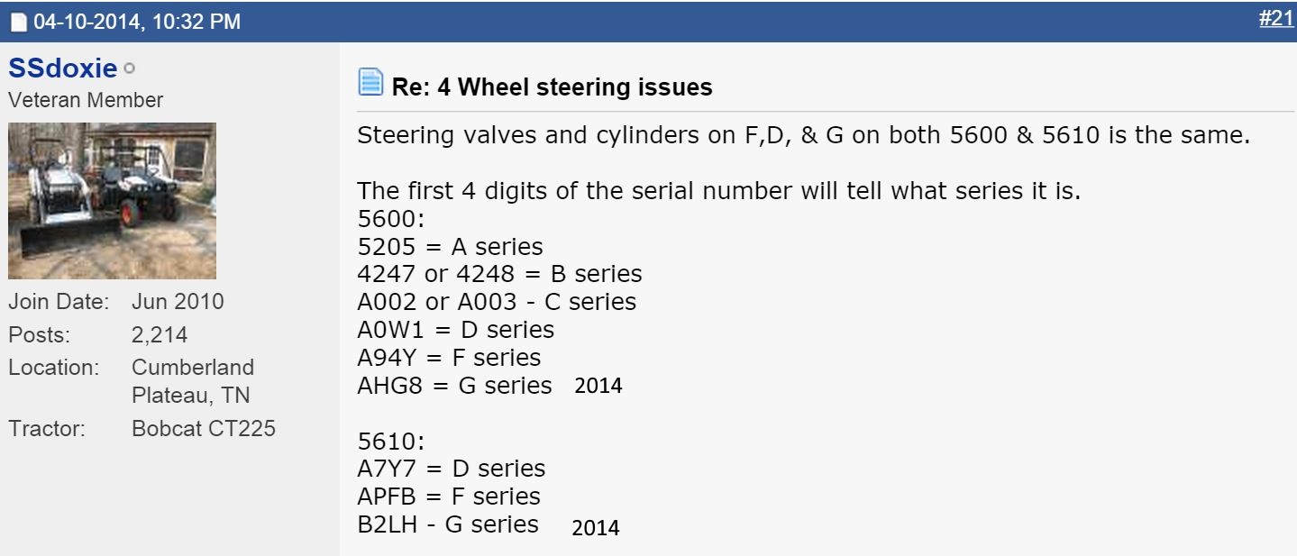

The F Series is the same, the wheels won't turn because the brakes are on. The brakes are released by hydraulic pressure after the motor starts.
What Series is yours?
