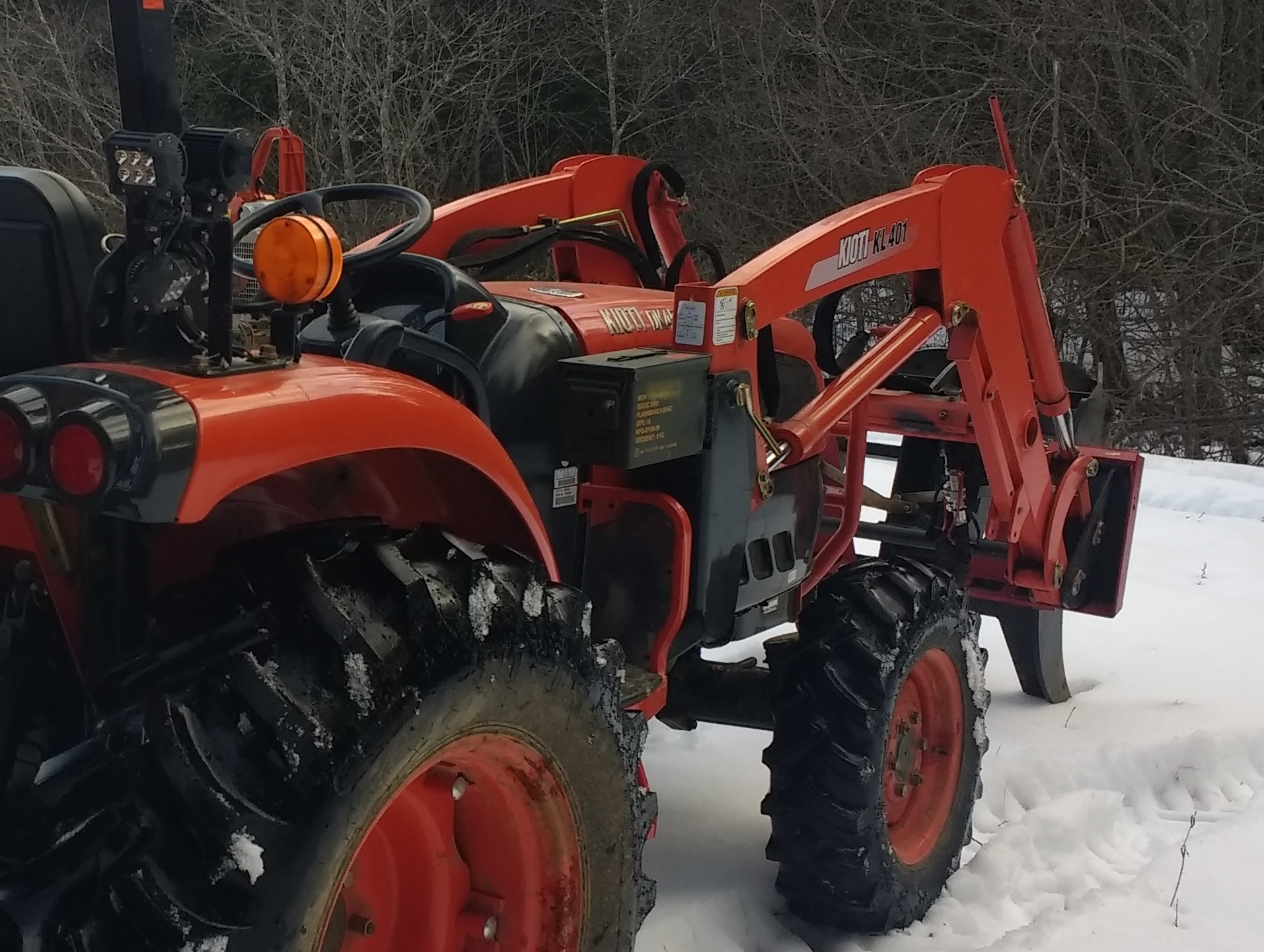

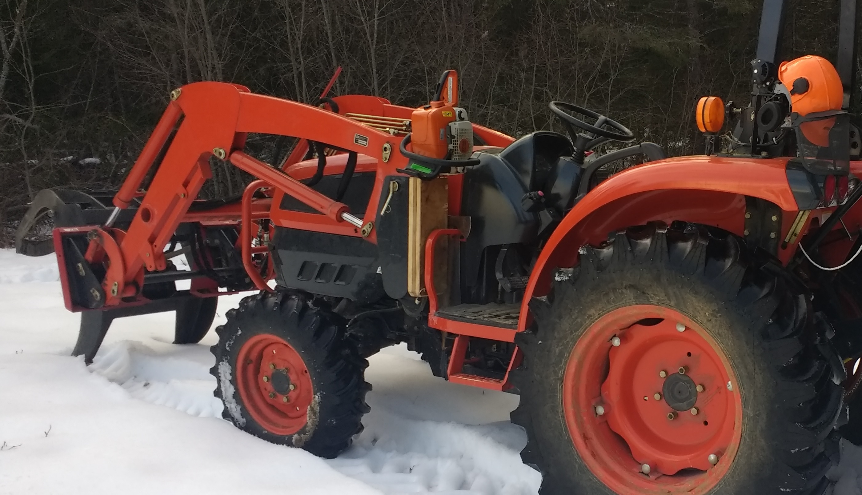

I have the same basic setup as you. Sundown GR40 grapple and Igland 3501. Since we no longer have the bucket attached, how do you carry your chainsaw(s), gas, oil, and other assorted logging equipment into the woods with you?

I ran with a few ideas based off things I've seen. The photos below show you where I've built in a chainsaw holdster and a tool box for things like Files, Wedges, Extra saw chains, ect. Both the Holdster and Ammo/Toolbox are quickly removable and lift right off. On the box, I just welded on sort of a flat hook that just slides over that part of the FEL cradle, Similar for the chainsaw Holder.
Gas and oil cans have been sort of a "toss anywhere" kind of thing. Might do something about that too.
Now I'm not perfectly happy with these solutions just yet, but great working prototypes in the mean time, and a great utilization of prime realestate that would otherwise be wasted.

A couple of good ideas there. How did you fasten the saw scabbard in place? Unfortunately, I can't compare the picture to my tractor at the moment because it is in Maine and I am in New Jersey.
And the ammo box is just welded on to the frame?

I'd take a photo of how the saw and tool box are attached if I was on site, but I'm away currently. Neither are welded on, I've fabricated sort of a fork on the back of the toolbox and saw holder that just forks onto the back of the front end loader cradle. They can be lifted right off whenever needed.
