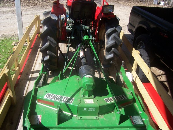

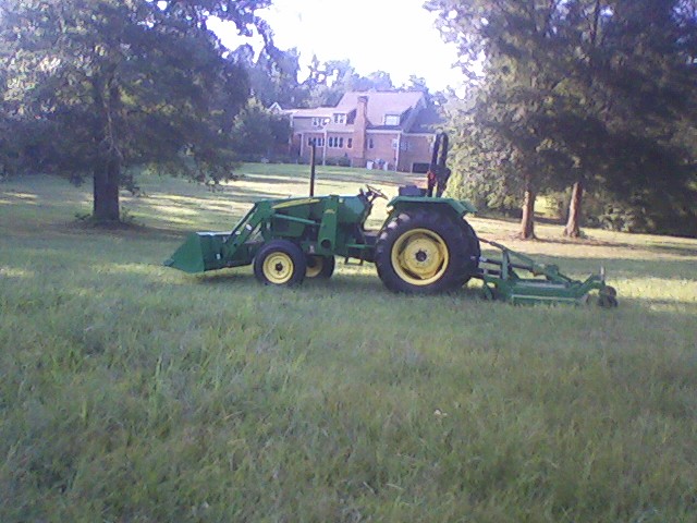

If I have to do any brush cutting I use a 7'BH with a JD 5103.:thumbsup: My Ym2000 Which when I found out it was basicly the US. JD.Ym240 is why I even bothered to look at them. Found mine and bought it. Seen and looked at a couple of 240's and new it would work with the Woods/Frontier FM but both were in rough condition. I knew over the yrs. I do to much for Lawn mowers even use a JD with a Kohler that stays in the Shop. That or "Garden Tractor" and way to much for a Zero turn. I get to watch my neighbor get beat to death on his :laughing: They're great for a Sub.Div. Lot. IMO. Also let me add that now with both Tractors with FM's never even use the BH but Rarely The mashino is actually set up similar to a BH with the blades on a Pin when your in the rough stuff.
