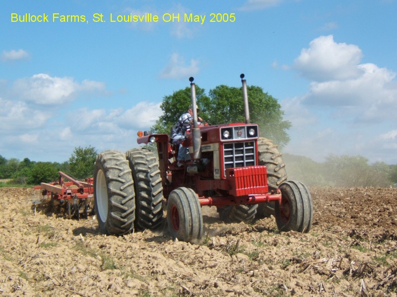

Here is a photo of a 1468 that was on Red Power about a year ago.

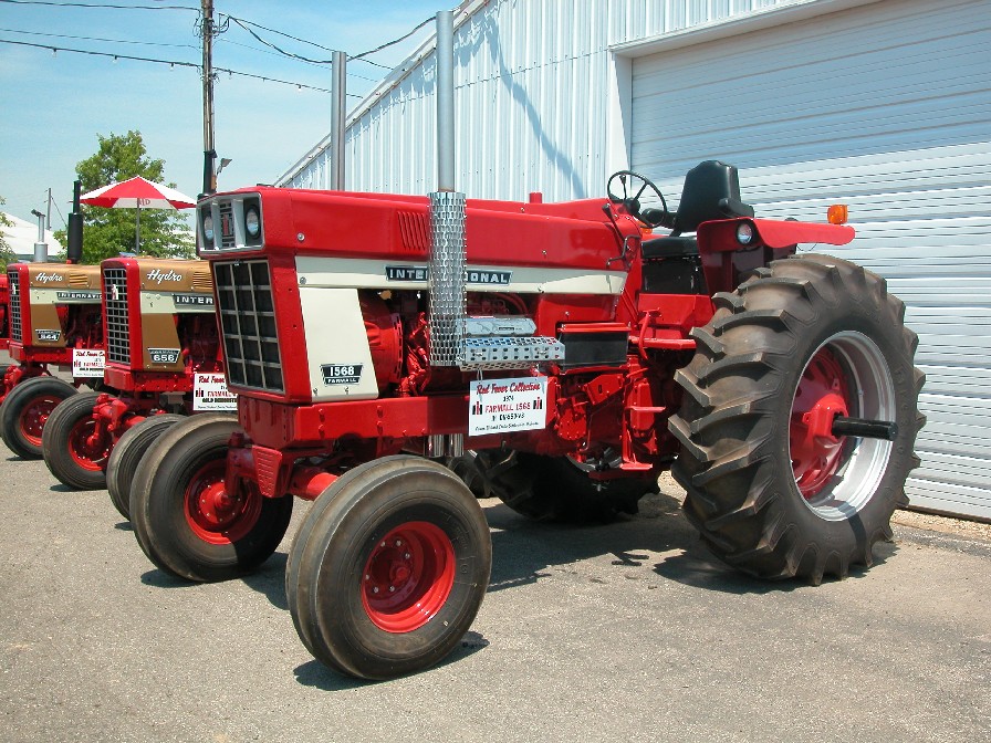

As I recall, there was a twin-turbo 1468 that was at the 2005 Red Power Roundup in Bloomsburg, PA. The owner put it to the test during the tractor pull. It produced some nice black smoke and some nice noises. I wish that I can find my photos of it.
I attached another photo of an IH 8-banger that was at 2006 Red Power Roundup in Mansfield. The tractor in the photo is the bigger 1568, owned by Richard Lantis. I do not believe that a nicer 1568 can be found.
