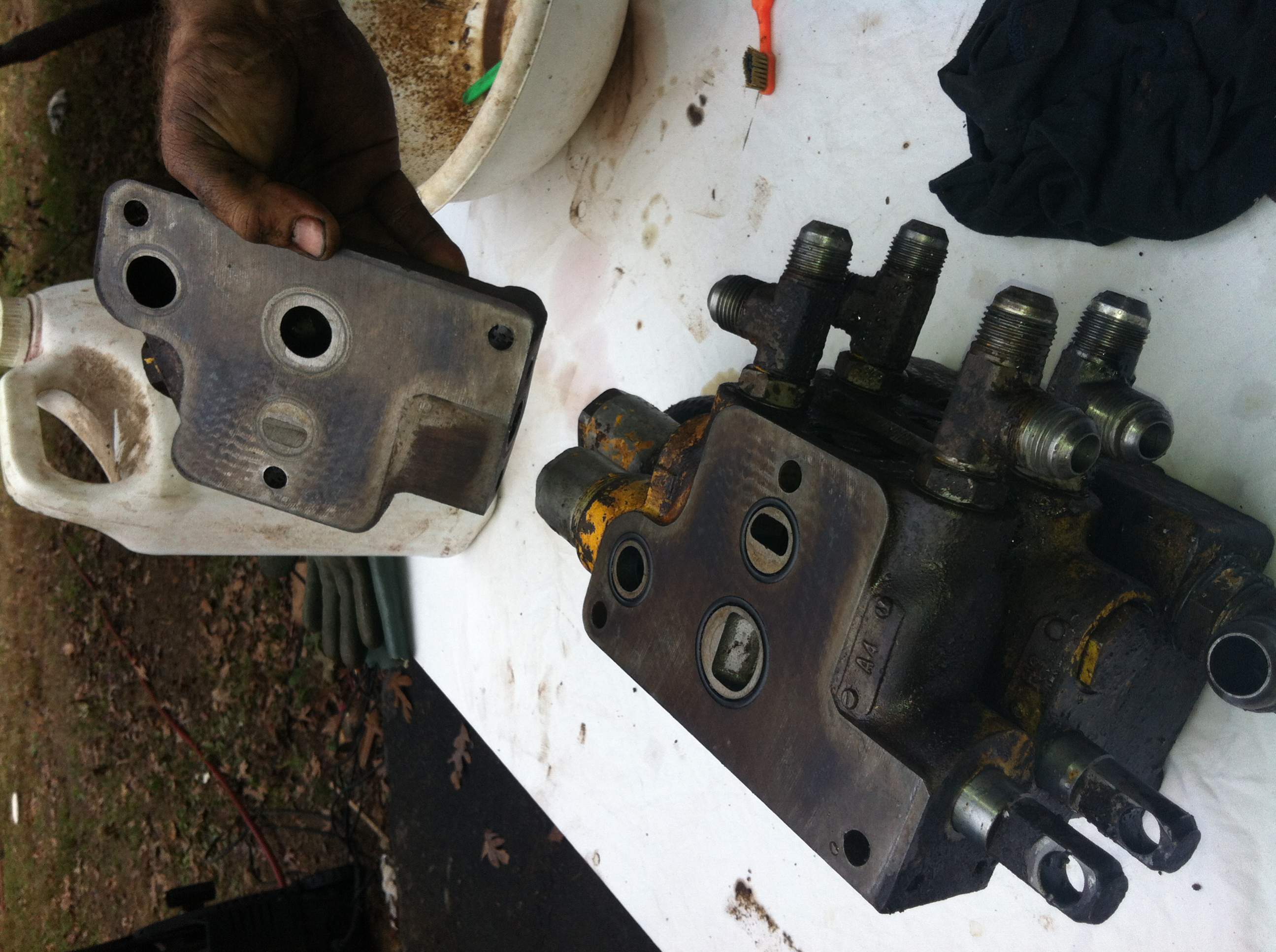

Disassembly of the FRONT valve bank..
Here is the first plate taken off the assymbly.. The only thing I have to say here is that my Orings were hard and flat.. I used Nitril Orings as replacements and hopefully they will not deteriorate over time.. I replaced these from a pack of nitril Orings I had.. At the time I did not have part numbers for originals and the standard size Orings seem to fit pretty well as in thickness and size.. When you go to put your stack back in be sure to use something to "stick" the orings in place as they like to fall out and its hard or impossible to tell if thats happend cause things are so heavy awkward when putting the bank back in.. I used a little grease.

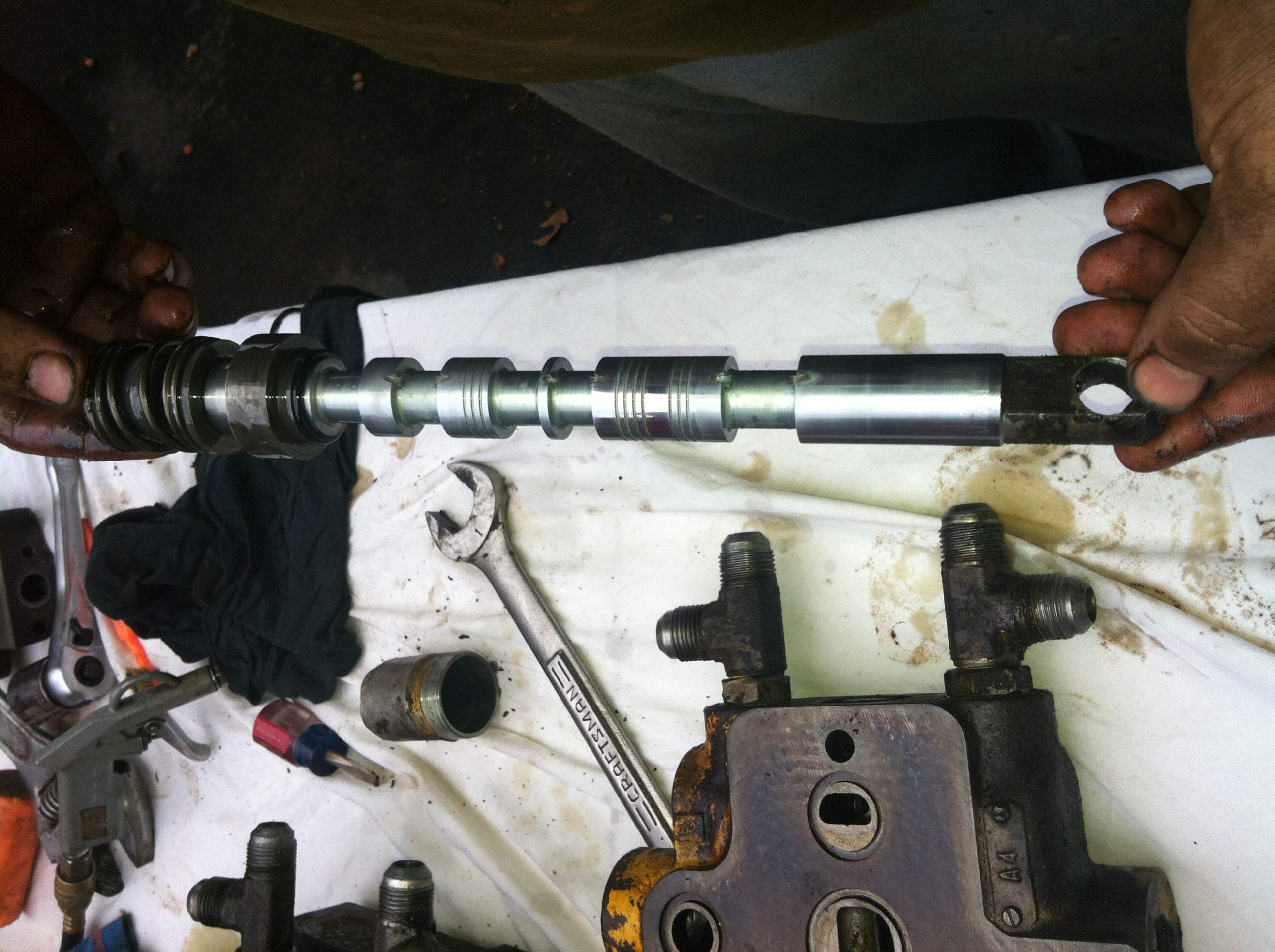

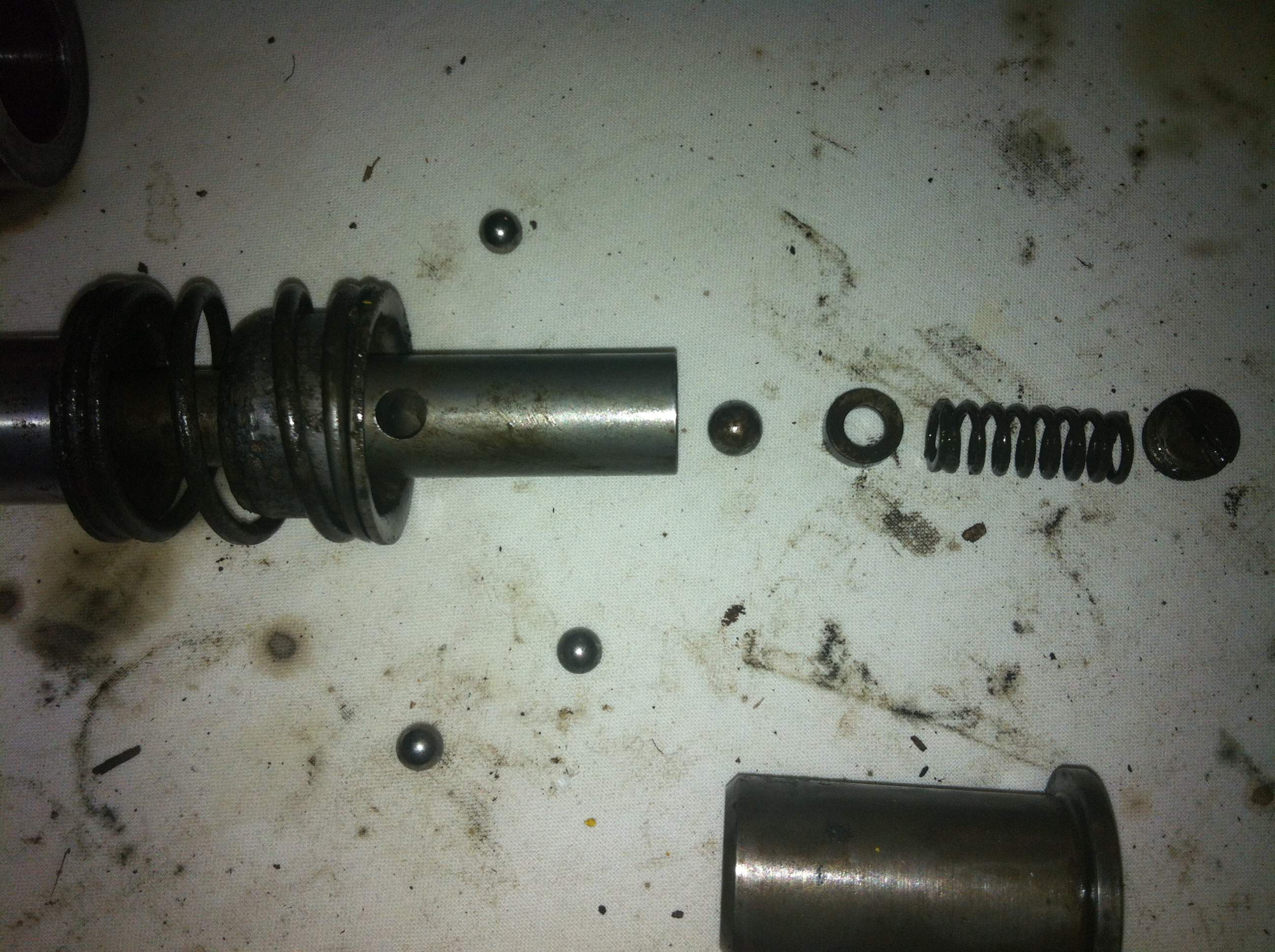

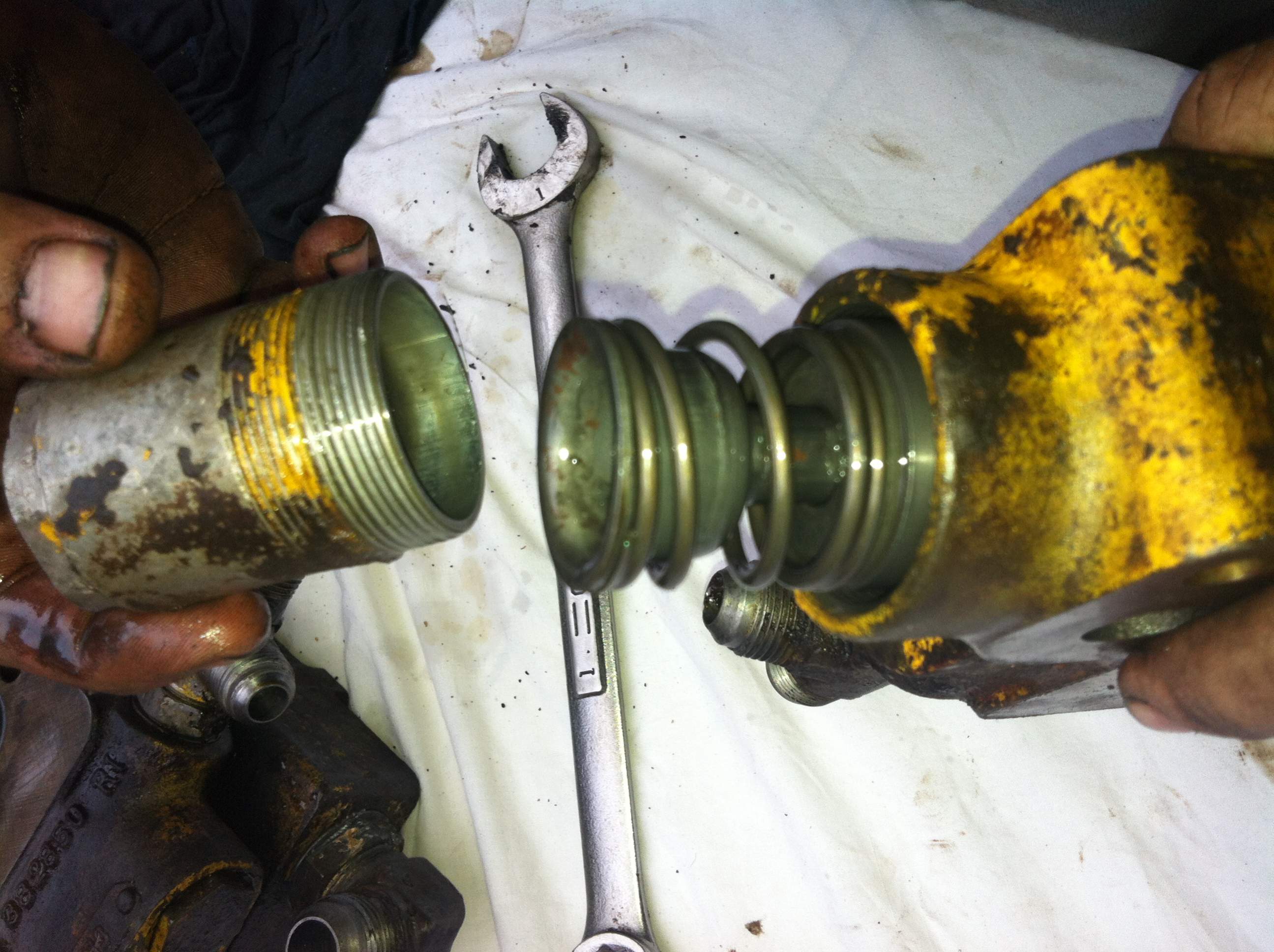

Here I have laid the control valve body out for you to see as reference if you have never taken yours out before. Be extremely careful when you take the rod out as there are three little ball bearings that can get lost VERY easy.. I almost did not find one of mine and thank god for neodenium magnets.. Do this is a clean open area where if things fall you will find them..
here I laid things out sorta in order.. You can see those ball bearings I am talking about.. Careful getting that Oring off too as the edges of the valve body is very sharp and cut the Orings with ease.. Same thing with puting it back in.. I found it easy to rotate the rod and keep it dead straight lubed with plenty of grease.. It was real snug but it went in fine..
Here is a closer view of the bearings and assembly

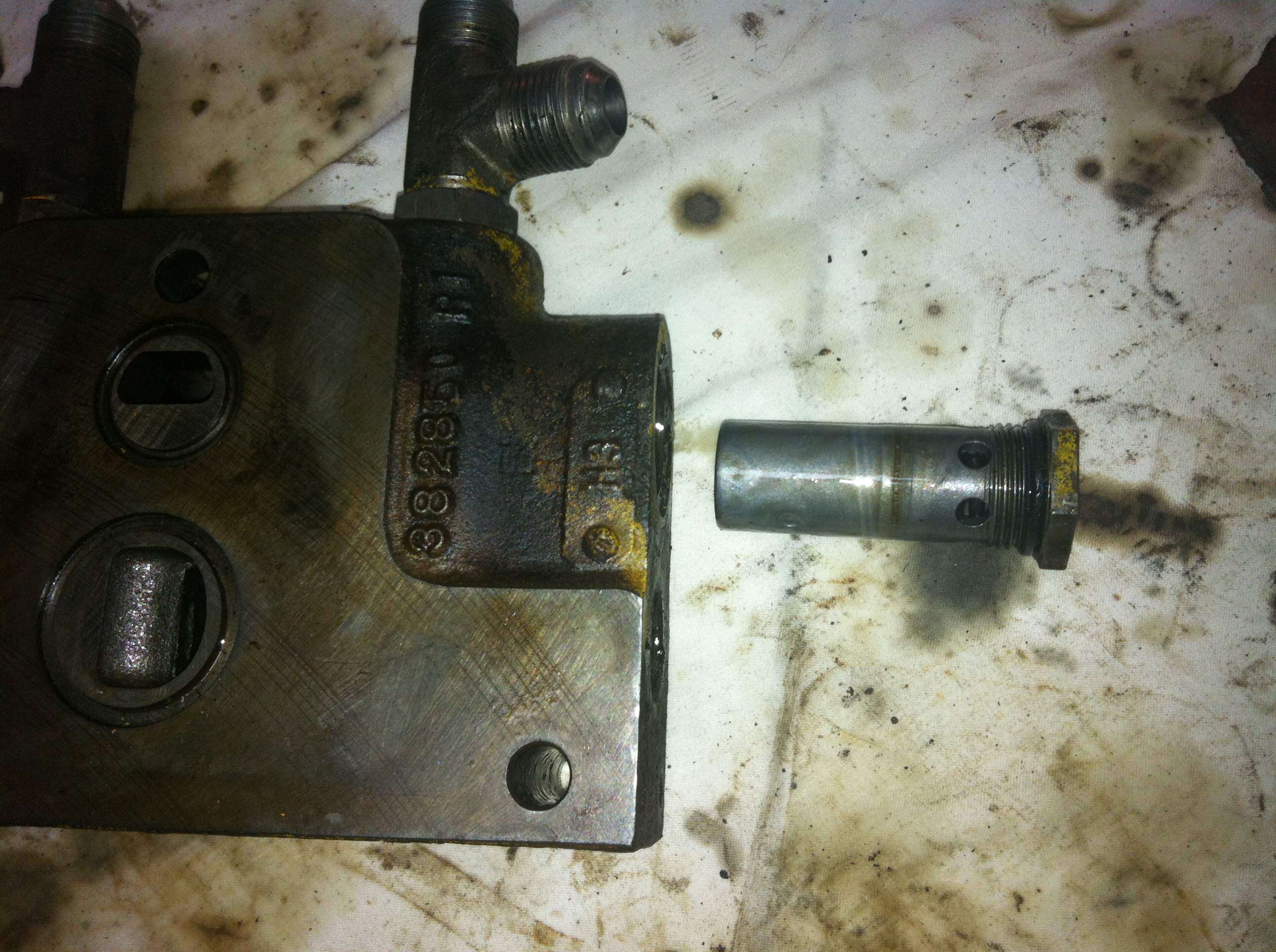

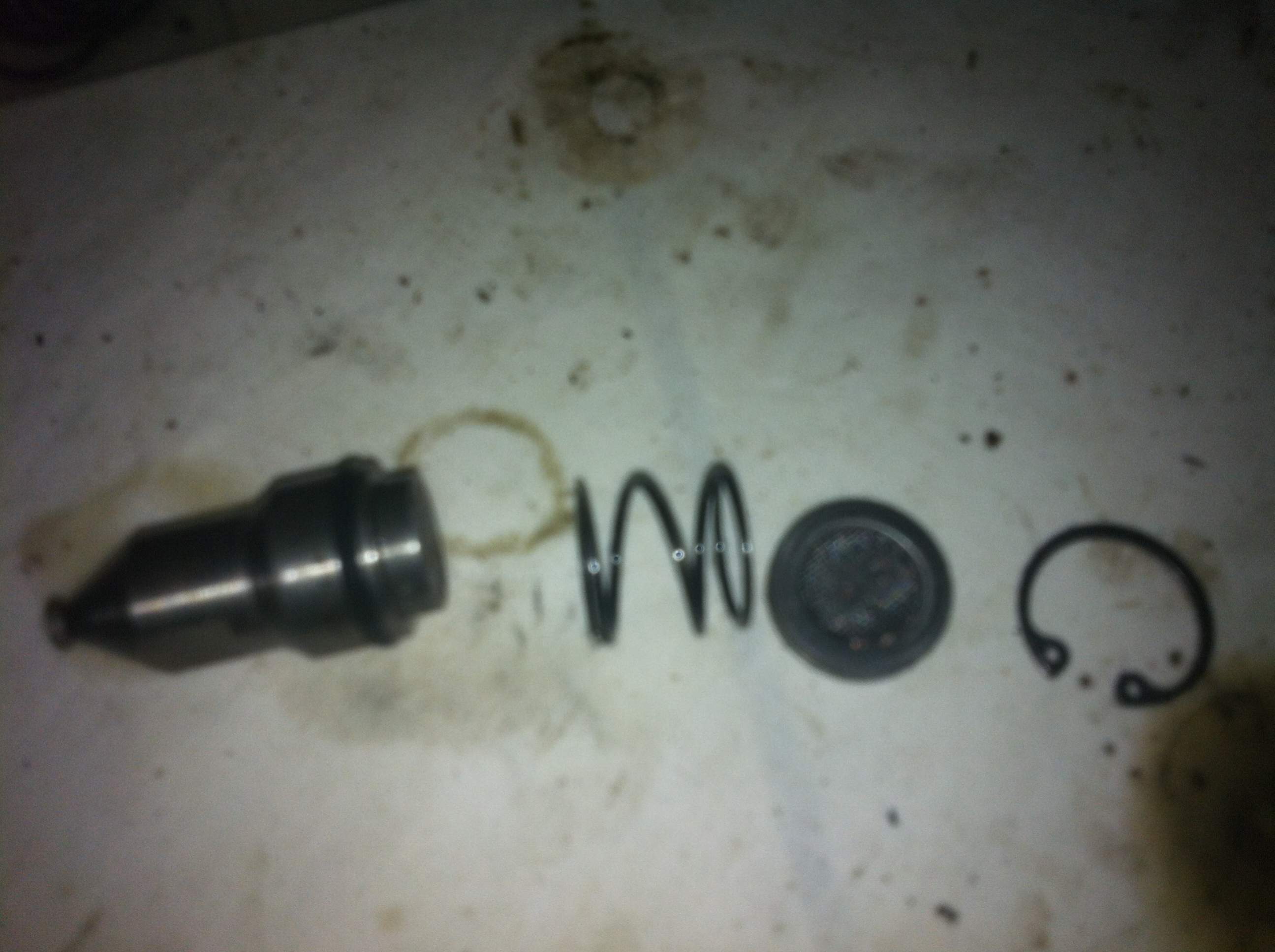

Here I removed the "CUSHION" relief is is marked on the hex head 1600 P S I as that is what the parts break down refers to it as.. It has one set of holes at the base and if you look you can see a ball bearing in orifice..
Here is the top view of the orifice..

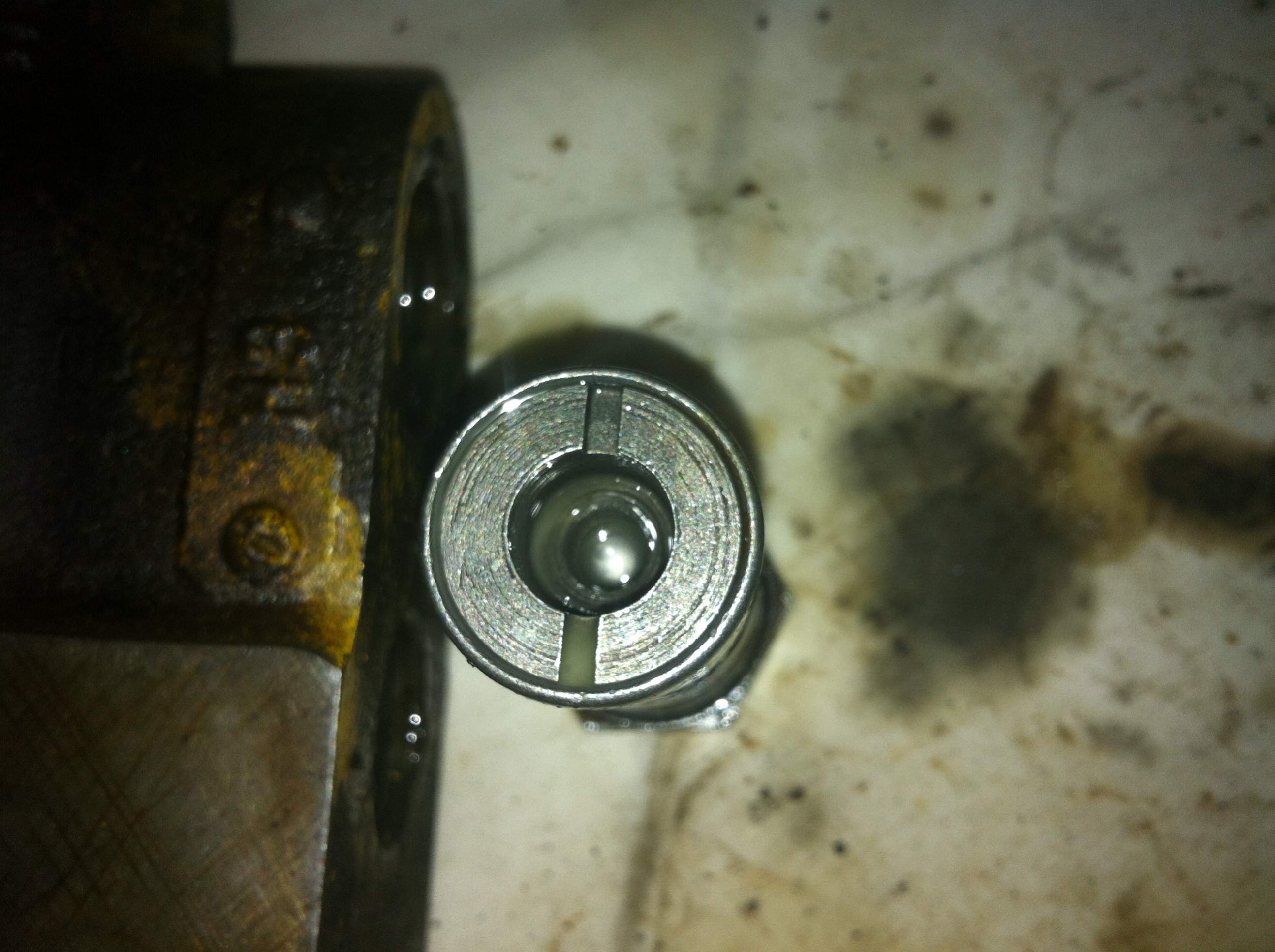

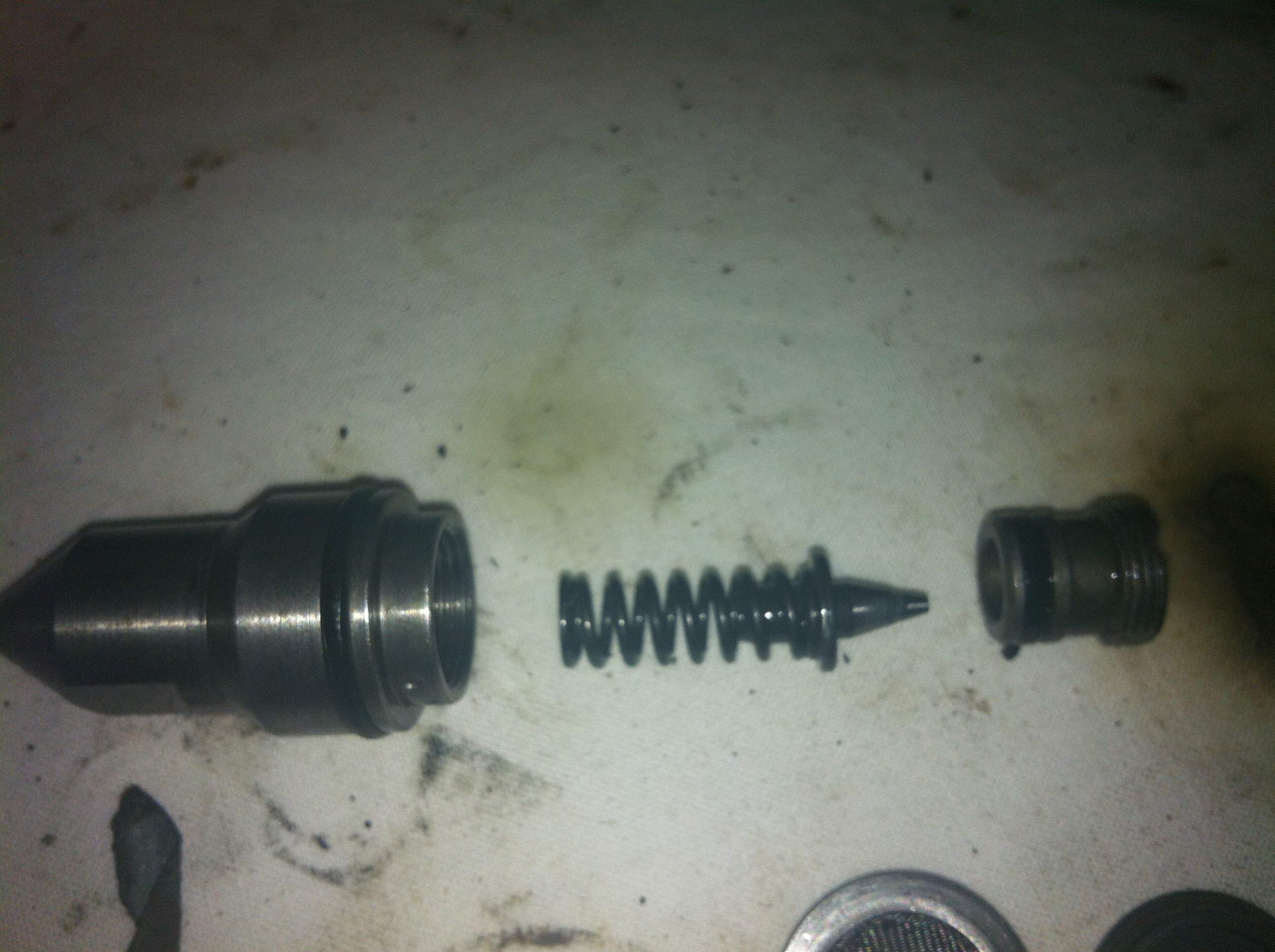

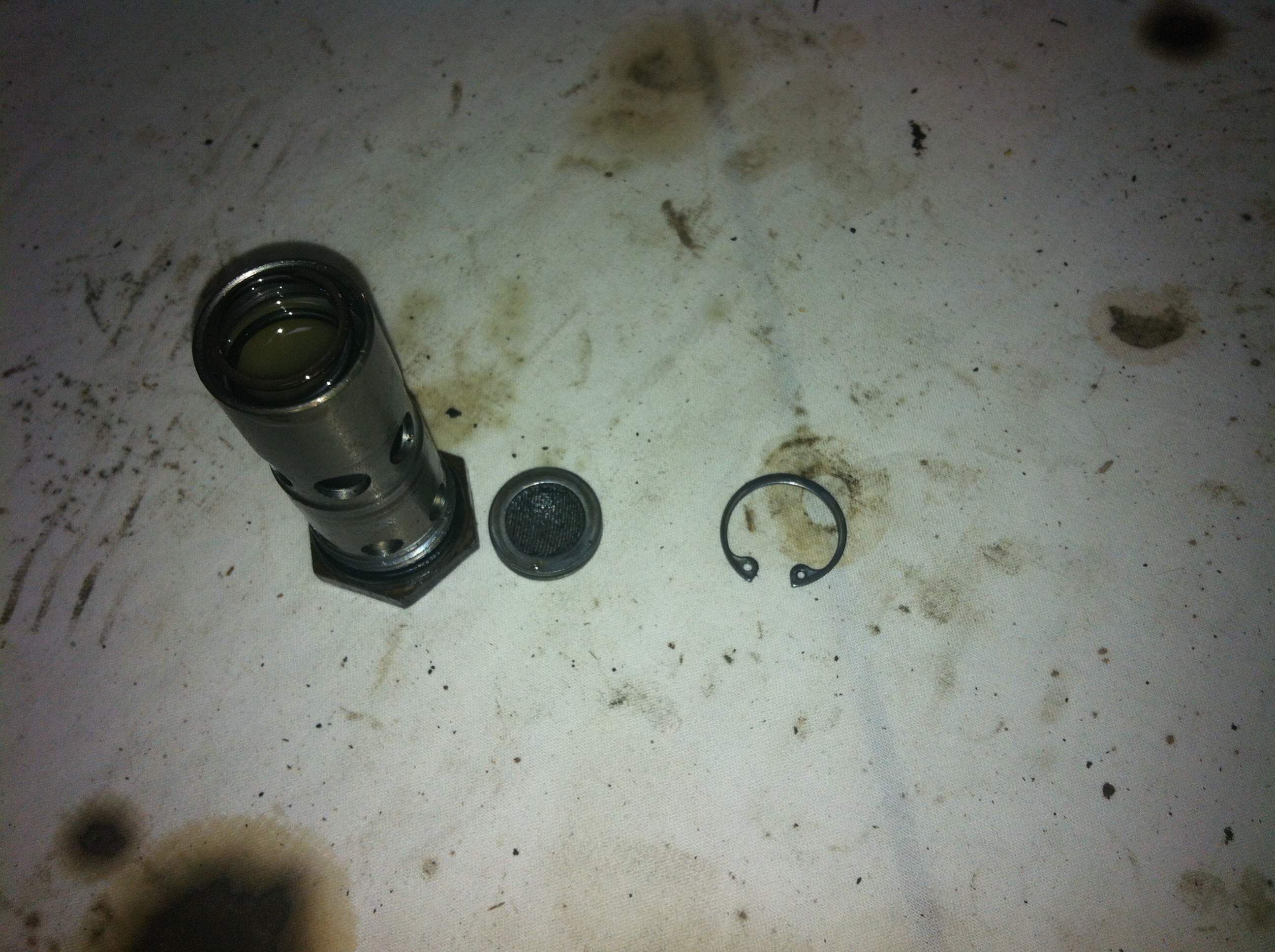

Ok now to spare room I did not show the picture of this removed.. It is a 2000 p s i pilot relief valve.. Notice the two sets of holes at the base.. In case yours don't have numbers it may help you keep things straight.. Now this thing can be taken apart.. No not that it is suppose to but it CAN and so can the cushion valve.. If you look close on the sides of the valves they are " staked " it looks like spot welds but it is where compression was used to create an indention to retain the proper adjustment on the valve.. Welllllll if you slightly pry out on the sides a little but not to much (it appears to be a little brittle), you can unscrew orifice pilot..
On this one it had a snap ring

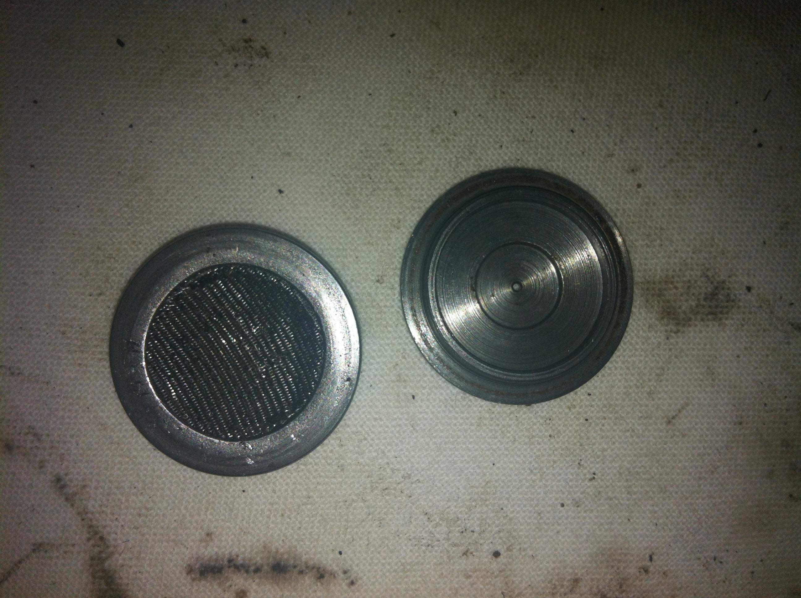

You can see on the pilot valve it has a very tiny hole for the orifice.. Mind the Oring on the outside. Same here I replaced with standard Orings..
On the back side of that orifice is a tiny stainless screen.. Mine was clogged like the dickens.. It had rubber and all kinds of gunk in it.. Surely it will effect the power of the hydraulics and if your machine is like most I have read about people have removed the hydraulic filter making things worse.. this little screen gets it bad.. It would be a good thing to keep in mind just where this valve is when you put things back as when things start to bog down in the future you can locate it and remove the right valve the first time and check this filter..

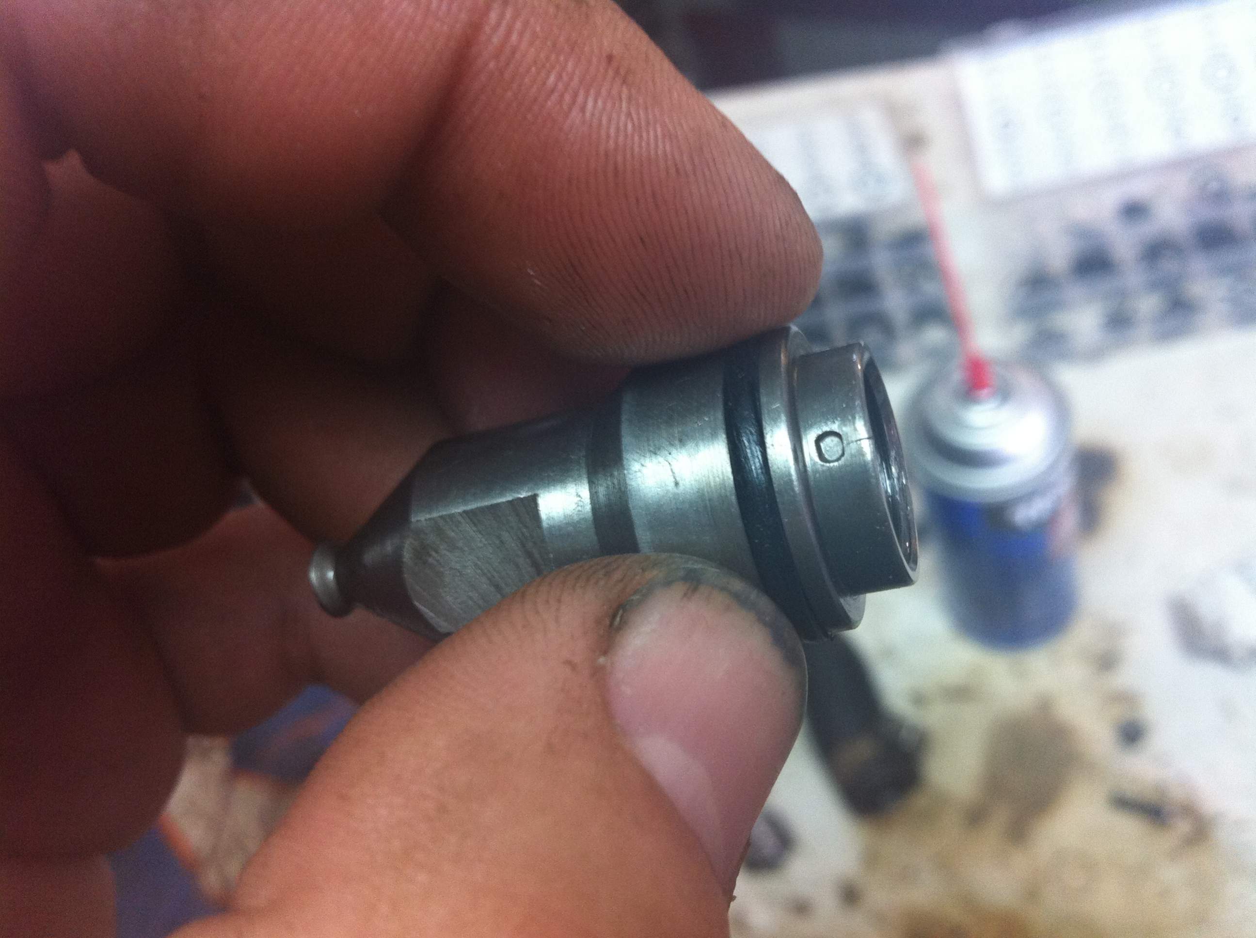

Ok now underneath the orifice will be the screen an beneath that a spring now we come to this part of the valve.. It sorta floats and rides up and down inside the pilot valve body.. Keep in mind which way it comes out as I suppose someone COUUULD actually reverse it.. Notice the "staking" yes that little crack was already there.. In the body below is a pilot screw ( that is what the staking you see in the picture below retains in place) When you unscrew the pilot KEEP TRACK OF HOW MANY TURNS IT TAKES TO TAKE IT OUT!! Mark it, scratch it, dykem it something and write it down..
Here it is all laid out as it comes out.. Notice the pillot screw with the Oring on the right... This is what you keep track of when you remove it..

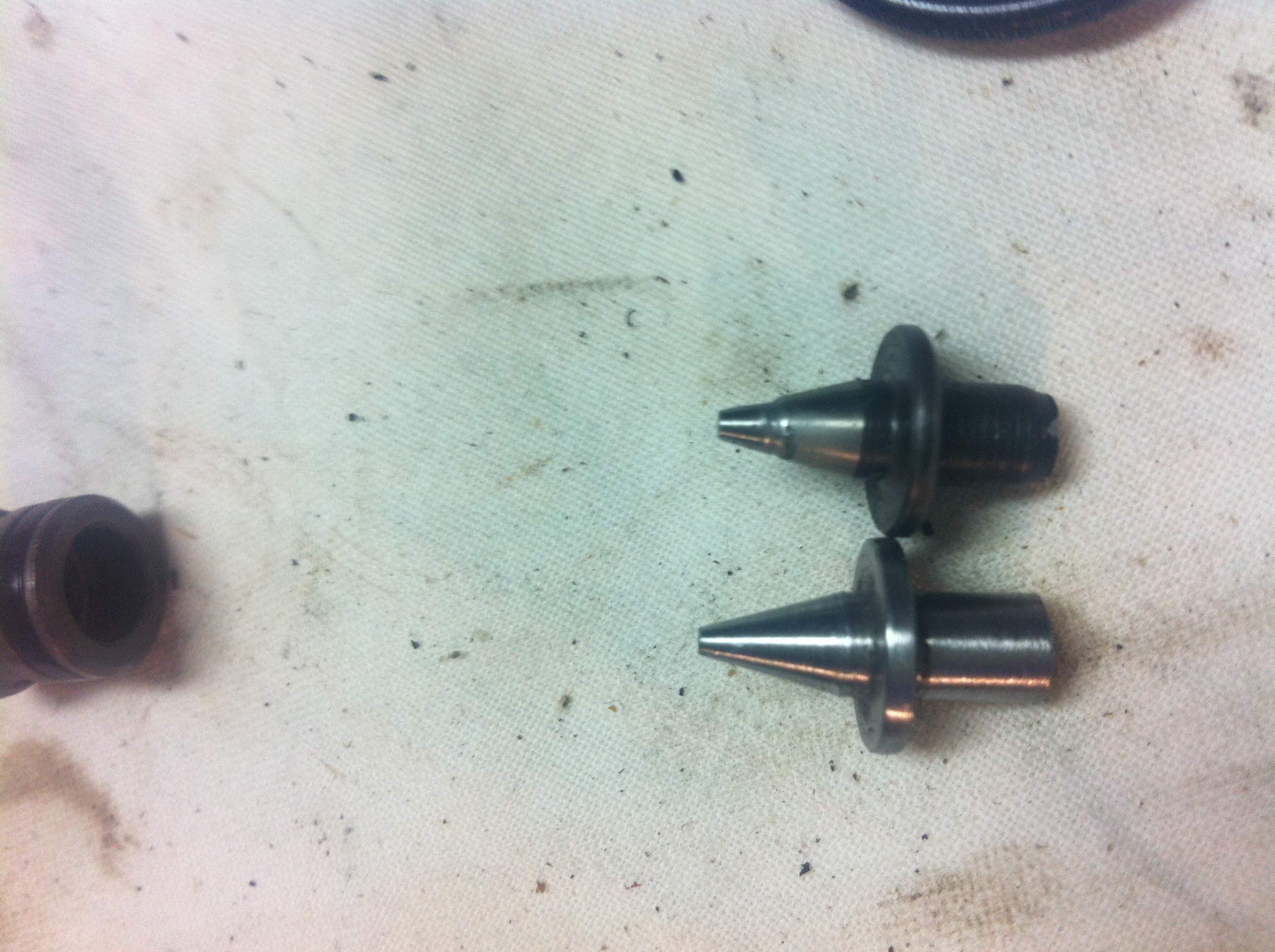

Ok now if you look there is a little conical shaped plunger sitting in the spring (since I do not have proper diagram and these are not supposed to be taken apart I use my own terminology) if you know the proper name for this piece then great.. For the sake of explanation in this illustration its a conical plunger LOL.. This piece was badly galled and beat up from the many times its been slammed into the hole its closes.. Thankfully I am a machinist and own my own shop.. I simply machined another one from carbon steel..
here is a view of how it fits inside the pilot valve body when it is assembled..
   / IH 3414 front valve bank disassemby.. Weak or No hydraulic? This may be the solution!
Here is a close up view of the "conical plunger" that is damaged next to the new machined part.. I mentioned that I had machined it out of carbon steel.. I know some might suggest tool steel.. I know buuuut when I took a file to the old one it actually bit in.. It didn't skate off like a typically hardened part.. actually it seemed to be slightly unhardened if that makes sense to any non metal workers.. To a machinist you can sorta tell where the hardness is at when your working with metal.. Since so it gave me the bright idea I could make another from the material on hand..
After I had machined the new one I hardened my new part at approx 450 degrees F or deep straw yellow.. "Chisel hard"

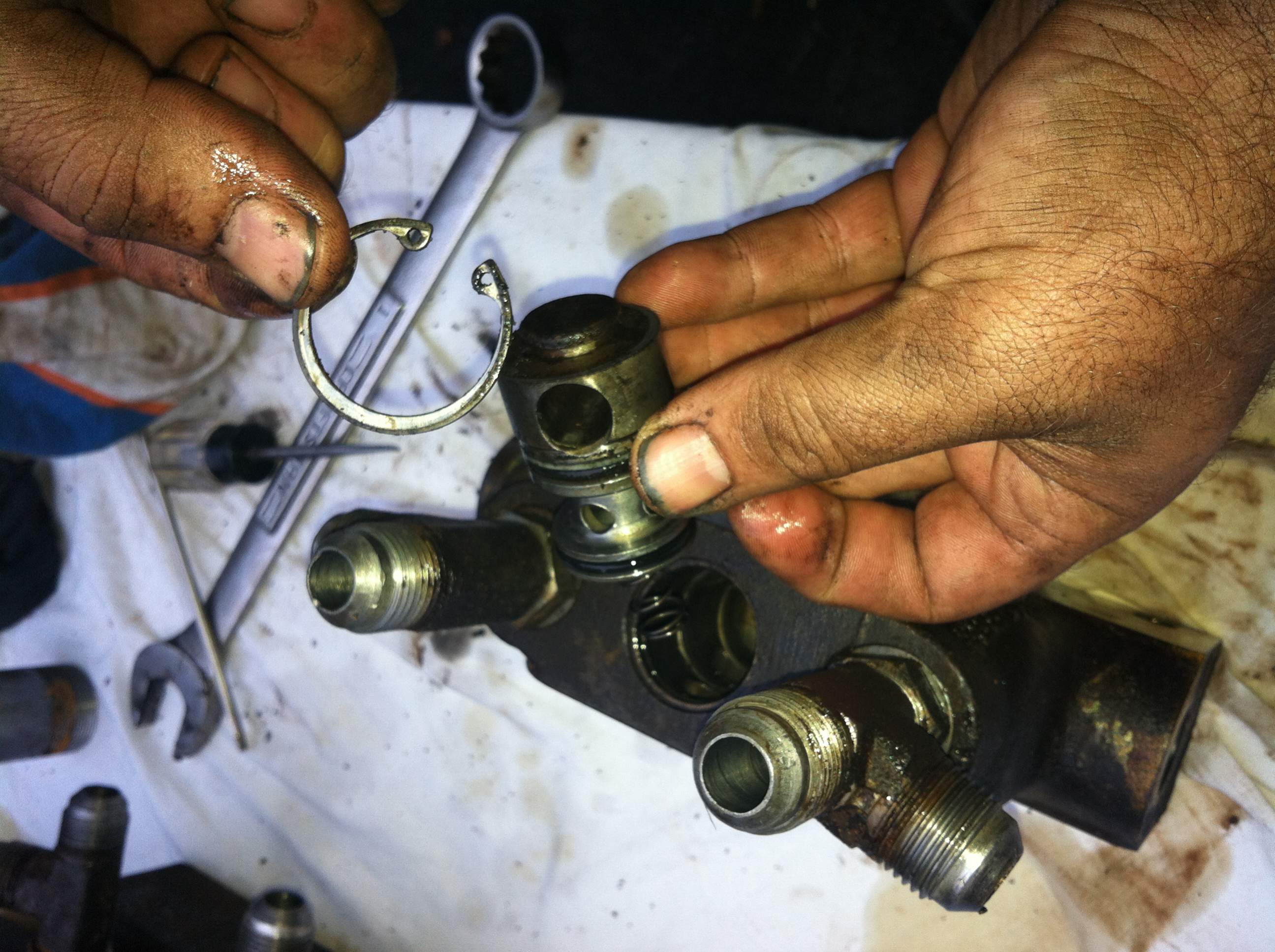

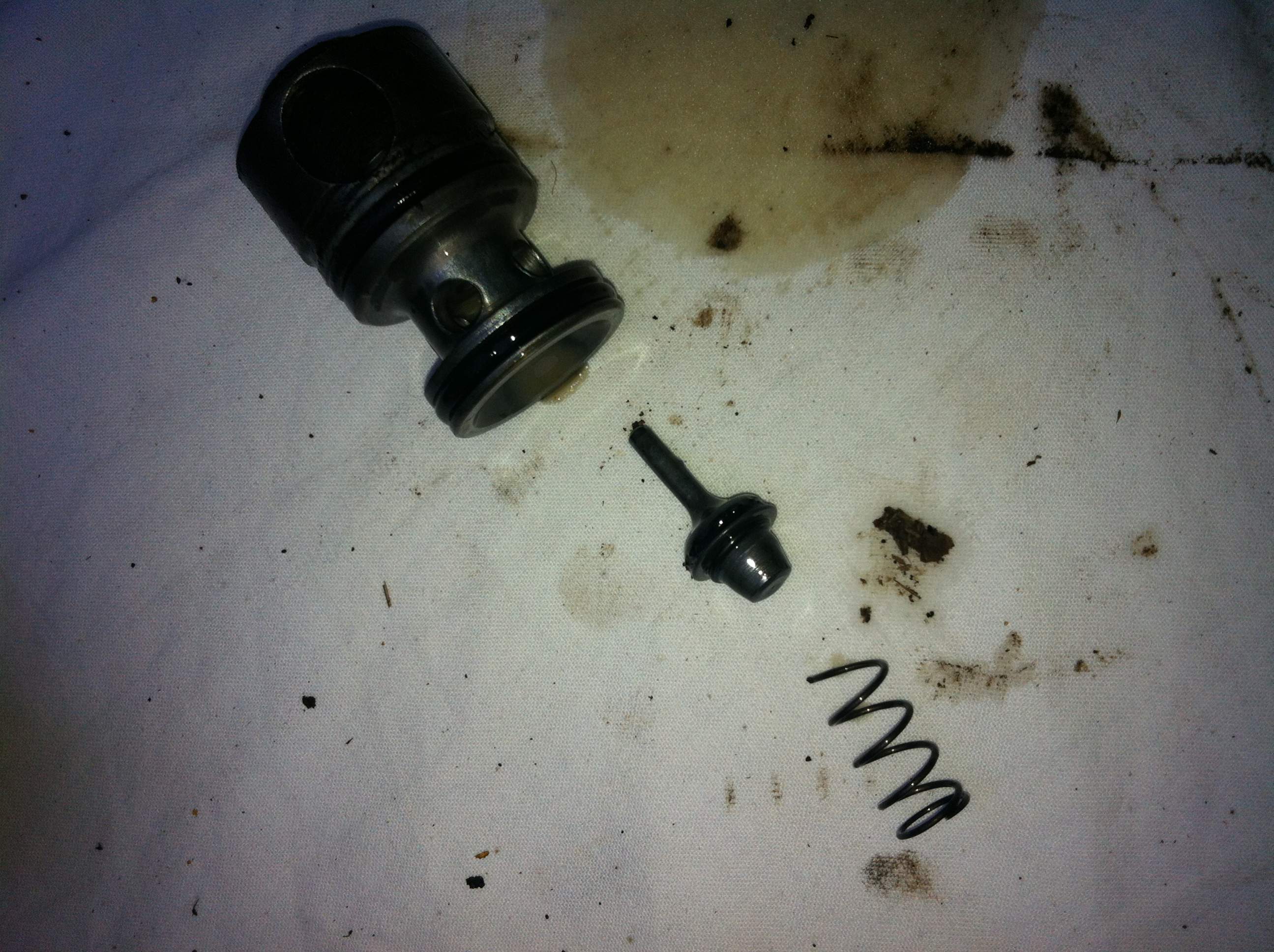

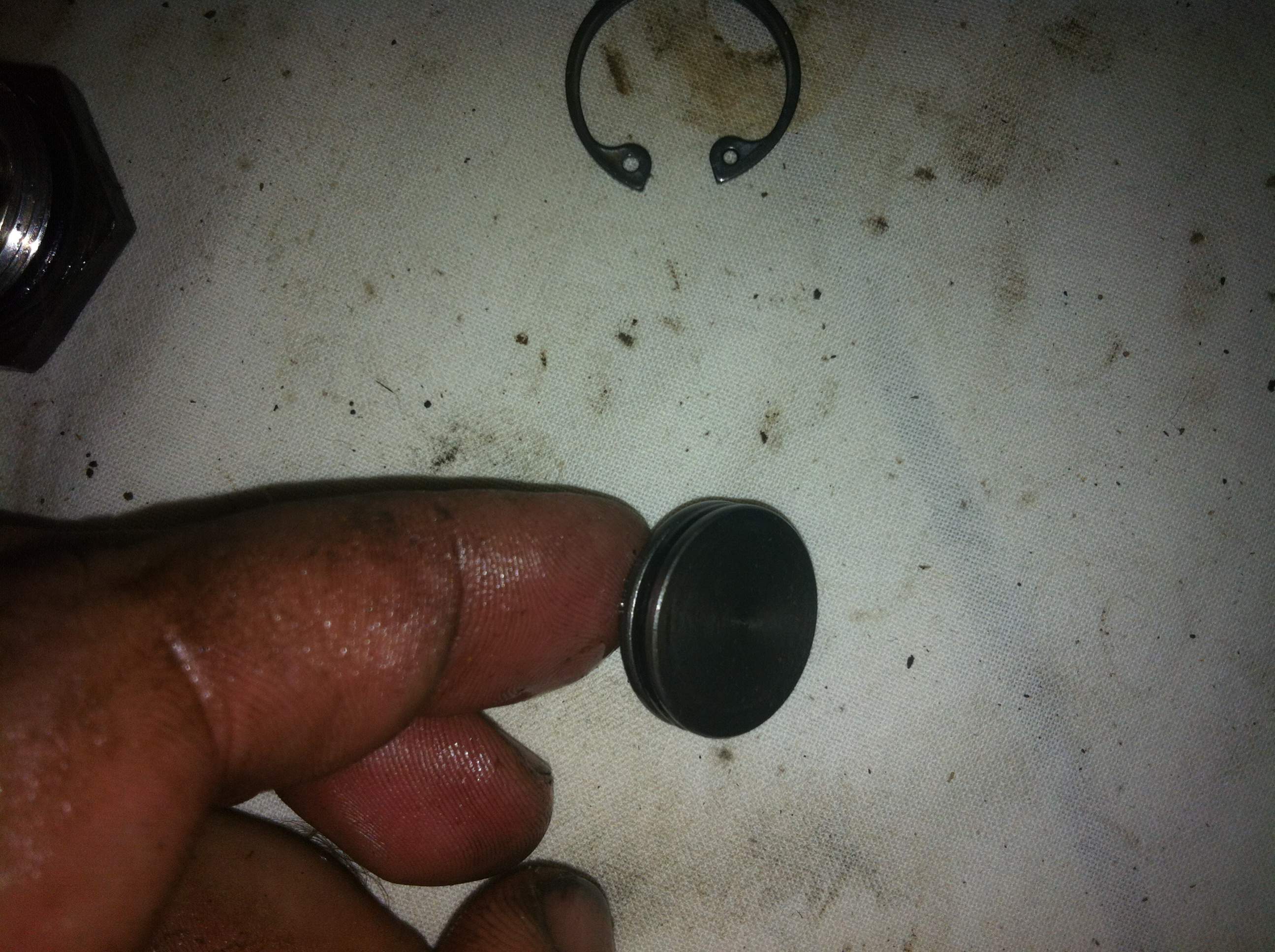

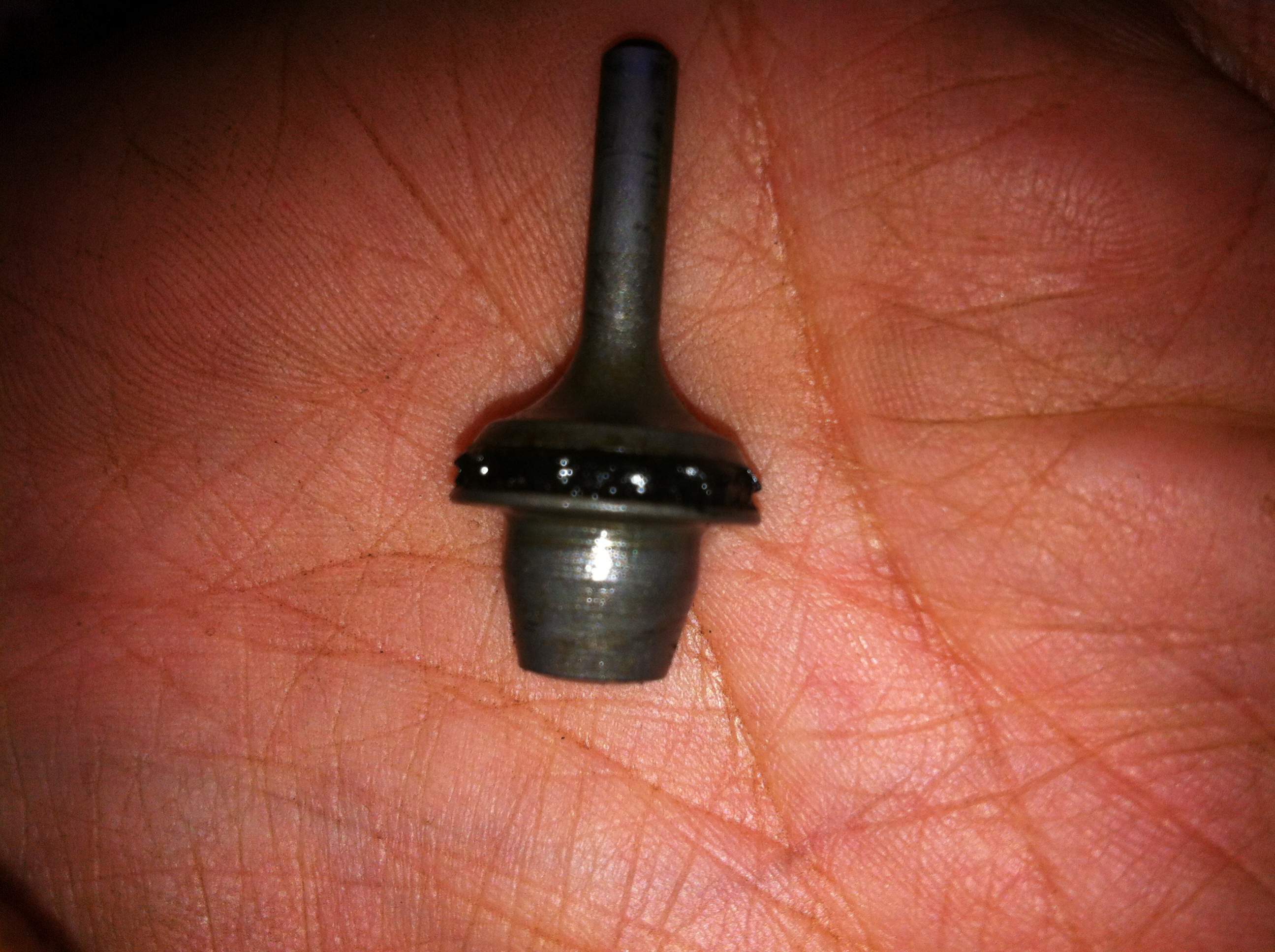

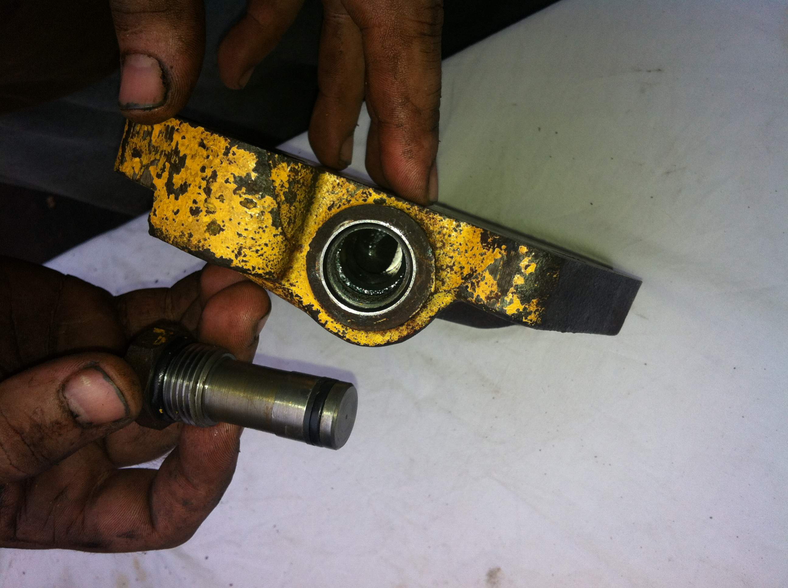

Ok now for the culprit that I think is causing everyone the grief.. It is called a check poppet assembly.. If you look on the bottom of your valve bank you will see a plug that is held in by a snap ring.. You can see the size below.. ON the front bank there are TWO for this purpose I only illustrate disassembly of one..
You can see how it came out of the bank.. The poppet stem sits inside the retainer as so the tapered end seats against the retainer.. On the poppet there is a rubber ring.. To ME this appears to be made on the poppet. I did remove the old cracked deteriorated rubber.. It appeared to be glue on the poppet where the rubber came off.. The ring on the poppet itself was flat unlike a typical Oring groove.. This made me believe that it was made on from the factory with some type of adhesive.. This is just my opinion I have no idea. I DO know that that I can NOT locate the poppet anywhere... If you think about it the "trick" of raising up or down on the loader lever to operate the hoe worked because the valve body rod was acting as a blockage.. when you would pull the lever half down the rod was in between the passages in the rod and bank itself.. These poppets cant close fully and its bypassing fluid around where the rubber is..
Here you can see a close up of the rubber on the poppet.. It is all crumbly and falling apart.. I can't quite think of why the machine worked for a couple of lifts of the front bucket when cold or first cranked up. I do know it WAS the problem... I replaced the rubber with a snuggly fit metric Oring.. I figured it would work for a while.. I knew it would fail but I figured it would get me through a job I had for the hoe.. Wellllll it actually got me only about 5 to 15 mins into the job before it failed.. The simple Orings just wont stay on and the pressure from the hydraulics cut and break a regular Oring..
