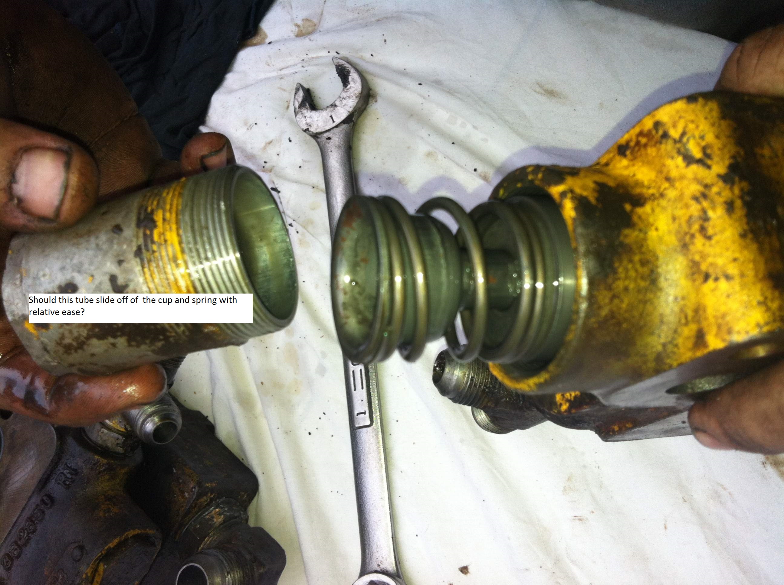

yes that's exactly what has happened, and that's the approach I want to take. the real issue is the part that fits over the spool(the long piece outside the valve) will not slide off the cup and spring . My question is, will it slide off or is there a bolt or screw inside the plug on the end of it that needs to be removed for it to come off. I reattached the photo you posted and labelled the part to make explaining easier.

I am having the exact same problem with my IH 3414 and need the aluminum tube/cap for the valve body. I cannot seem to locate one anywhere and have only found 2 salvage possibilities but must purchase the whole control valve for over $450. Is there a chance that someone out there can still make one of these for a reasonable price? It would be greatly appreciated!!

I figured out the problem with the 3414. This issue is in the front valve bank. The two cone shaped poppets in the bank have glued on seals or oil ring type seals . Those harden crack and fail. I simply machined and lapped new poppets or valves to the seat in the bank. It has worked flawlessly ever since. I have lifted almost more than the machine can handle and it still works 100%.
I did not take photos but I would be willing to machine new poppets for those who need them at a reasonable price. The lapping is up to the end user. Of course it would be as is to the user but I would make the price worth the chance.
