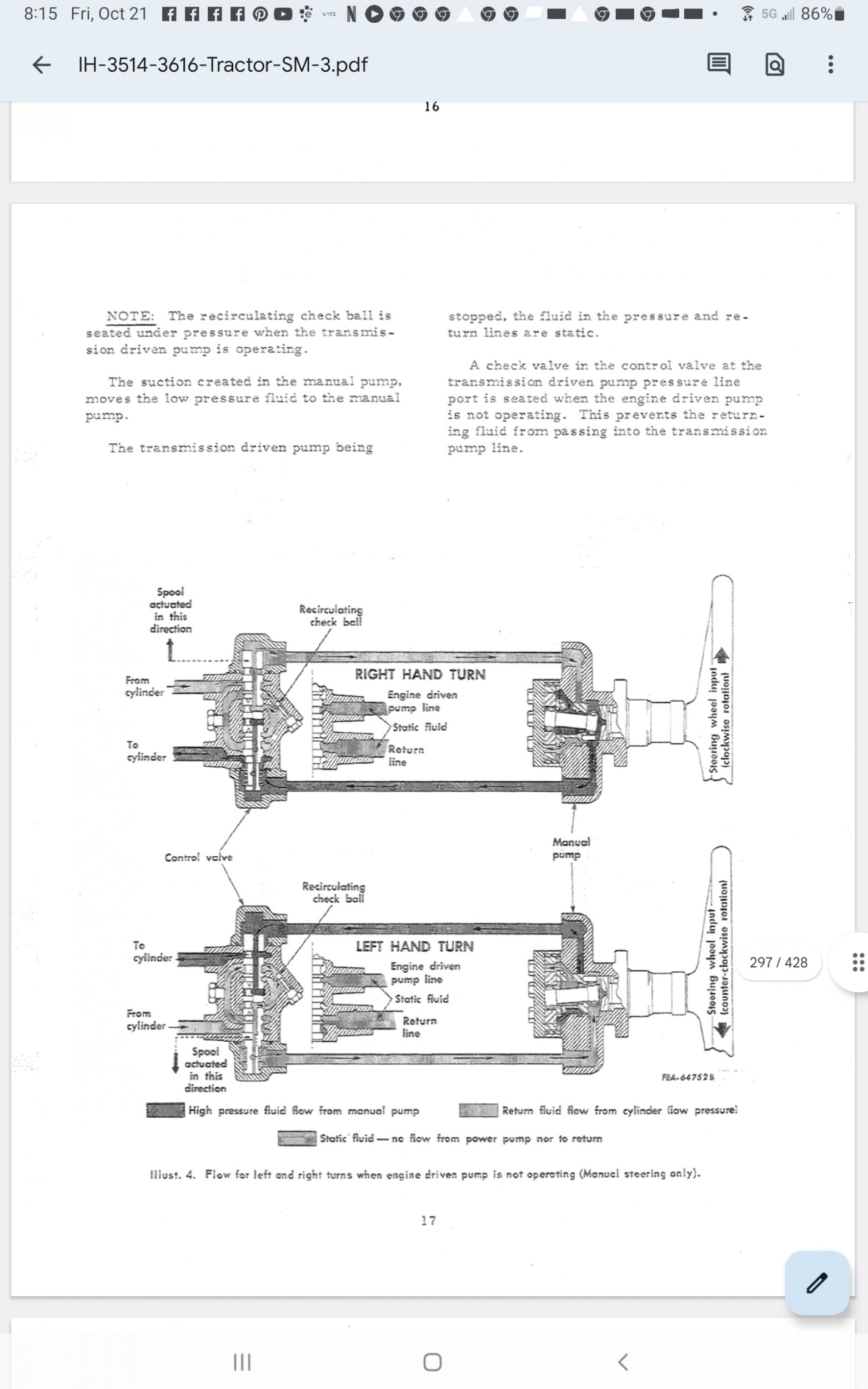

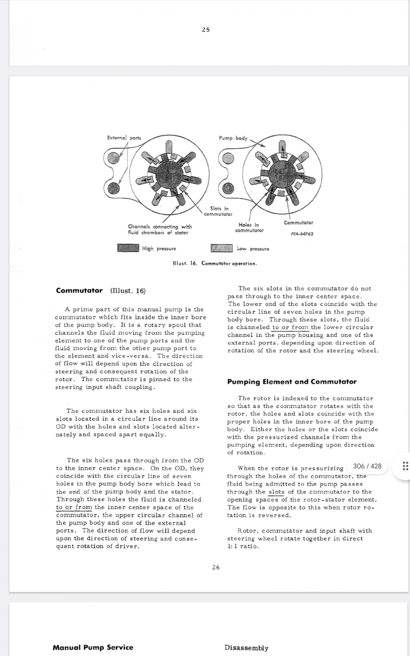

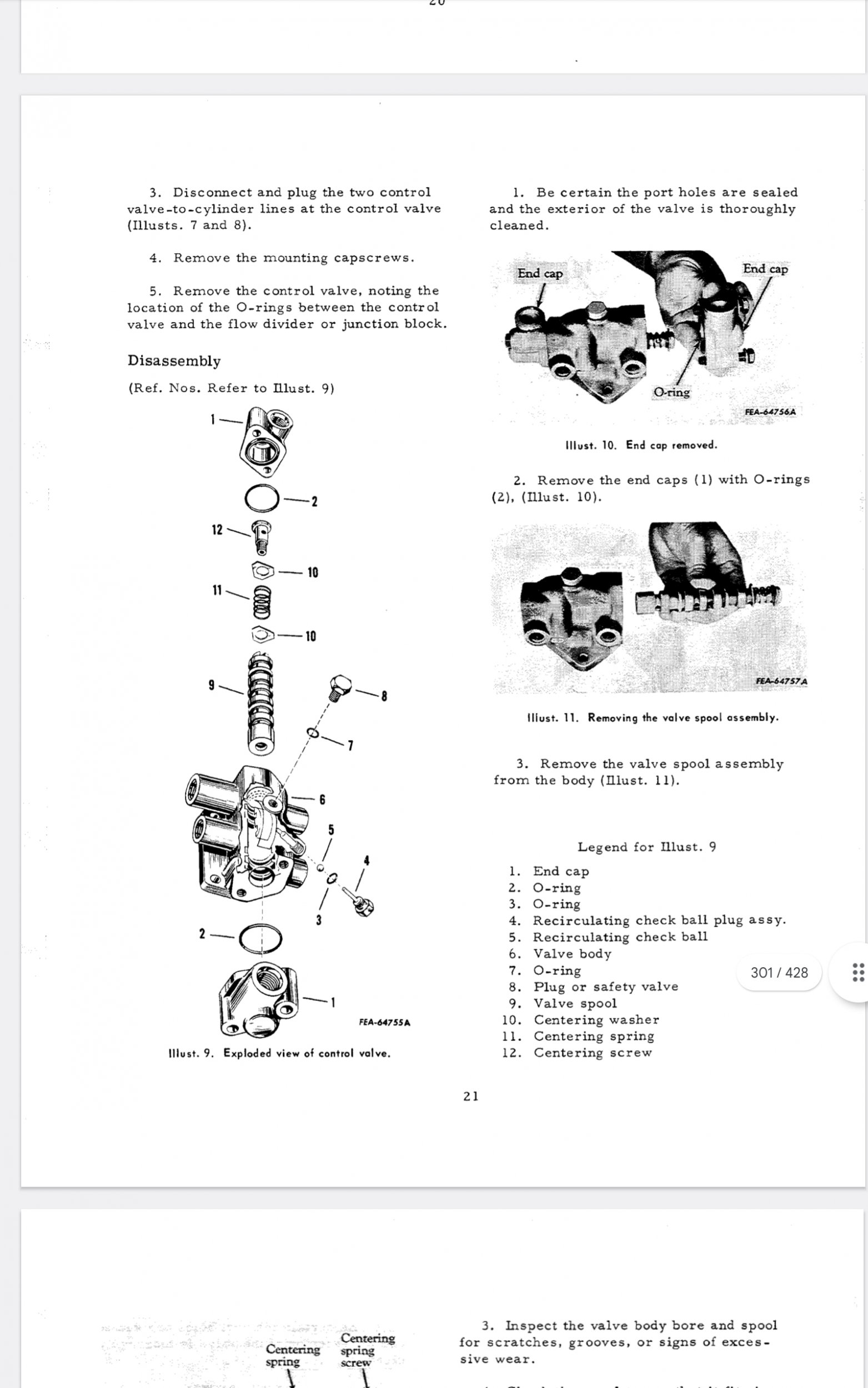

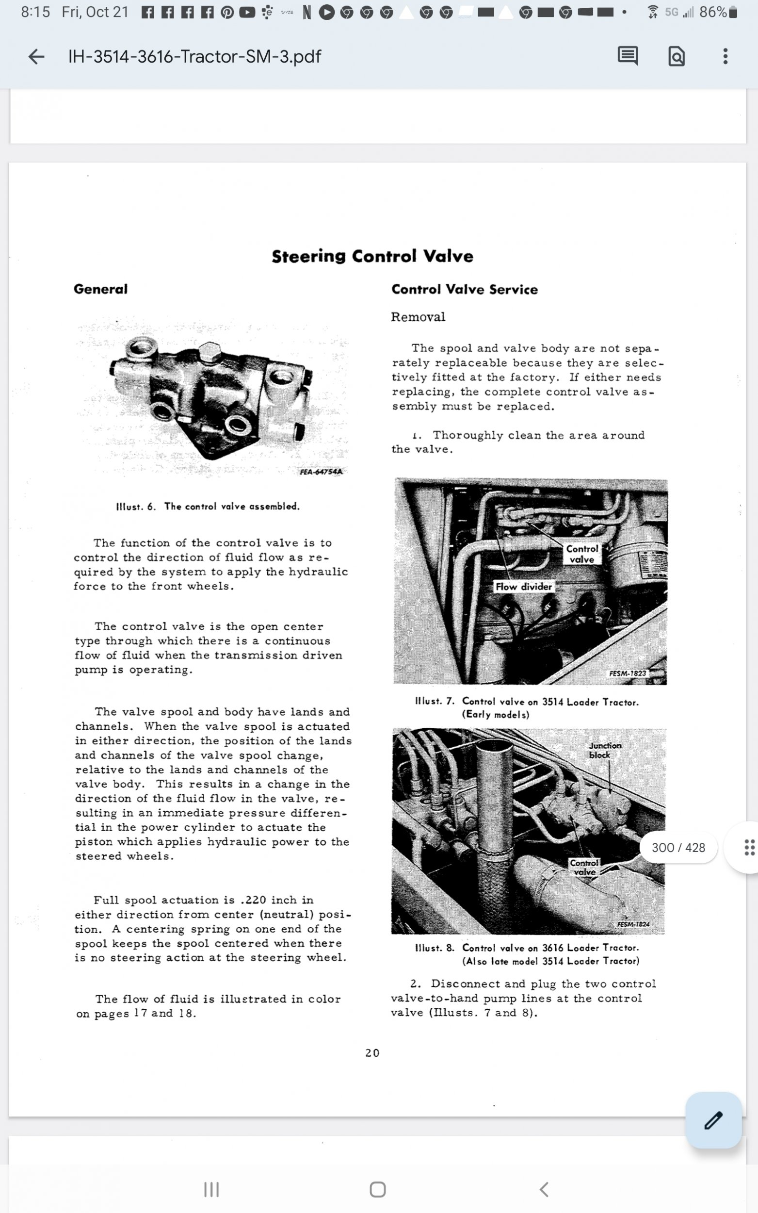

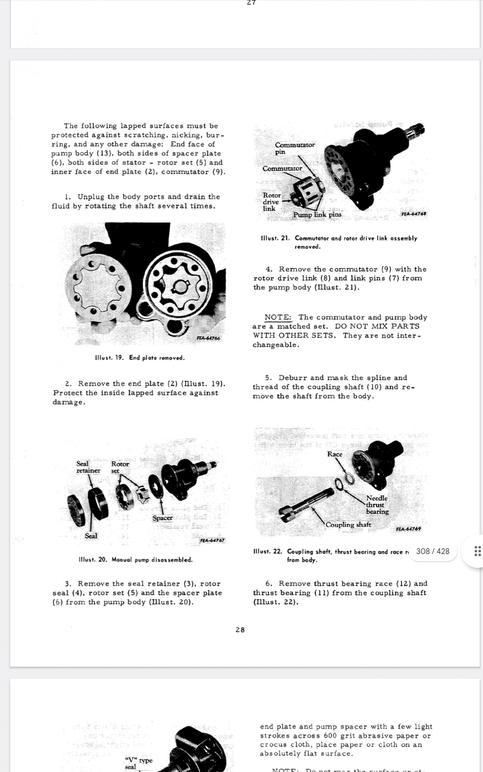

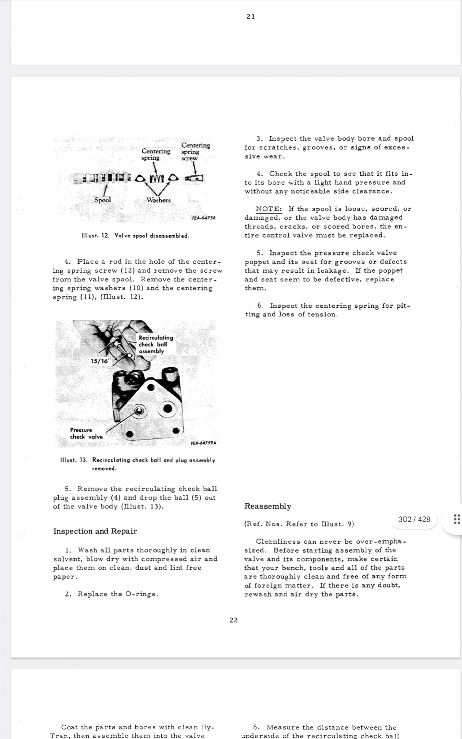

/ IH 3514 Steering problem #4

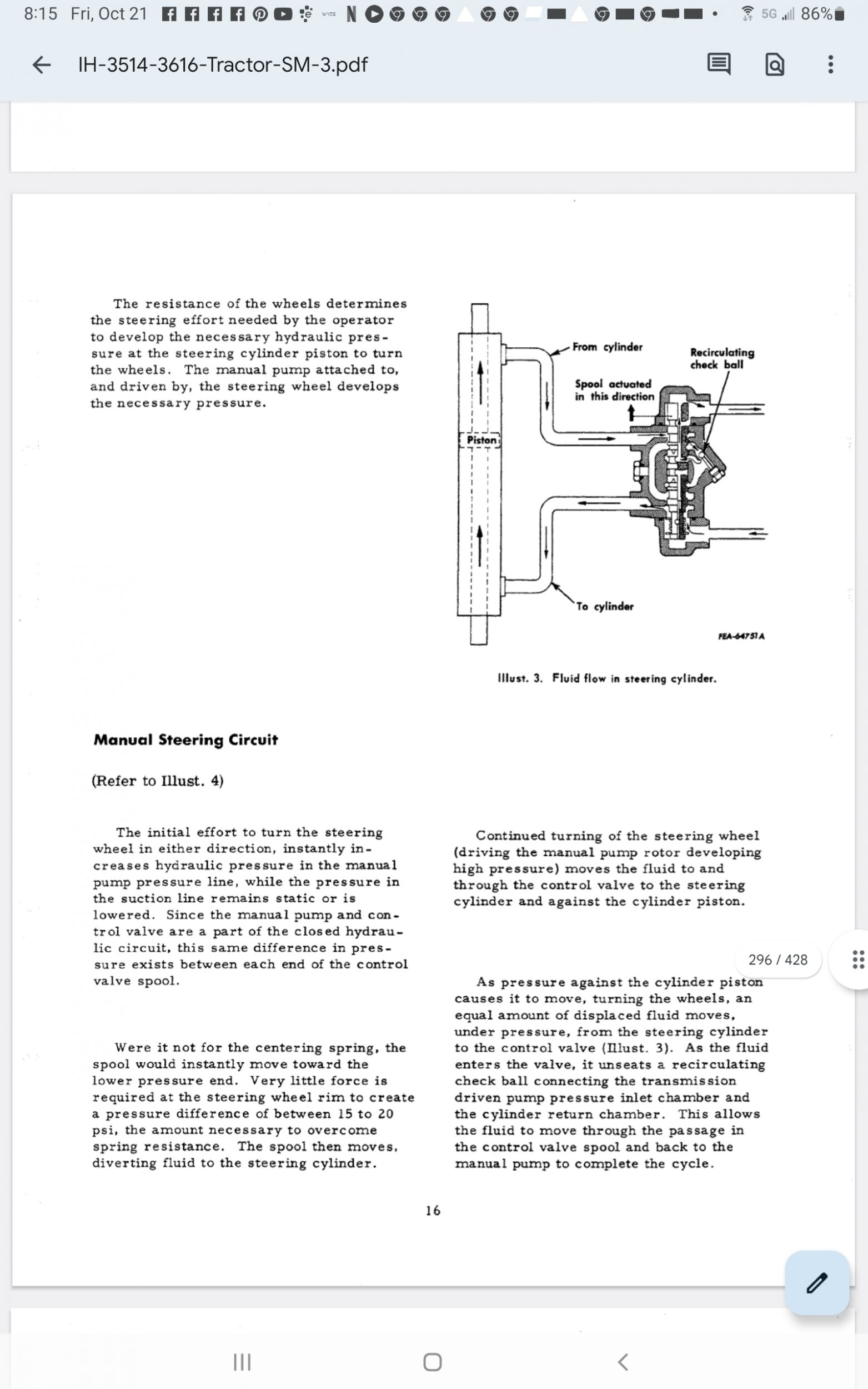

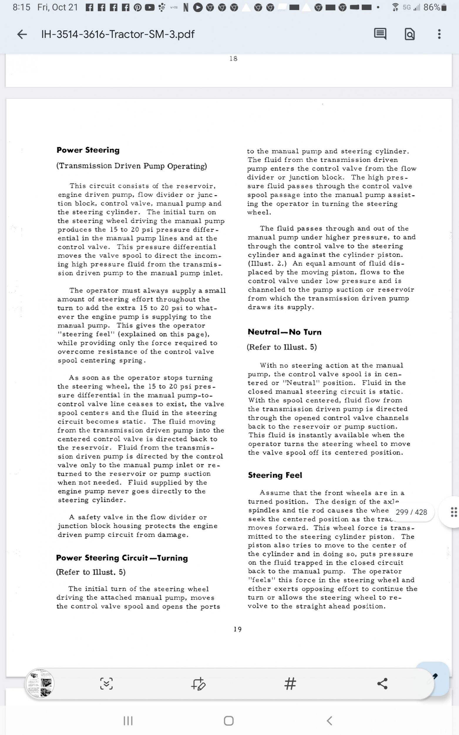

You have to bleed the system. It's all hydraulic. There is a hydro pump on the steering wheel and it runs through a valve that controls hydraulic pressure to the steering cylinder. I am having problems with it myself. I have gotten it to steer but no power steering, I haven't been able to completely bleed the system so I don't know if that is why I can't get power steering.
/ IH 3514 Steering problem #5

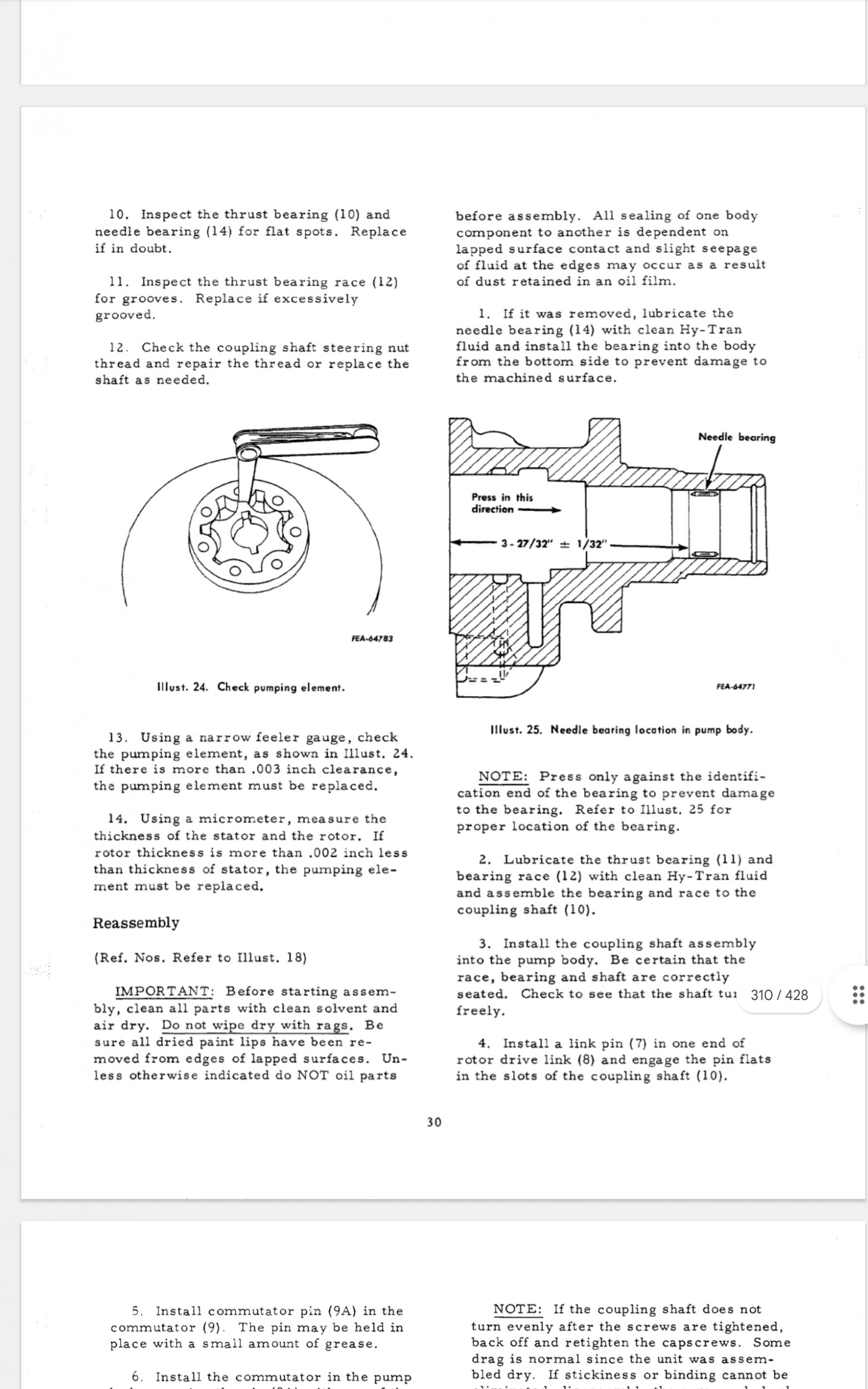

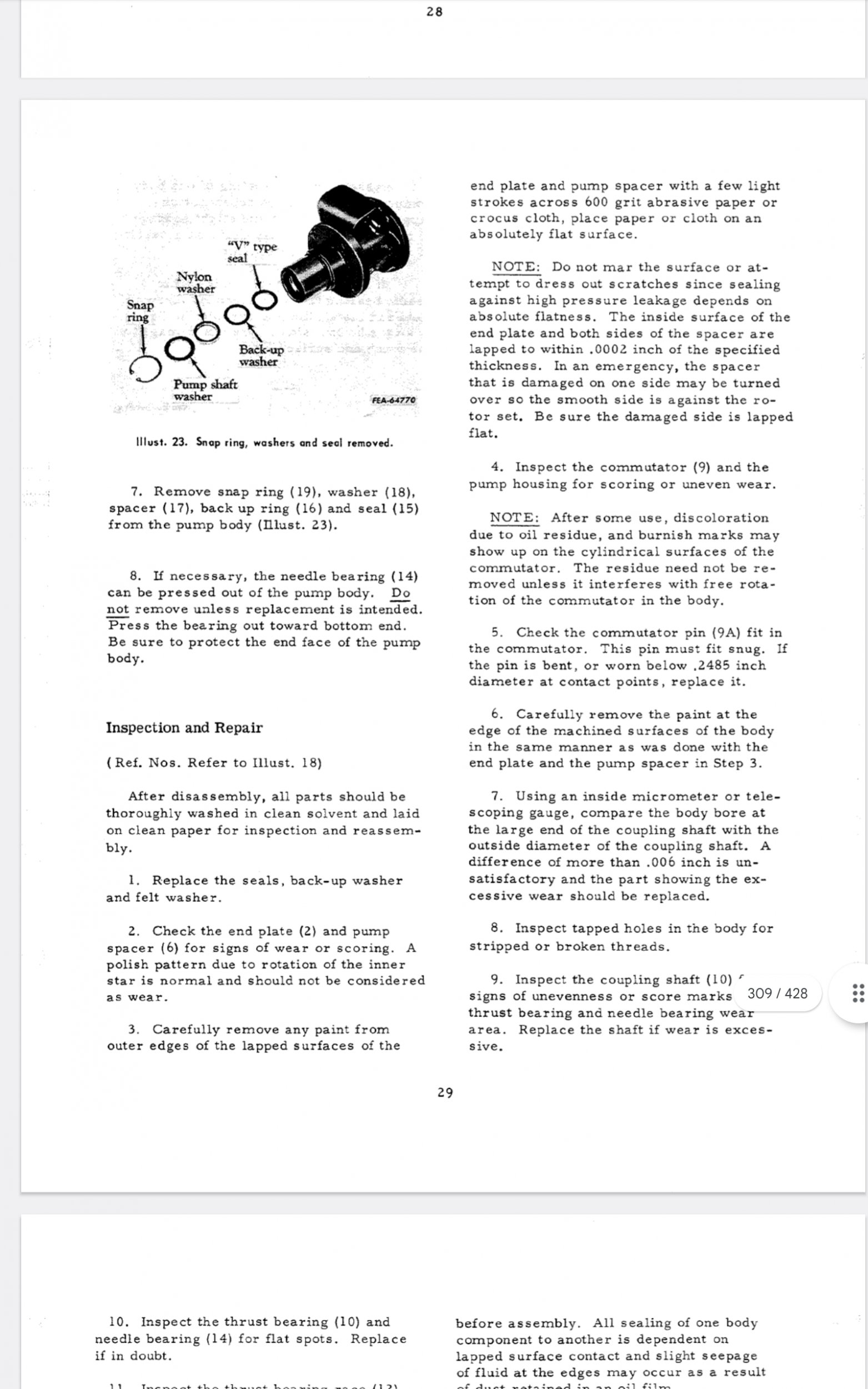

This is the manual I found has the best info

Here are some pix
