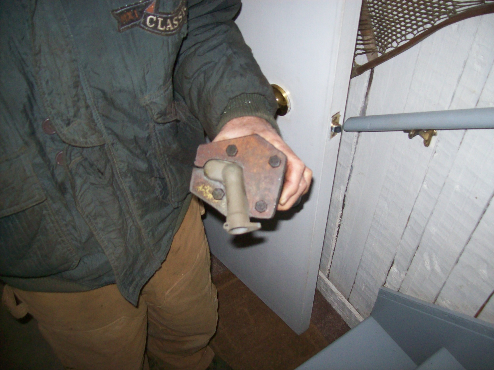

I want to thank you so much for your post. I had the exact problem. pump.jpg

You are welcome, I posted hoping someone someday would get some good from it.
I still have a spare pump "not rebuilt" If you should ever need it let me know. The way I save stuff if I am
still alive I will still have it.

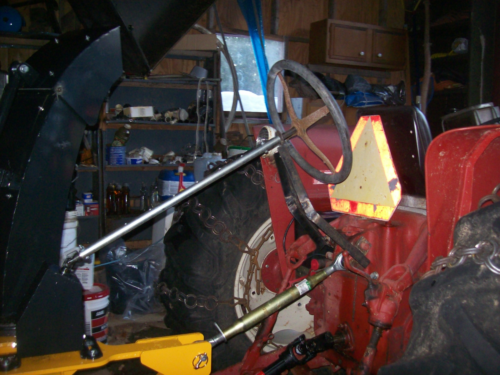

I am the same way. Everything is raw materials and you never know what you will use something for. I've even threw something away and before the day is out
i needed it and retrieved it from the trash. Prime example is the crank for the snowblower I put on the 444 was hard to use and I had an old steering wheel I've had for 20 years and knew exactly where it was came into use.wheel.jpg Thanks again for your efforts on your post.
