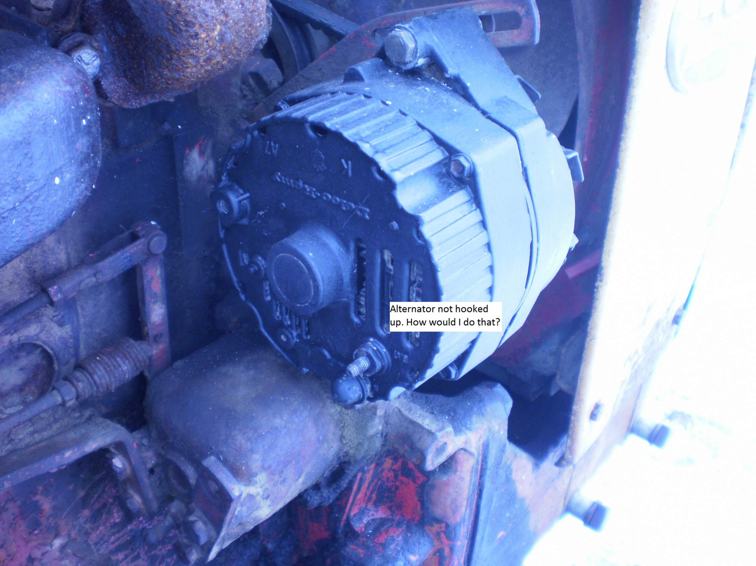

I don't have the alternator wired yet. I figured I'd tackle that after this problem is fixed. It not being hooked up isn't causing a problem is it?

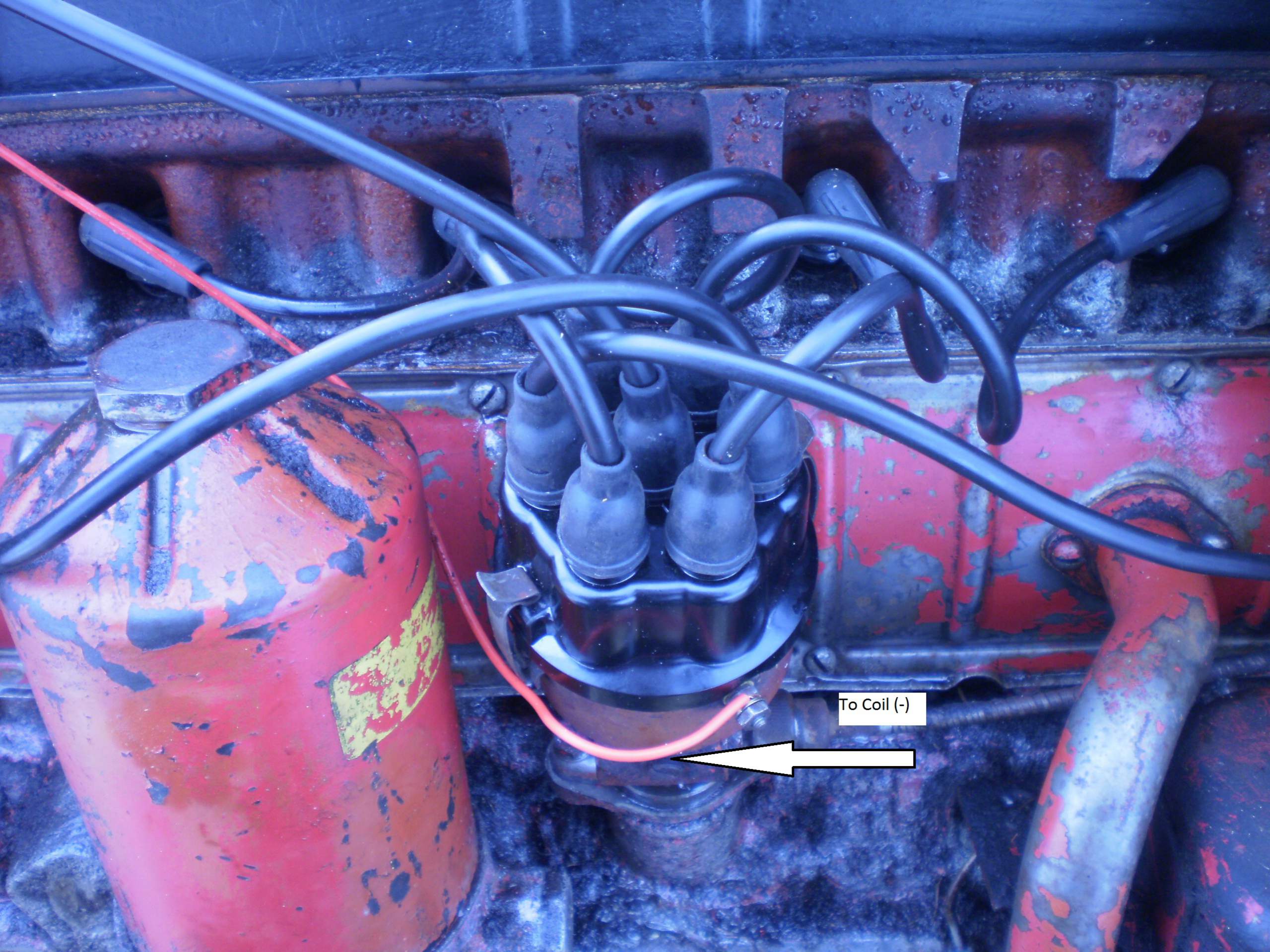

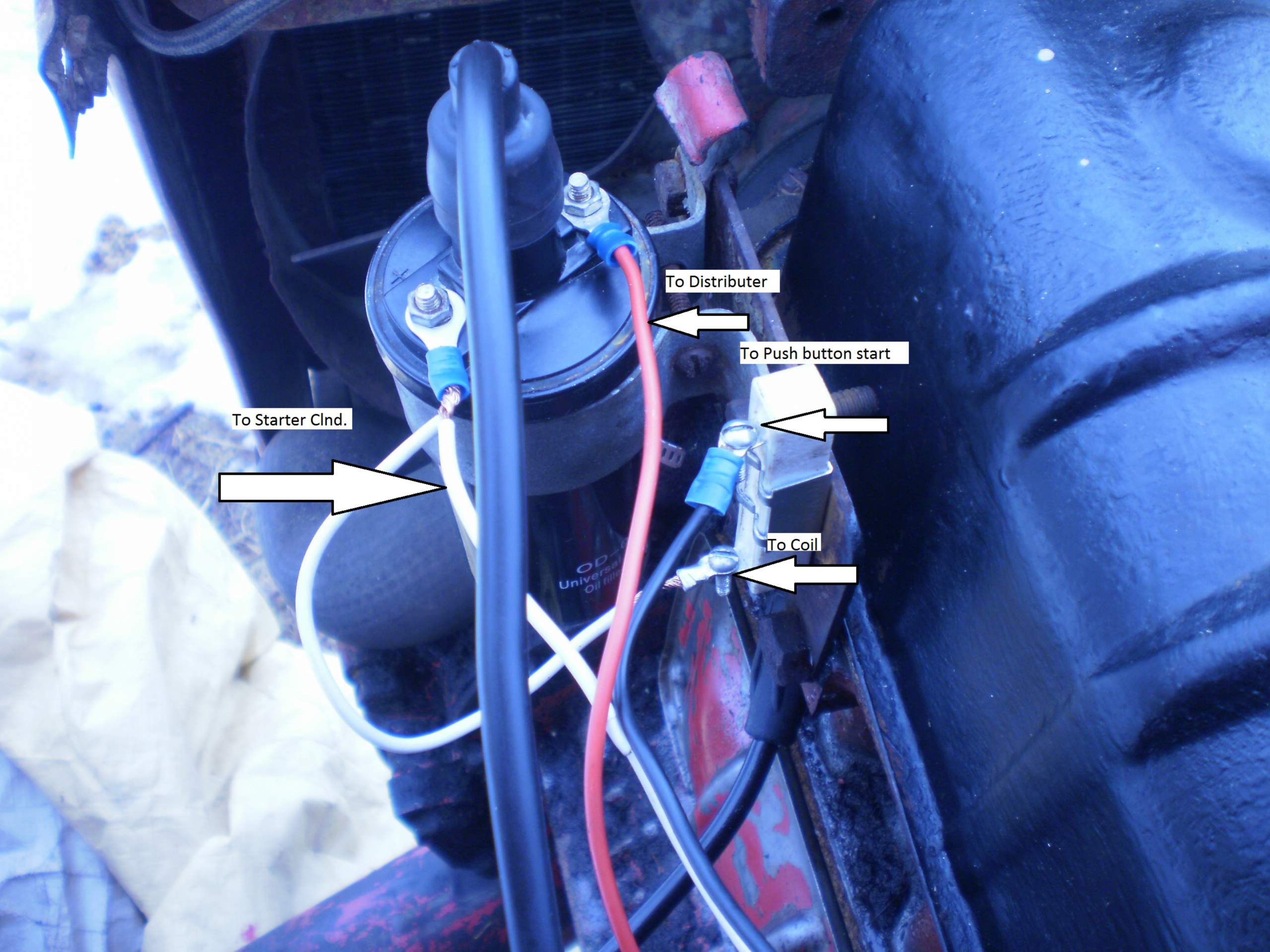

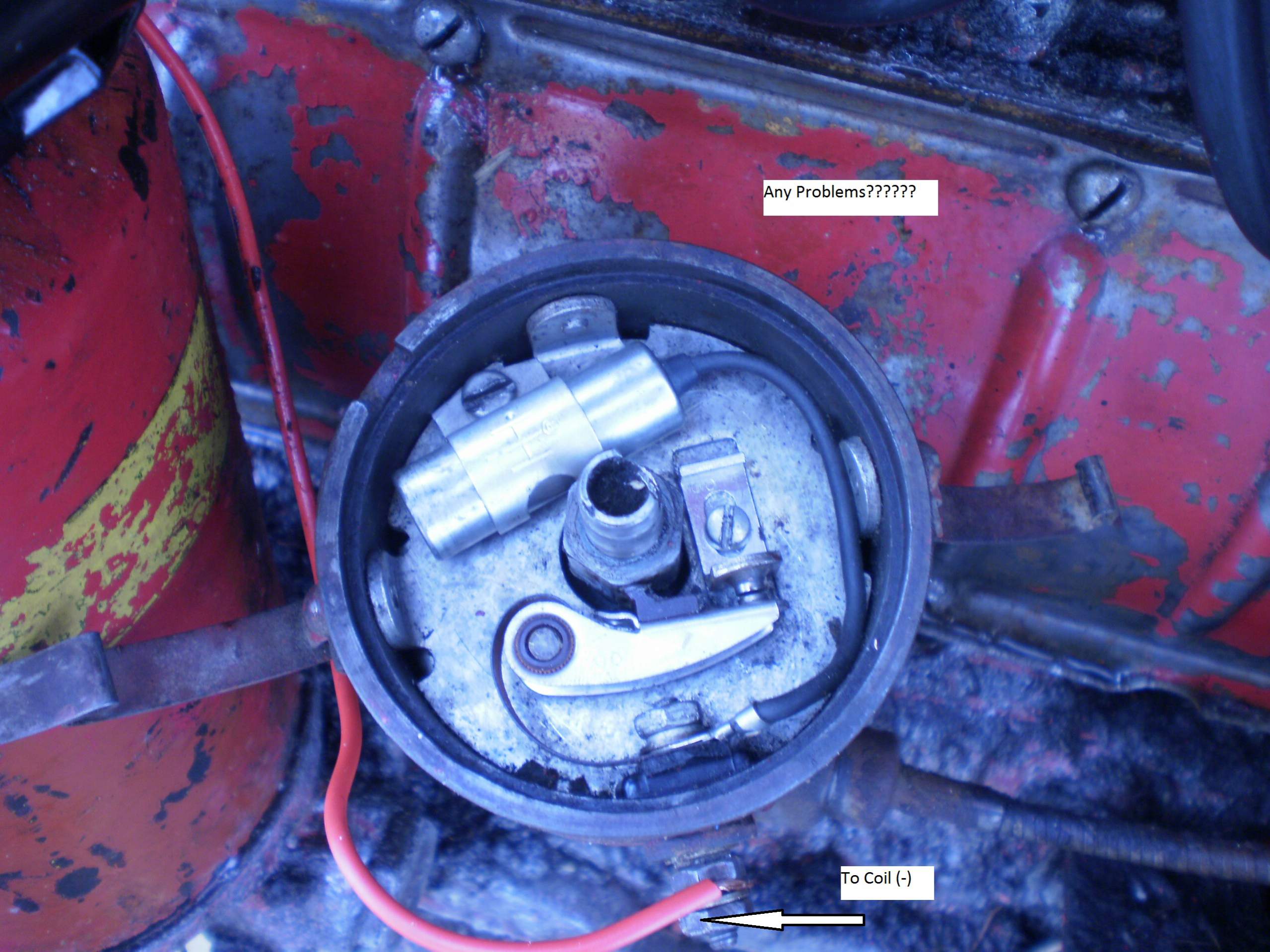

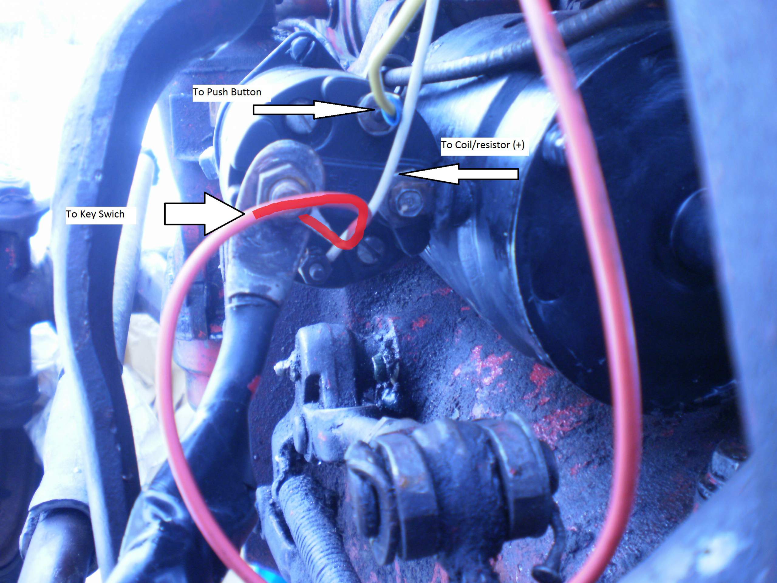

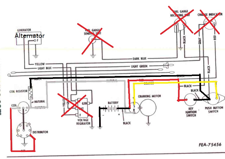

Ok, so tried testing the spark plugs... no go. No spark. I have one idea that doesn't make complete sense, but I though I would check back here before I tried anything.I have the resistor hooked up through the push button switch, so the plugs might not be getting any spark if the button isn't being pushed???? But even still, while I'm pushing it, I don't get a spark either. So I have no idea what it could be. Also, I'll ask again. Do I need the alternator hooked up to make it start? I didn't think so, but I figured I'd ask again.
Here are pictures of anything, if you see anything odd that sticks out, please say so. Please excuse the rough wiring, most of the crampon connections that were there came off because I've been pulling everything off to check for different problems, and trying different things. P1111412.jpgP1111414.jpgP1111416.jpgP1111417.jpgP1111418.jpgUntitled.jpg
Also note the wiring diagram, with what I'm using for wire colors, and what "parts" I don't have.
/ IH 460 wont start #10
Make a Jumper wire with an alligator clip on each end. Remove all wires from the coil + side. Tie them back or tape the ends so they can't touch any thing. Connect the jumper wire between the + terminal of the battery and the + terminal of the coil. Pull the end of the coil wire (thick black wire like spark plug wire) from the center of the distributor and hold it about 1/4 inch from a clean metal surface on the engine. Crank engine and check for a spark that will jump. If no spark you have a problem with your coil or the points & condenser or wiring between them. If it does spark the put coil wire back into center of distributor and repeat spark check at spark plugs. If no spark at plugs then you have a problem with the distributor rotor or cap. If you have spark then put the spark plugs back into engine and try to start. It it does not start then you have either an ignition timing problem or a fuel or compression problem.
Ok, so I tried this while I was outside, and I couldn't see any spark, but by chance I ended up touching the end of the wire while I touched it to metal, and shocked myself. So by curiosity, I brought the battery and the coil down in the basement with the lights off, and I could see spark. Is it supposed to be that weak? And same for the plugs? If so, the plugs might be getting spark.
Another side question... the IH 460 came as a factory 12v system, but when I ordered the new coil it had "universal 6 volt" on the side and of course it came with the resistor. Does the hotwire pass through the resistor first, then go to the coil? Or doesn't it matter at the moment? Because right now, and according to the wiring diagram, it looks like electricity can bypass the resister. I don't know what I'm talking about though:eek:

Soundguy,
Look at the points, they look open to me and the block is between the lobes. It will not spark that way.
I think he needs to back to basics and start over with the simple stuff.
/ IH 460 wont start #18
which is why i told him how to use a test lamp.. and or check voltages. that will tell him if his points are closed/shorted.. or too wide / open.
