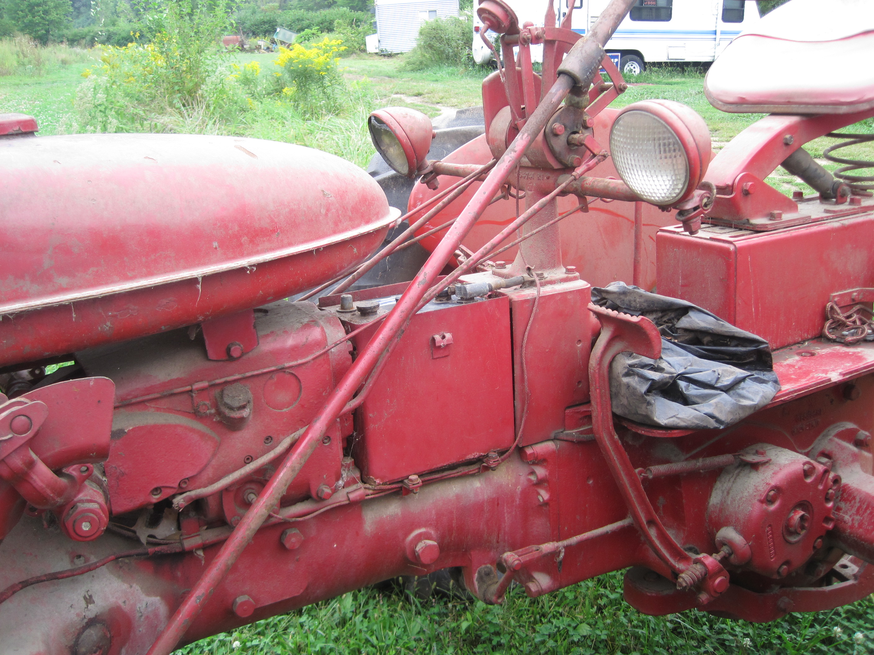

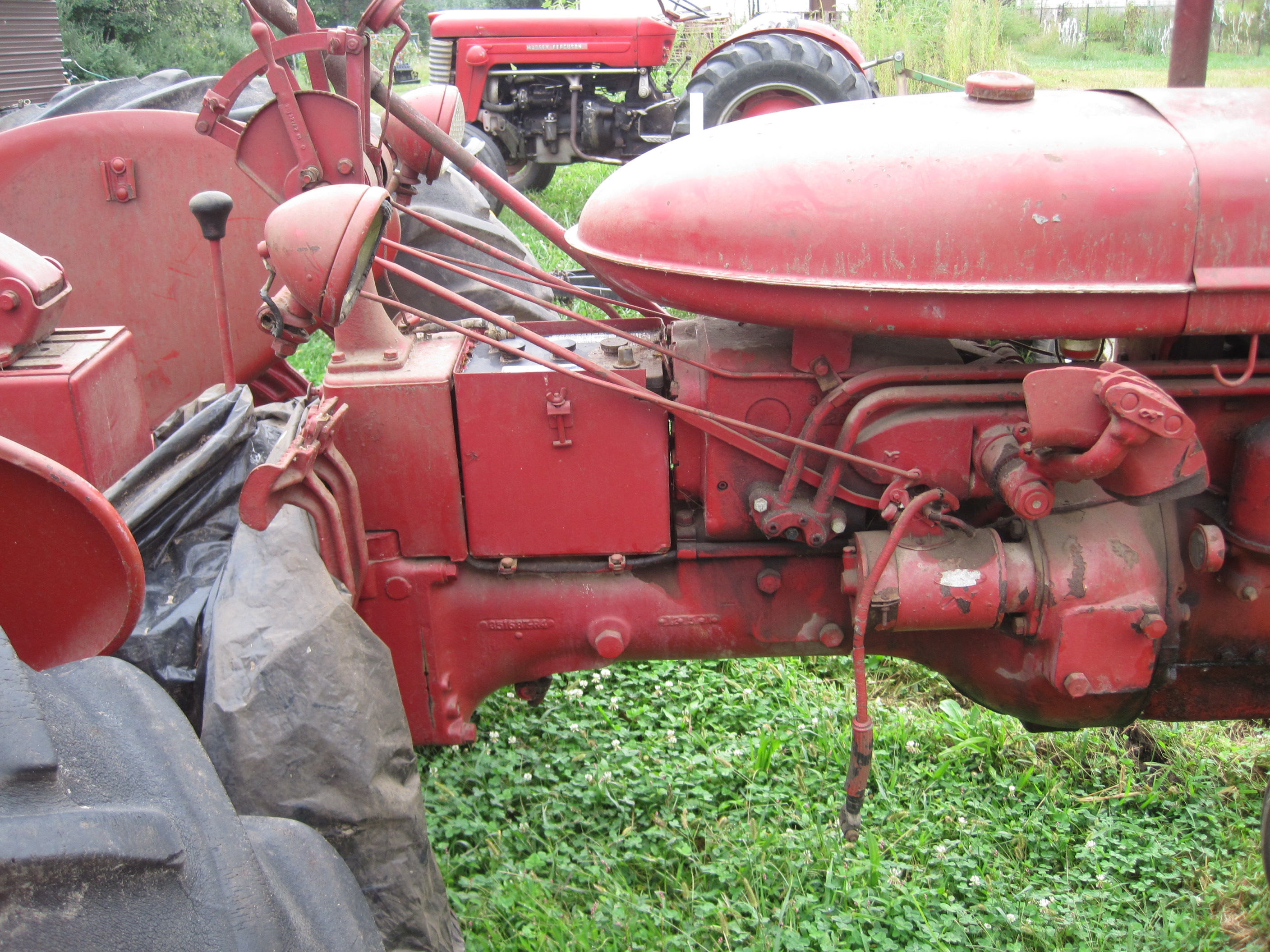

I need to replace the 6 volt battery. I did it about 5 years ago and it was an extreme task because I had to remove the fuel tank and most of fuel lines to the carb.
???Is there a short cut to get the battery out of the battery box..

On the right side, disconnect the starter linkage at the starter end, pull back towards the seat,out of the way. Disconnect the hydraulic linkage by removing the pin in the yoke at the control lever end, and swing it up, and tie it off out of the way. Remove side panel from the battery box, and it will slide right out.
