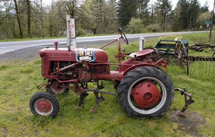

I found a Farmall Cub with a cultivator along side of the road that was for sale. The owner says that it runs and is in good working order. He is not sure what year the tracto is. He wants $1895 for it. That seems a little steep. What would be a good price for this?

Tha is probably an ok price. Ebay is a sorce for relative pricing. Also, YT Mag is a soruce of prices, as well as year/serial number info.
   / IHC Farmall Cub #3
Around here Cubs and "A's" are very popular - most folks want a lot more than that for a good running copy.
Bear in mind the Cub engine is not as easily rebuilt as the larger IH/Farmalls (no separate sleeves) so I'd pay especially close attention to compressoin readings, oil smoke and the like - and ask the seller if it's already been rebored oversize.
   / IHC Farmall Cub #4
If it does indeed run good.. that's a good price.
I paid 2495 for a good runner that had hyds, a belly mower, and front blade.. decent tires and paint.. was a 66 model, 12v genny from the factory, and distribuitor ignition.
There will be a tag on the steering pedestal that has the sn.. with that you can 'date' it.
Areas of concern ar the steering box.. it can crack.. and leak.. not much to do but weld or braze then fill with grease, unless you want to replace the casting.
Check the play inthe steering, check the oil in the final drives..the cork gaskets usually get dry and leak.
Check engine.. make sure it has enough power to do what you want.. they only had about 9-14 hp from the factory anyway. Might have an original cub IH carb.. or could have a A or 154/184 replacement zenith carb. Repar kits for the carbs ARE available
Check the hyds.. if it has them.. they are pretty bullet proof though as it is more or less a self contained unit.
Also.. check for radiator leaks.. the radiator is a funny job.. cast pedistal and thent he core fits in it...
