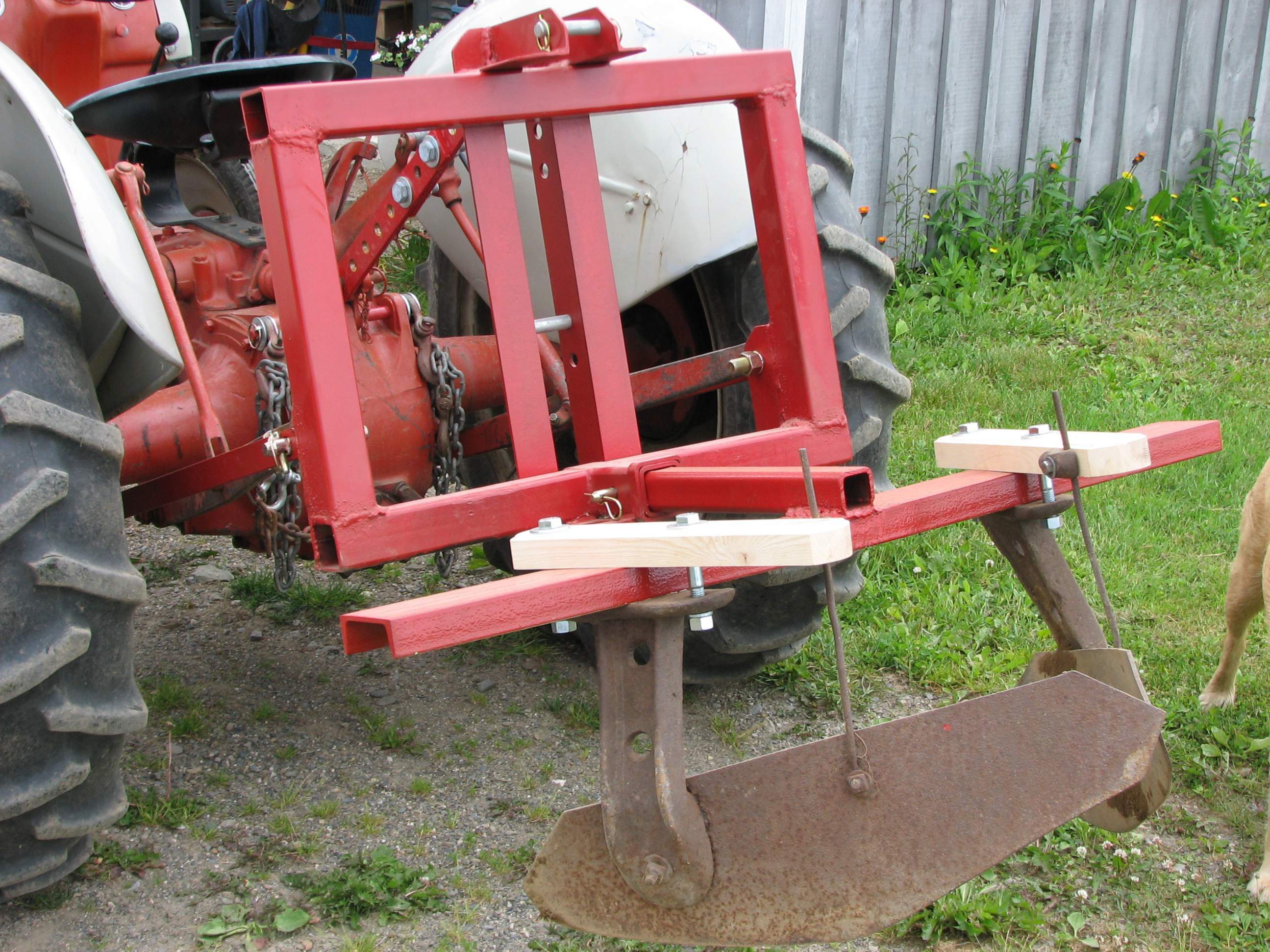

Here are a couple I built. Both work great for creating beds or rows & for hilling up potatoes.
   / I'm building a garden Better... #13
Ken, are the surfaces on your second one, just straight and flat, tilted inward a bit? Can't really tell from your picture.
   / I'm building a garden Better... #14
Hoe/hiller on the Ford 8N is actually the metal parts from an old horse drawn unit that I found at a local dump site & kinda recycled. The actual hoes are curved inwards. On the other one, I used extra discs from an old ferguson disc cultivator & welded up the rest. Both units connect to the 3 point via a Class III hitch receiver incorporated into a trailer mover/log skidder I welded up.
