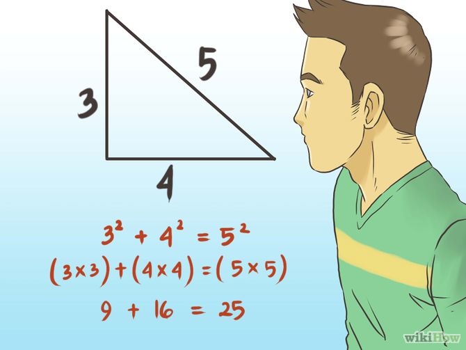

I sort of skimmed through the replies, so I might be repeating what others have said. Since you already have your first post set, and I see that you have run the other two for one of your walls, the 345 rule will get you where you need to be fore the back wall. If you look on a framing square, it has this stamped into it, along with a few other handy rules. How far back will the wall be? 6 8 and 10 feet are what I use most of the time for smaller areas. If one of the walls is one of those length, then it become super easy to figure out where to set the post. I have a lot of measuring tapes, so I just set three of them out to get it all lined up. You can also mark a board at 6 feet and 8 feet, then use your tape for ten feet. Once you get your corner set, double check all your other posts to make sure you are parallel.
For bigger structures, measuring from opposite corners is faster and easier. I use two long hundred foot tapes for this. I set the ends of each into the ground with a screw driver and create a large X. When both distances are the same, you have a perfect square.

Now I'm aggravated. I've been out measuring for the rear posts and I can't get anything to square up. I felt good about the front posts and I have to pull off of those as they are set. I square the corners and when I pull my 16' length across the back I'm like the width of a whole 6x6 off. I don't know where I'm going wrong. Something got off somewhere and I can't find it. I'm thinking of just squaring the two outer rear corners the best I can and pulling off the front posts 12' to get my depth. Its frustrating because the front went pretty smooth.

How are you attempting to square it up?
With only referencing the front two outer posts, you cant have done anything wrong yet, as long as those are 16' apart.
It might take two tape measures and a second set of hands, but measure the diagonal, and the side. where the numbers meet up is your mark.
IE: If the side is 12' outside to outside of post, hook one tape on the corner post and measure out 12'.
If the long side is 16' outside to outside, have a helper hold a tape on the INSIDE corner of the other front post.
Now here is where it gets trickey, the diagonal measure of 12' x 16' should be 20' as we all know. But you have to subtract the diagonal of the post thickness since you are holding it to the inside corner. Which I like doing because otherwise you are "wrapping" the tape around the post to get to the outside, or just eyeballing it. so a 6x6 post is really ~5.5x5.5, and the diagonal would be 7-3/4". So take that off of 20 and you have 232-1/4".
So, with the two tapes at each of the front two posts, when 12' meets 232-1/4", THAT would be the OUTSIDE point of the back 6x6. Do the same for the other side and confirm the 16'.
Now it the building isnt exactaly 12x16, say you made it a little smaller to allow for siding or whatever, just adjust accordingly.
And this "can" be done with one person as well with some string. Tie a string around each front posts and make pre-measured marks at the 12' and 232-1/4" marks. Pull strings tight and where the marks meet is your corner.
