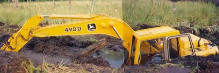

Just don't do this with your rental...:D
