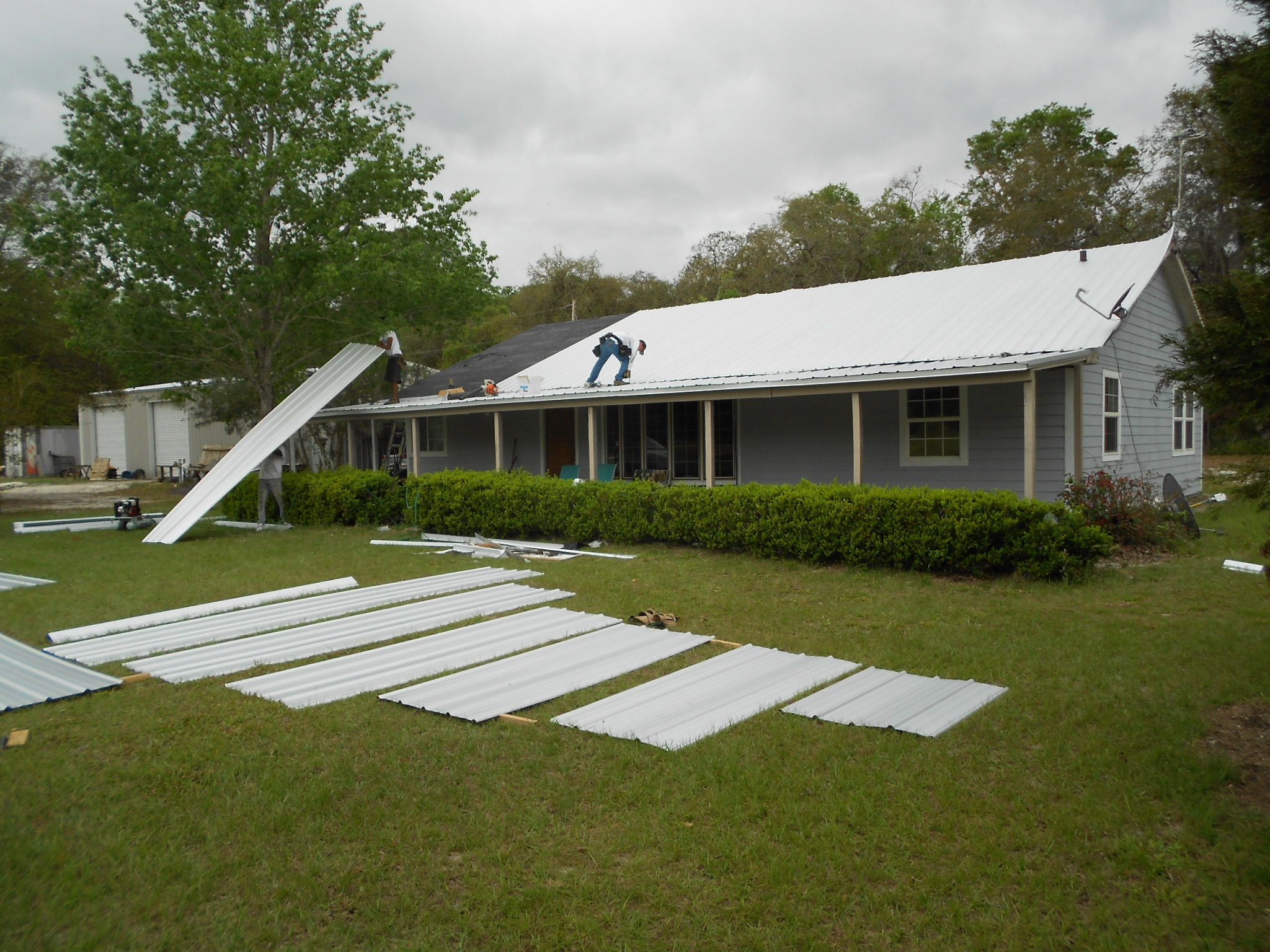

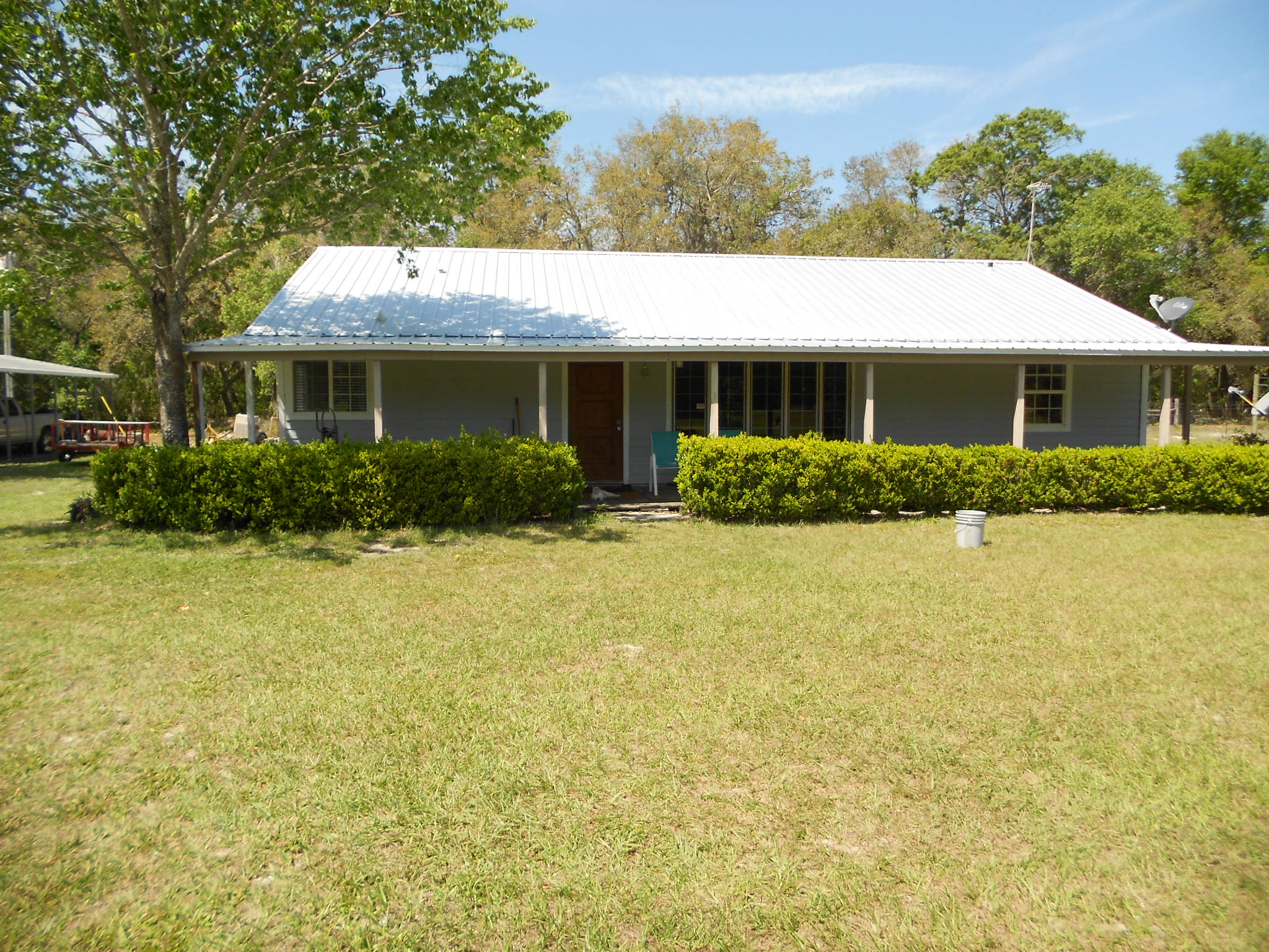

I had a new metal roof installed last spring.
I got 4 estimates and found a local guy with his own metal machine that he said he had to get certified to legally install panels.
He showed me the machine and the work area was very clean, machine had computer controls, set length, push button and it rolled out the panel, cut it and dropped it on the collection table where they picked with forklift to staging area.
My home took 38 squares and needed some roof deck repair to plywood.
Estimate included, deck repairs, new evedrip, ridge cap and stack flashing. Under $10,000.
Old roof only had minor leaks at bad decking so we agreed to repair and leave the one layer and cover it with synthetic felt. (legal here)
They predrilled the panels on the ribs (roofer said engineers recommended) and 3 guys installed in a couple days.
It has a 25 year warranty on the metal.
It took 5 weeks for him to get to my roof, he is busy.
Try to find someone with their own machine, he was $2-3000. cheaper than the other estimates.
He even sells wholesale to local supply stores.
Color is called "Galvalume" and house was cooled this summer!
