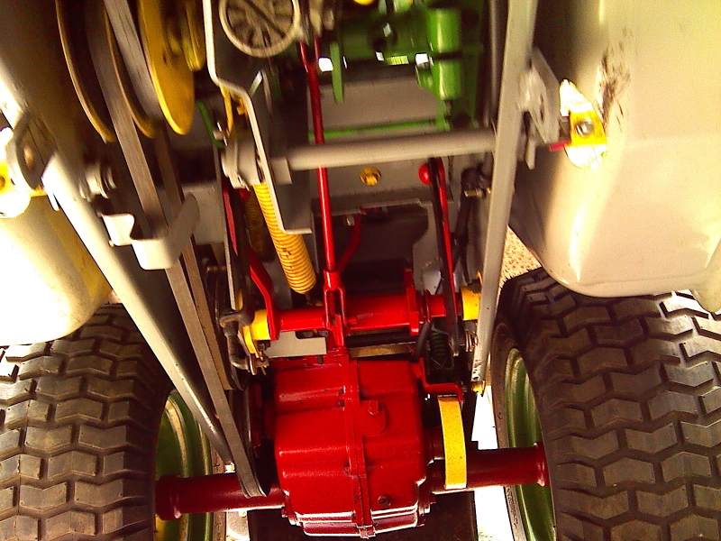

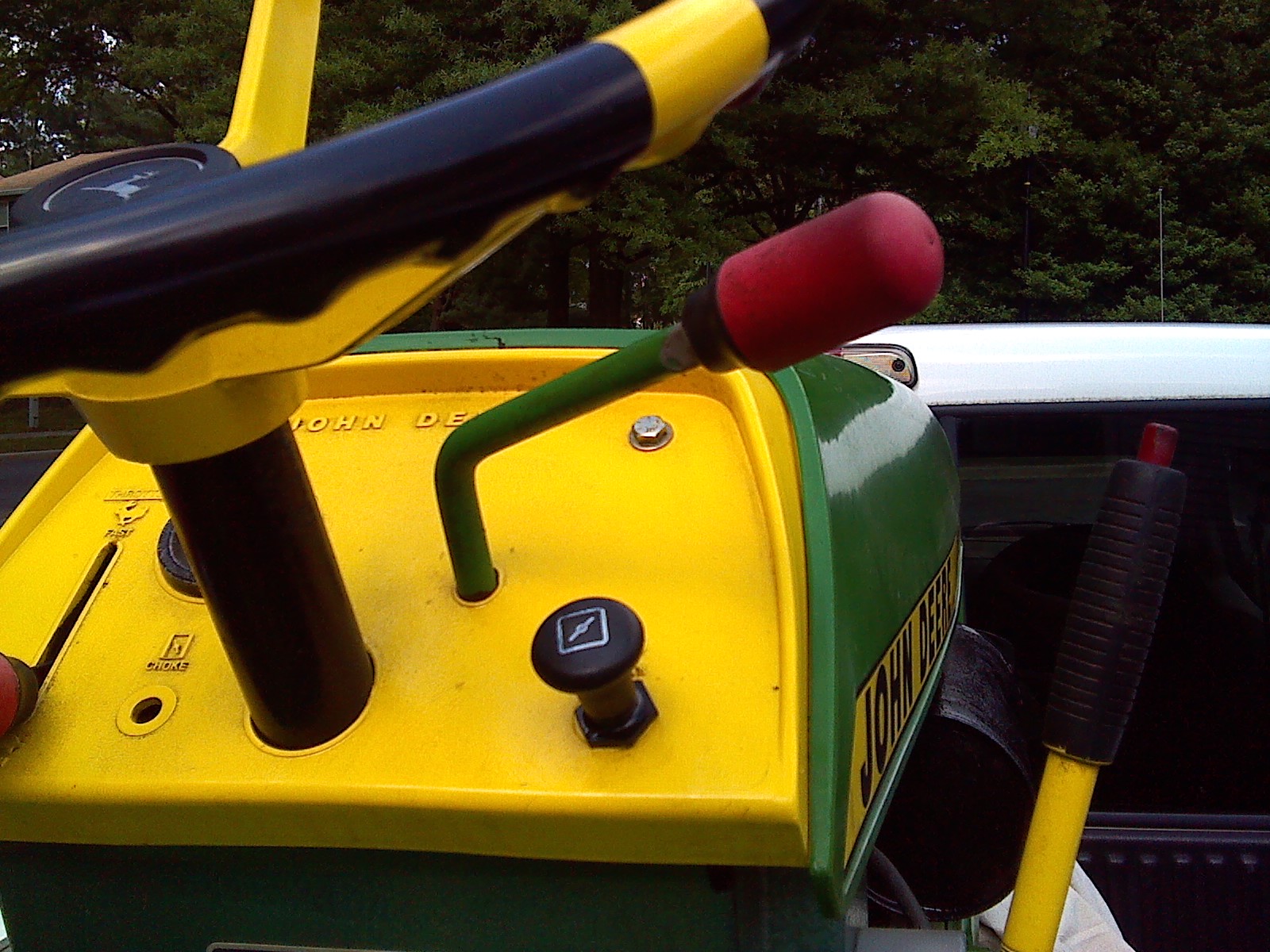

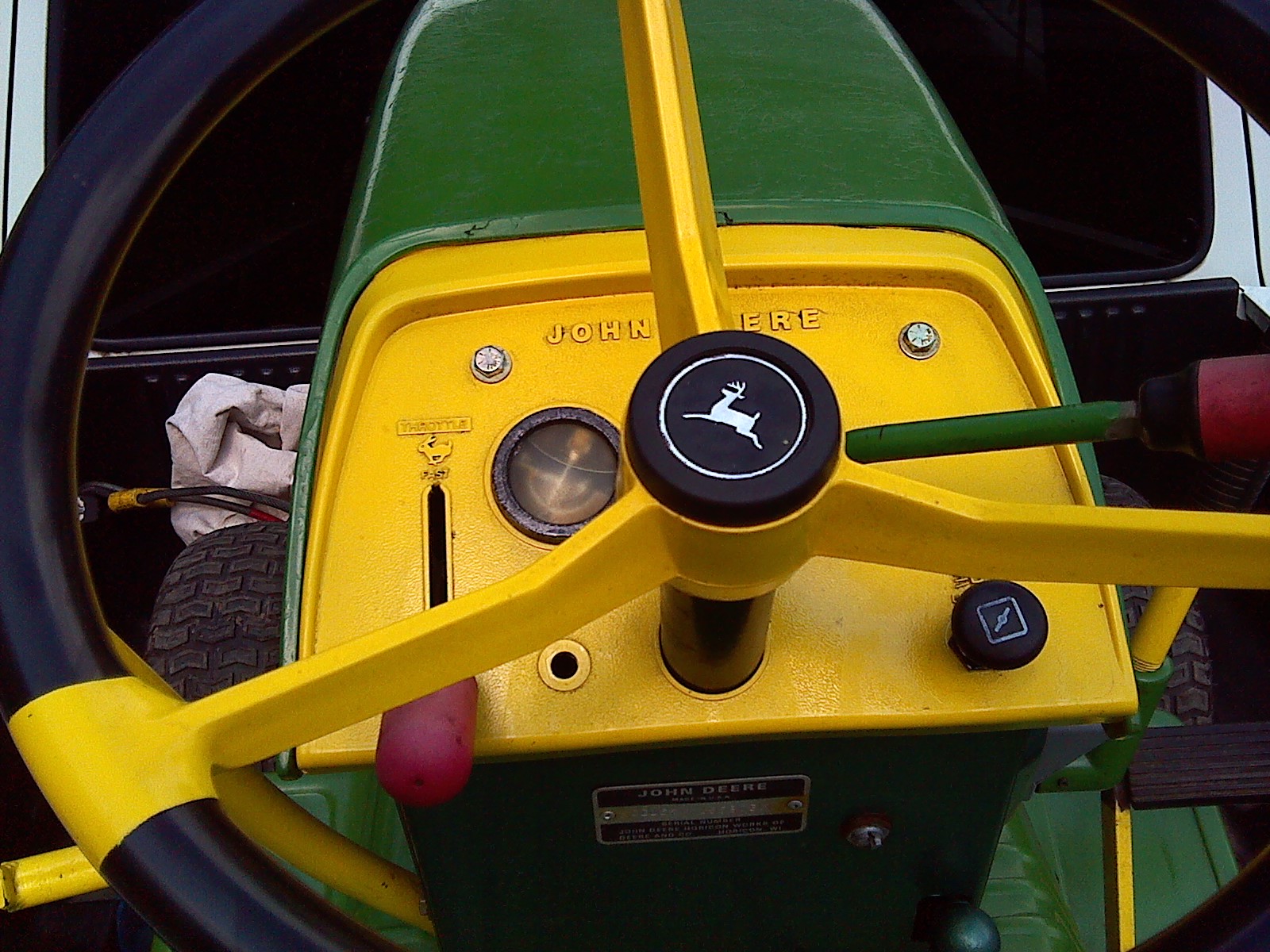

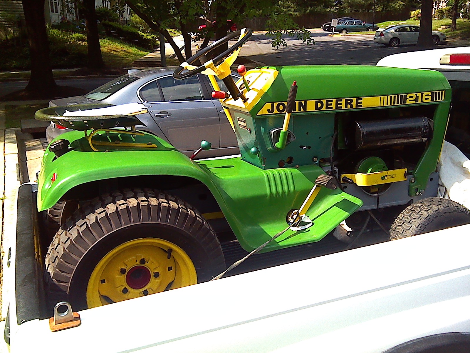

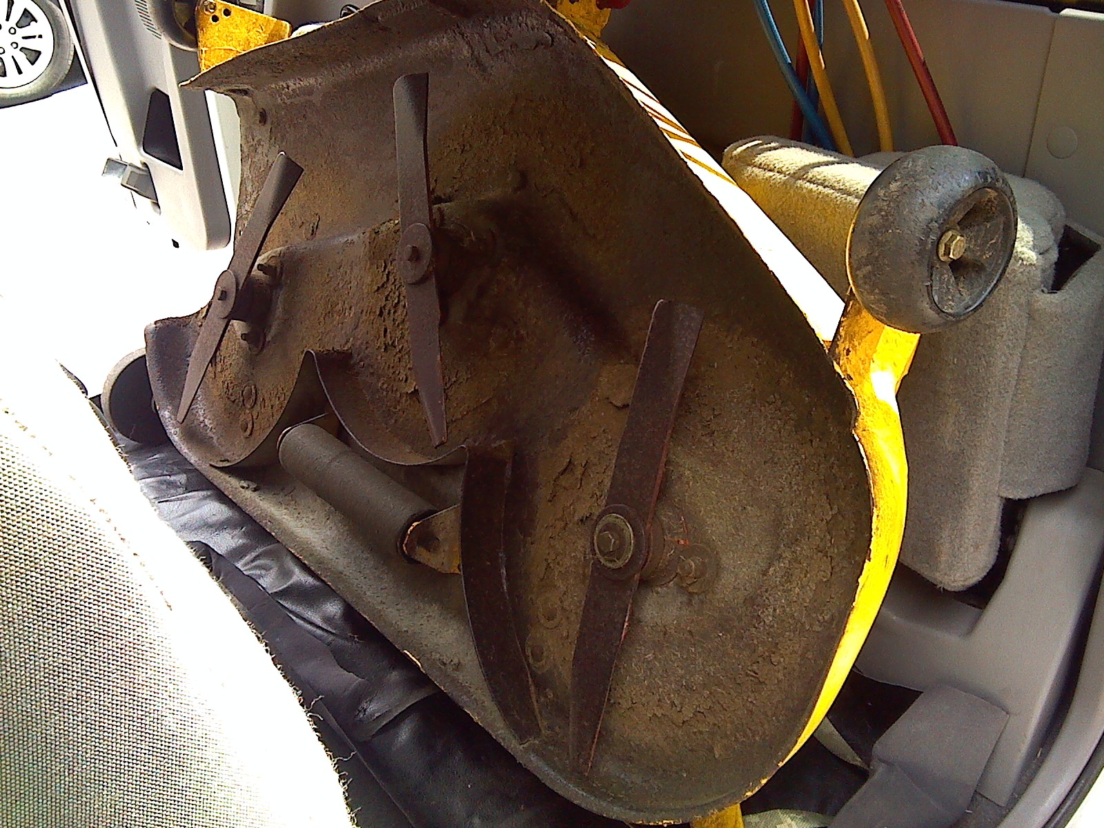

I pick up the John Deere 216 runs good the tires all 4 look new and new starter.. Question 1 how do I install the deck and drive belt. Deck Ser - H047K-4578168M has 3 blades. No amp gauge not wired or broke. The light switch is where the choke is for the carb. No lights. Is the 216 4 speed with a revers. Can any 1 tell me what are the little ball levers blue in color and the blue red handle. Witch side is the brake pedal. And what is the other pedal for. "O" there's about 3" of play when i turn the front wheels is this a easy fix. "O" the tractor ser - C or 0 216K-155803N
View attachment 428835 View attachment 428836 View attachment 428837View attachment 428833 View attachment 428838 View attachment 428839
I think the pedal on the left is the clutch and the one on the right is the brake. Just like a car almost.
The play in the steering might be a problem in the steering column gears. I had a 110 a little older than that on with the same problem. I never fixed it because it looked expensive and hard to fix, and it was a pain to drive because I was always correcting the steering.

Steering problem seems fix now. I loosen the nut on on the gear box and turn the notch screw in and re-grease it. working find now.
