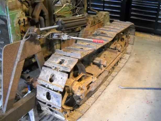

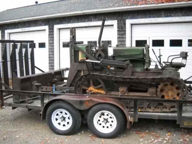

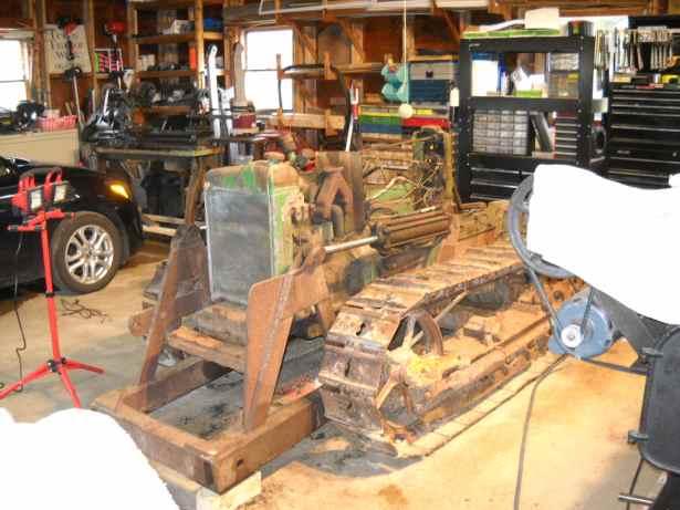

A little progress on the teardown.
Pulled the blade off before pushing it into the garage. Lot of weight and opportunities to whack my shins.
Got the grille guard and nose cone off.
Got the belly pans off.
Drained the oil (ewwwwww...) and put a fresh filter in the canister.
Replaced the plugs, points and condenser on general principles and fixed the points adjuster screw as the slot was hogged out to the point you couldn't turn it with a screwdriver. It's brass, so soldered the slot shut and cut a new one at 90 degrees to the original. Remounted the coil that was hanging by it's wires and cleaned up the wiring for the distributor, coil and generator.
Got the carb, sediment bowl and fuel tank off. Sediment bowl was full of dried varnish, screen completely plugged, line to carb completely plugged. Carb wasn't as bad as I feared, but the throttle butterfly was stuck wide open, top-to-bowl gasket dry and crumbly and the rubber tip on the fuel inlet needle had fallen off. Got a carb kit on order (ouch...). Tank has quite a lot of dried varnish in the sump around the outlet, I'll plug that and let it soak in some gasahol for a while. One advantage to gasahol is that it makes a pretty good solvent.

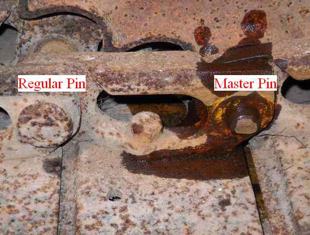

Next job is to drop the tracks. Put the crawler up on jackstands with the tracks just barely clearing the floor and pulled them around so the master pin is in a convenient location. I need to build a jig so I can use a bottle jack to press them out. Plan to start on that tomorrow.

After a couple of days of trying different methods and modifying my pin pushing jig as I discovered shortcomings, I finally got the master pins out and the tracks off.
Details and more pix here.
