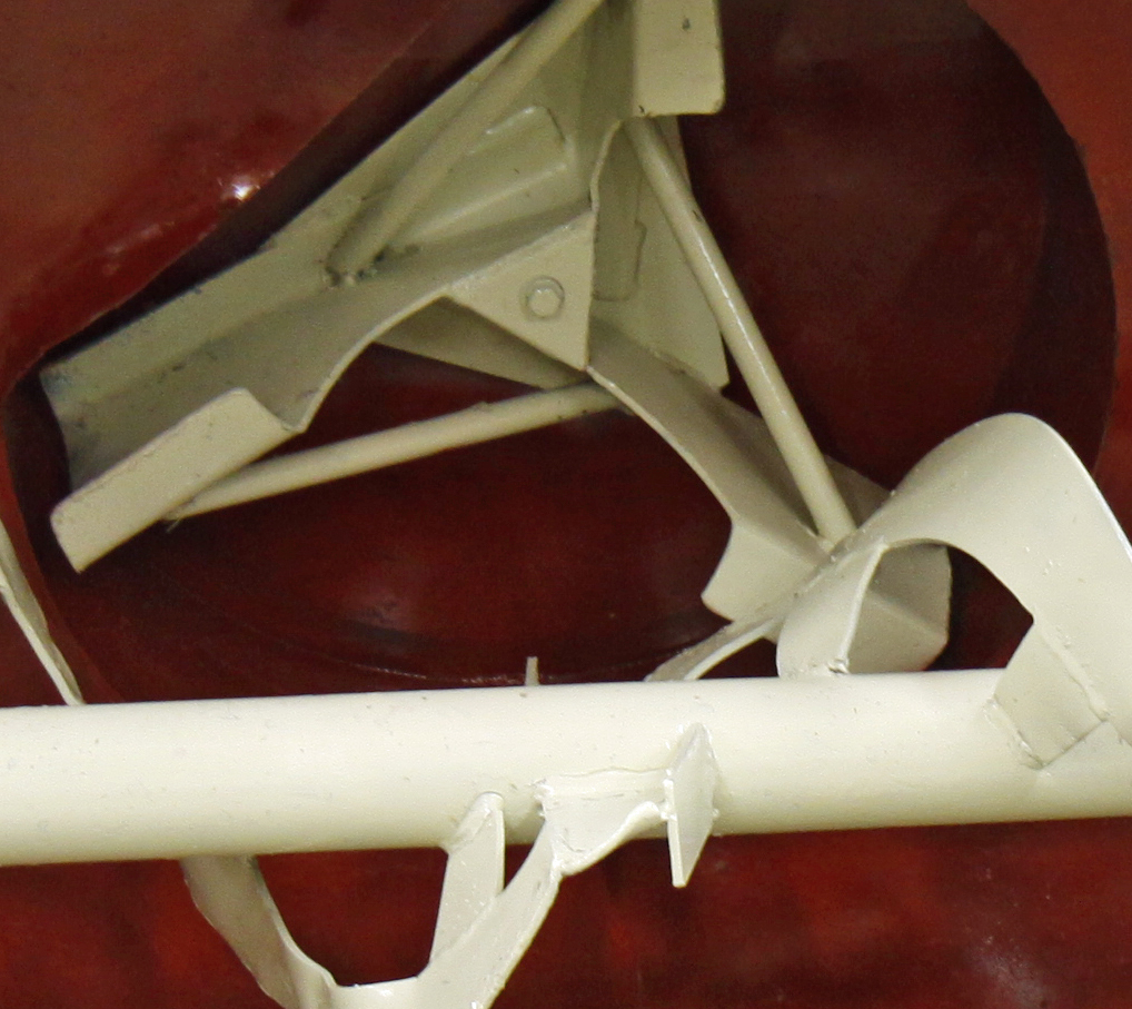

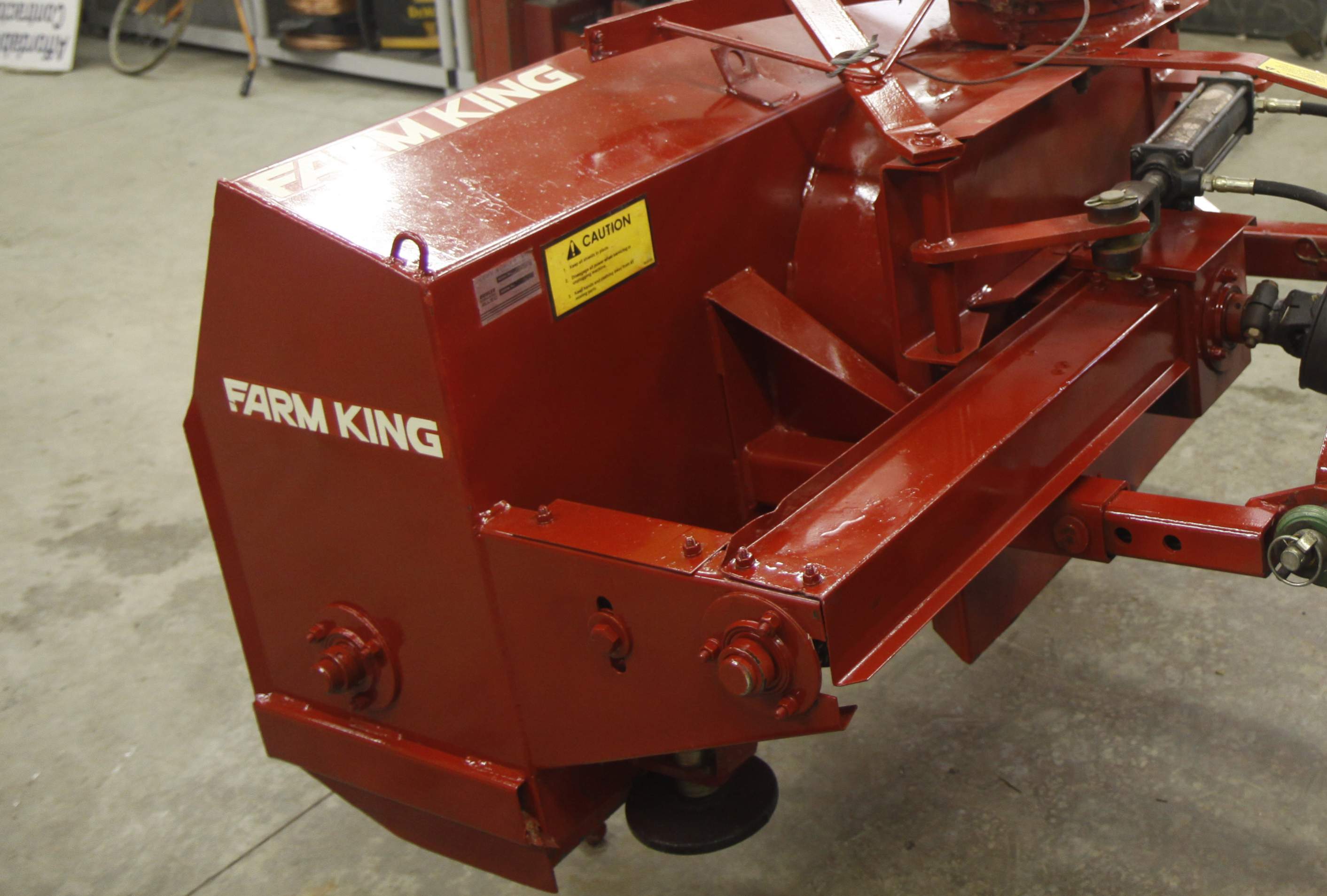

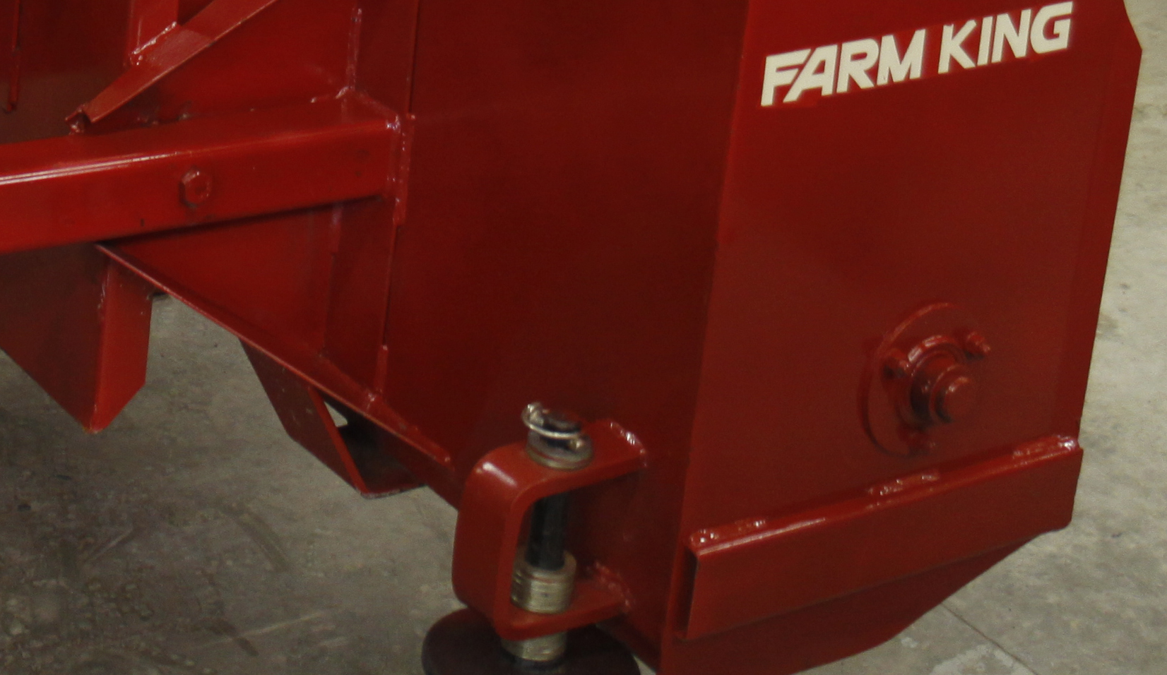

on my old farmking blower, i installed weld on case hardened adjustable shoes inplace of the factory drag steel. They looked good after 8 years of hard use. I got mine at JD dealership for about $25/each way back when.
i also had to add bracing on the interior 3 rotator blades and wedges on my main auger cause they just kept bending. i got tired of straightening them out. skid.jpgskid shoe 1.jpgrepairs.jpg

Wow, that's a beauty, I like it a lot.

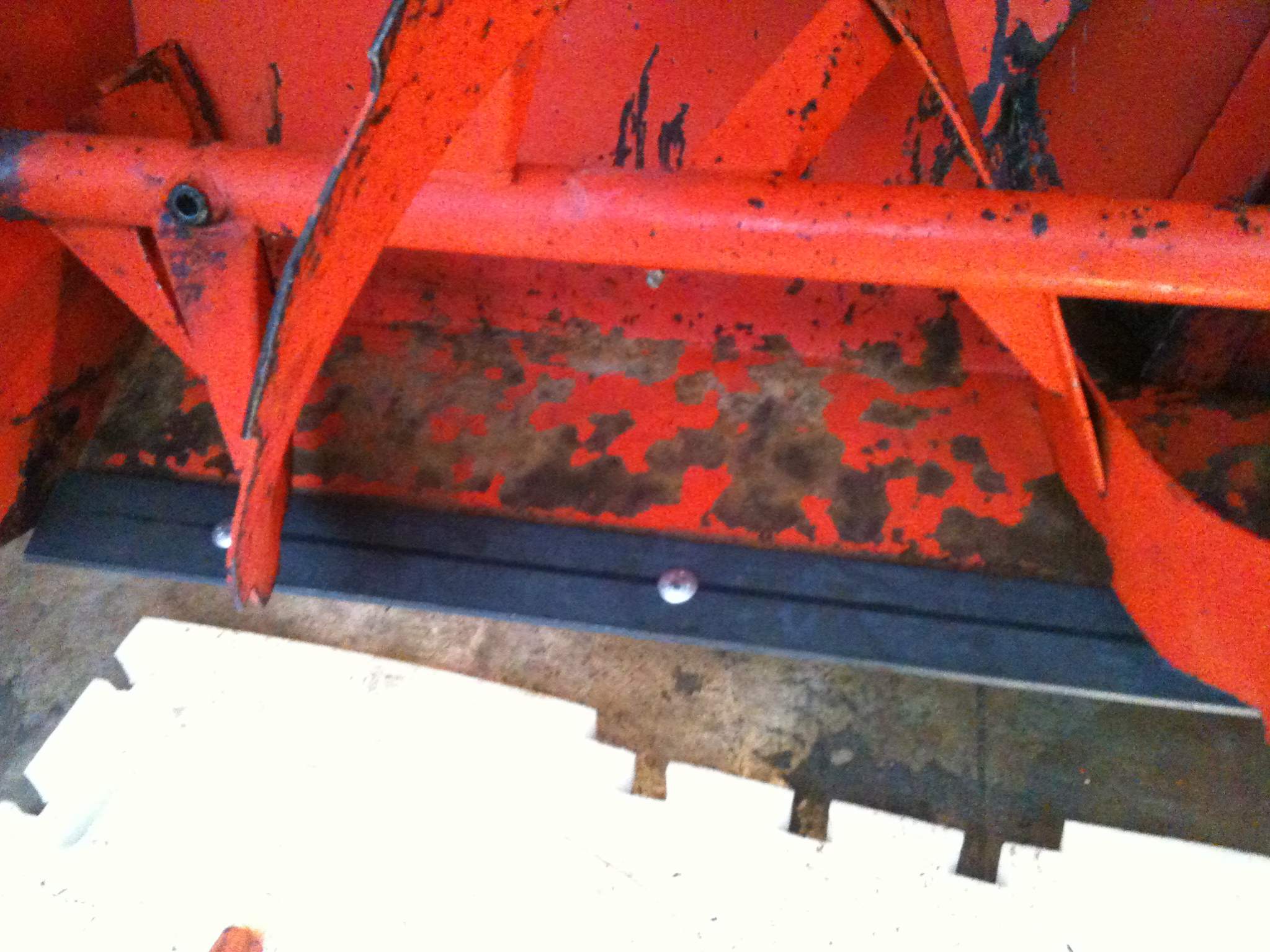

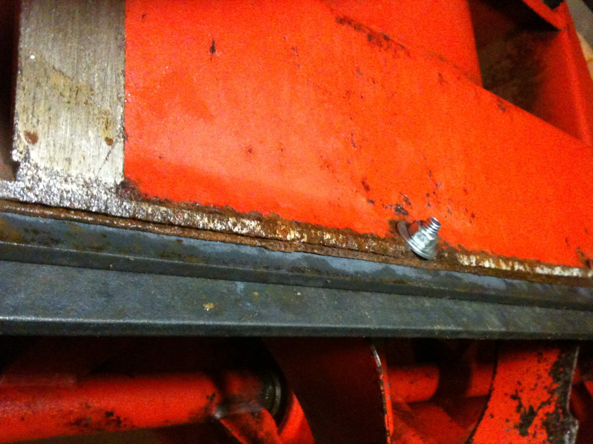

Some progress.
Bought 2 pcs of stock steel bar 1/4 X 2" X 5 FT
Couple pictures.

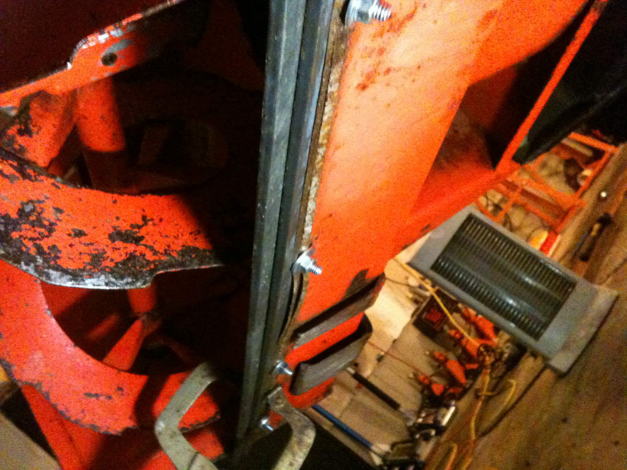

Next.
Drill holes and attach the second steel bar. Using this as a cutting edge.
Remove the blower off the tractor so my friend can do some welding on the bottom.
BTW, I bought a cheapo HF 70 AMP Arc welder. Can't wait to see if it works.
Retro-fitting the skids.
